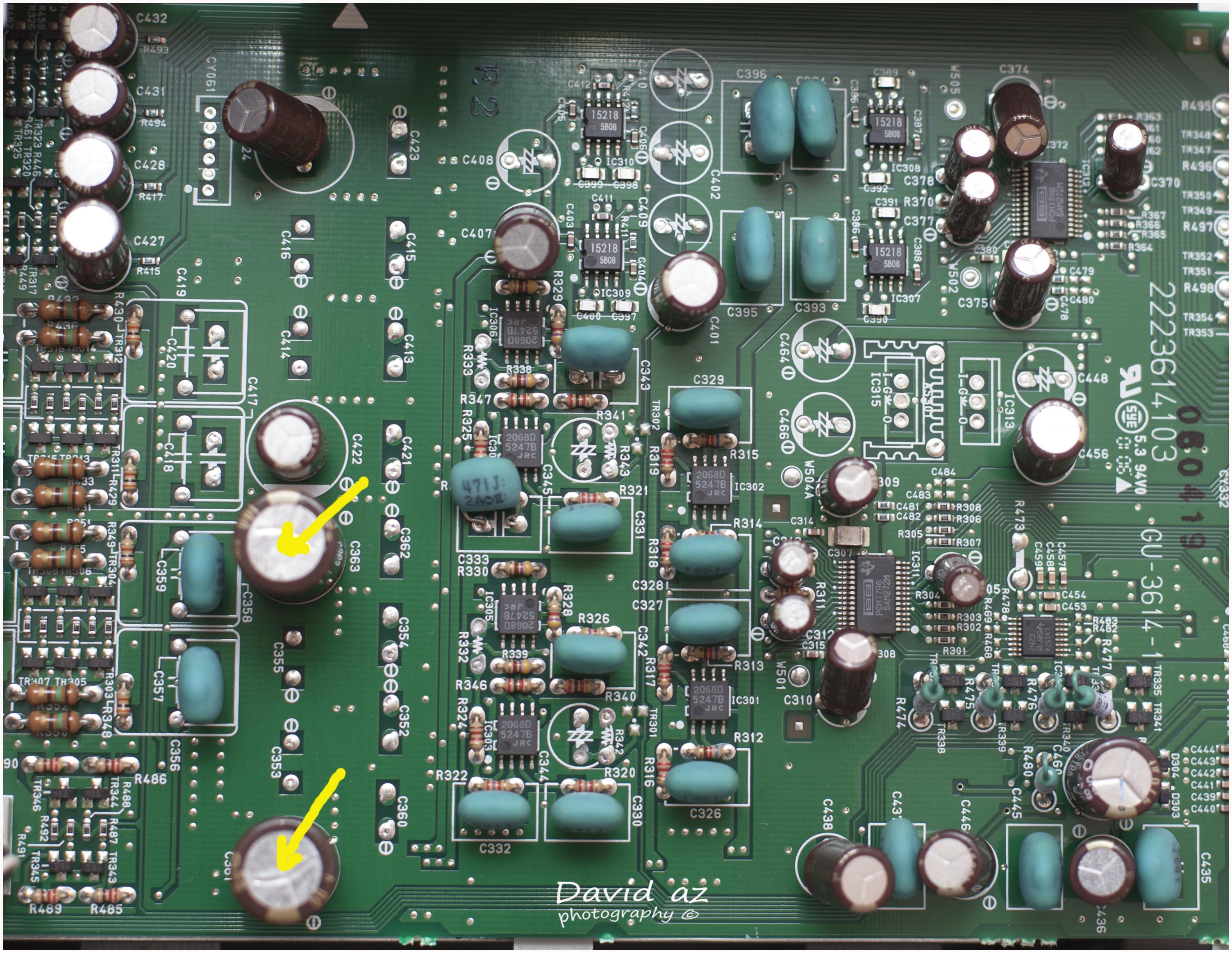

I only changed to the LM4562 in a couple of PC soundcard and the sound came out clearer.
I changed all the regulators in the PSU (DVD3910),but I´m not sure about the outcome..(soundwise).

I ordered the OP AMP LM4562
There is something a recommendation on the types of capacitors and whether to change their values because of a change of PO AMP 4562
From 2068D?
From 2068D?
That "cap" is maid up of 5 singled caps you would have to use this formula to calculate the new value f=1/(6,28xRxC) (where R is 30k) of a single cap.

Capacitors 1 worth 5
Can you give me new values of the capacitors if I replace

after change the op amp from 2068d to lm4562
And can give me the variable changes he made after replacing the OP AMP
Companies capacitors ?
What must change and what can'll stay ?

If you use a "plastic" cap with the value of 4.7uF you get the -3db point of 11hz.
It all depends on how much you are willing to pay for 2 caps.

You mean two capacitors in AUTPUT STAG Large capacitors electrolyteIf you use a "plastic" cap with the value of 4.7uF you get the -3db point of 11hz.

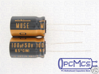

Can I replace the electrolyte capacitors 100uf-50v in the audio unit circuit
weth
NICHICON muse-kz series 100uf 50v
They are not expensive and I've heard they are good
What do you think ????
And it says 1000 hours
It seems a little odd

Yes its the 2 brown elyts,and yes you can use muse-kz,but I would wrather use sommething like this maybe 10uF Mundorf Film Caps EVO - Aluminum + Oil
100uf is cost 80 $Yes its the 2 brown elyts,and yes you can use muse-kz,but I would wrather use sommething like this maybe 10uF Mundorf Film Caps EVO - Aluminum + Oil
160$ for 2 cop Expensive
Why did you write 10UF ?
Now that the device capacitors
c 363
c 361
CE04W1H101MT(ASF)
100uf ?
this the capacitor I think I will buyWell you can use 100uF e-lyts if you like.

Because the 100Uf is oversised,you relay don´t need more than 10uF to get an -3db under 10Hz.Why did you write 10UF ?
And Mundorf Film Caps EVO - Aluminum + Oil
is of a better quality than an e-lyt,but a little more expensive.
But its up to you.
You decide.🙂
