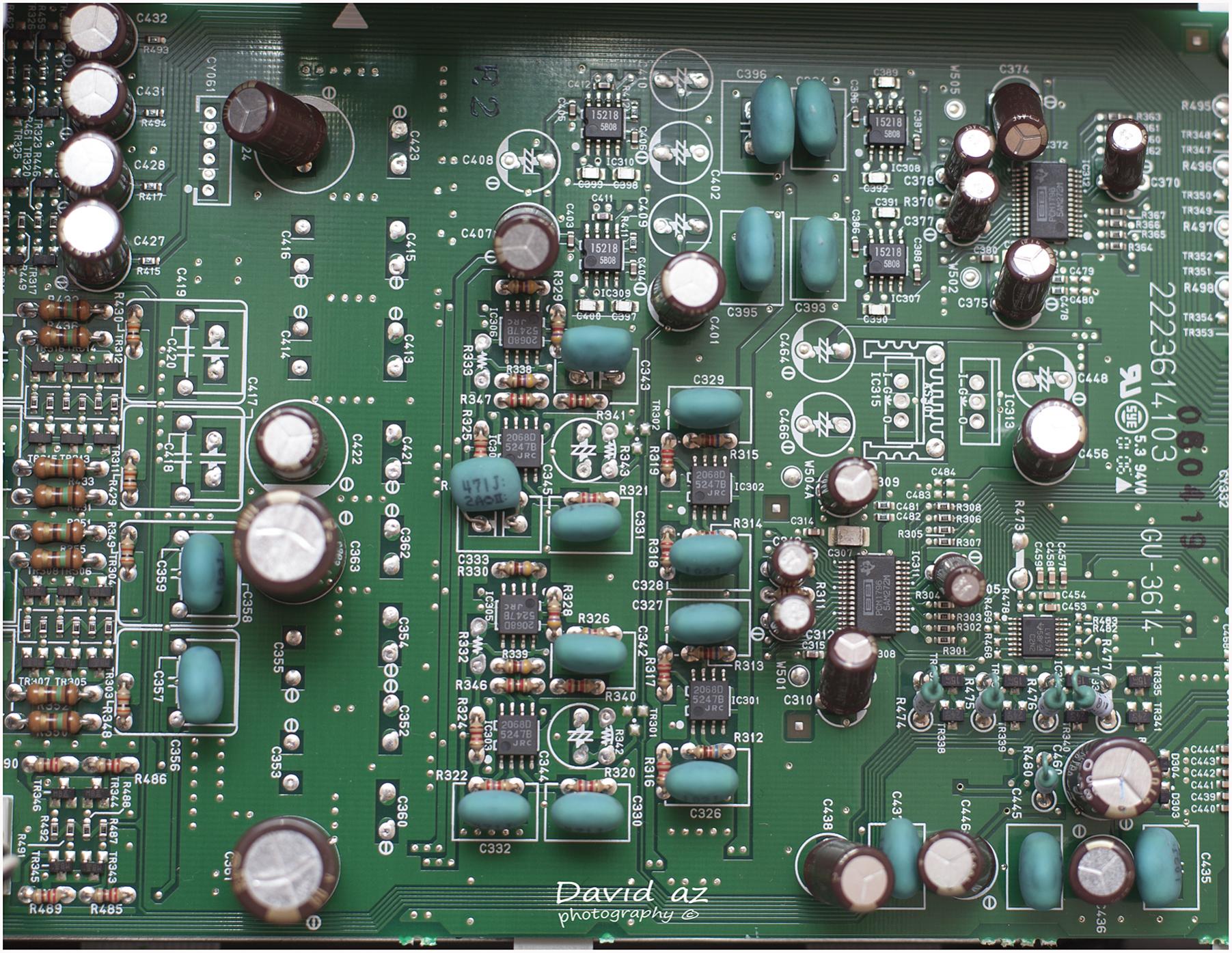

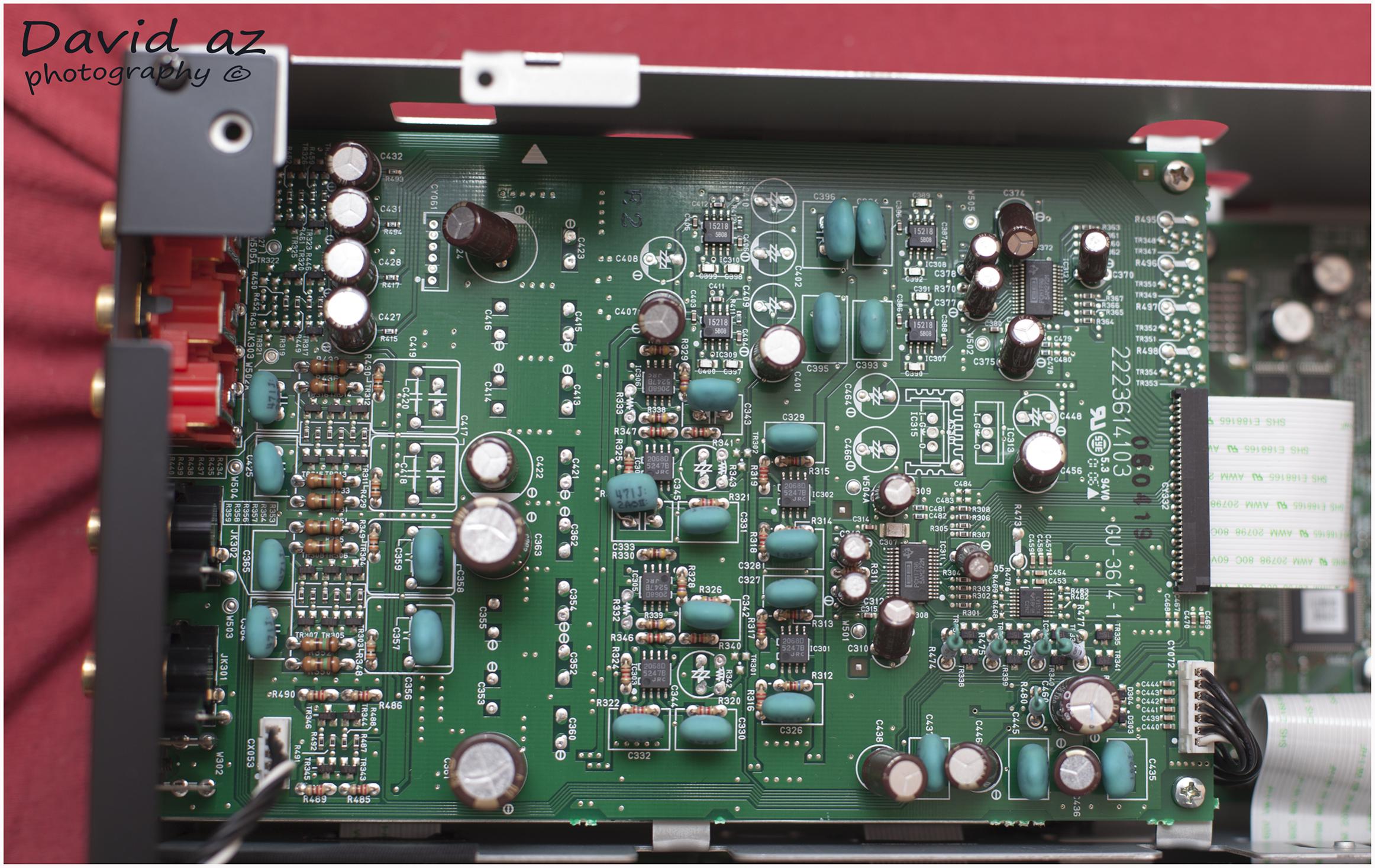

The main system unit also contains the audio circuitry for the centre, subwoofer
and surround channels, based on two Texas Instruments/Burr Brown PCM1796 chips (each chip operating in stereo or dual channel mode), eight 2068D op amp chips plus an assortment of fairly high quality capacitors. I also noticed two oscillators, operating at 24.576MHz and 18.75MHz.
On top of this board, completely enclosed by metal shielding to protect the audio circuits, is a separate board for the FireWire interface. The design is based on a Bridgeco L5A9625 processor and is separately clocked using 22.579MHz and 24.576MHz oscillators.
The third board stacked topmost is a dedicated board for the audio front left/right channels. Here we find another two PCM1796 plus no less than ten 2068D op amps and accompanying capacitors. The Denon literature implies that one PCM1796 is used for the dedicated stereo left/right outputs (containing a downmixed signal for multi-channel sources) and the other is used for the front left/right channels forming part of the analogue 5.1 outputs.

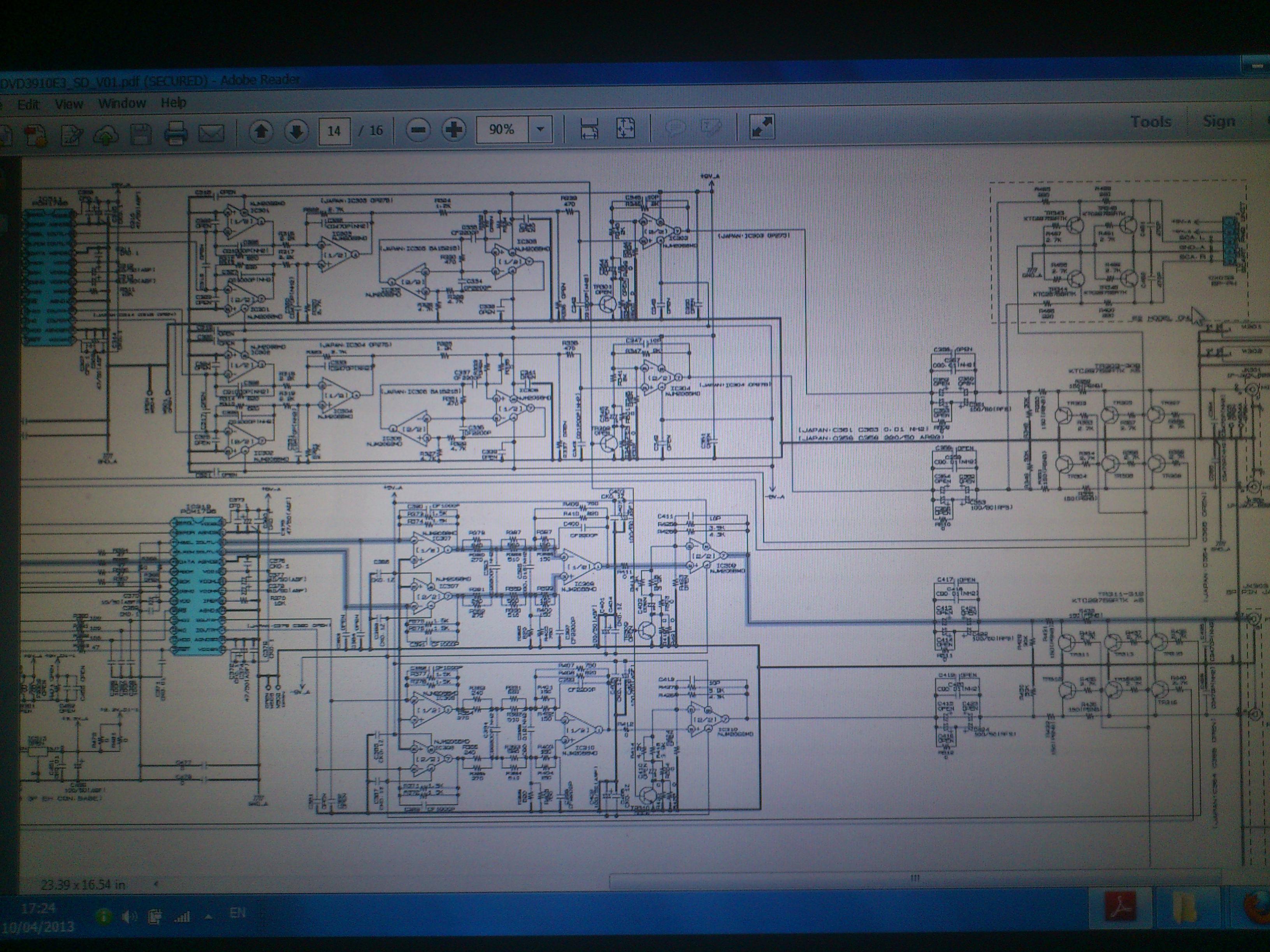

In 3910 my brother has a total of 18 2068D OPAMP
on different audio circuit 10 on Sketch 14 and 8 mor on Sketch 7

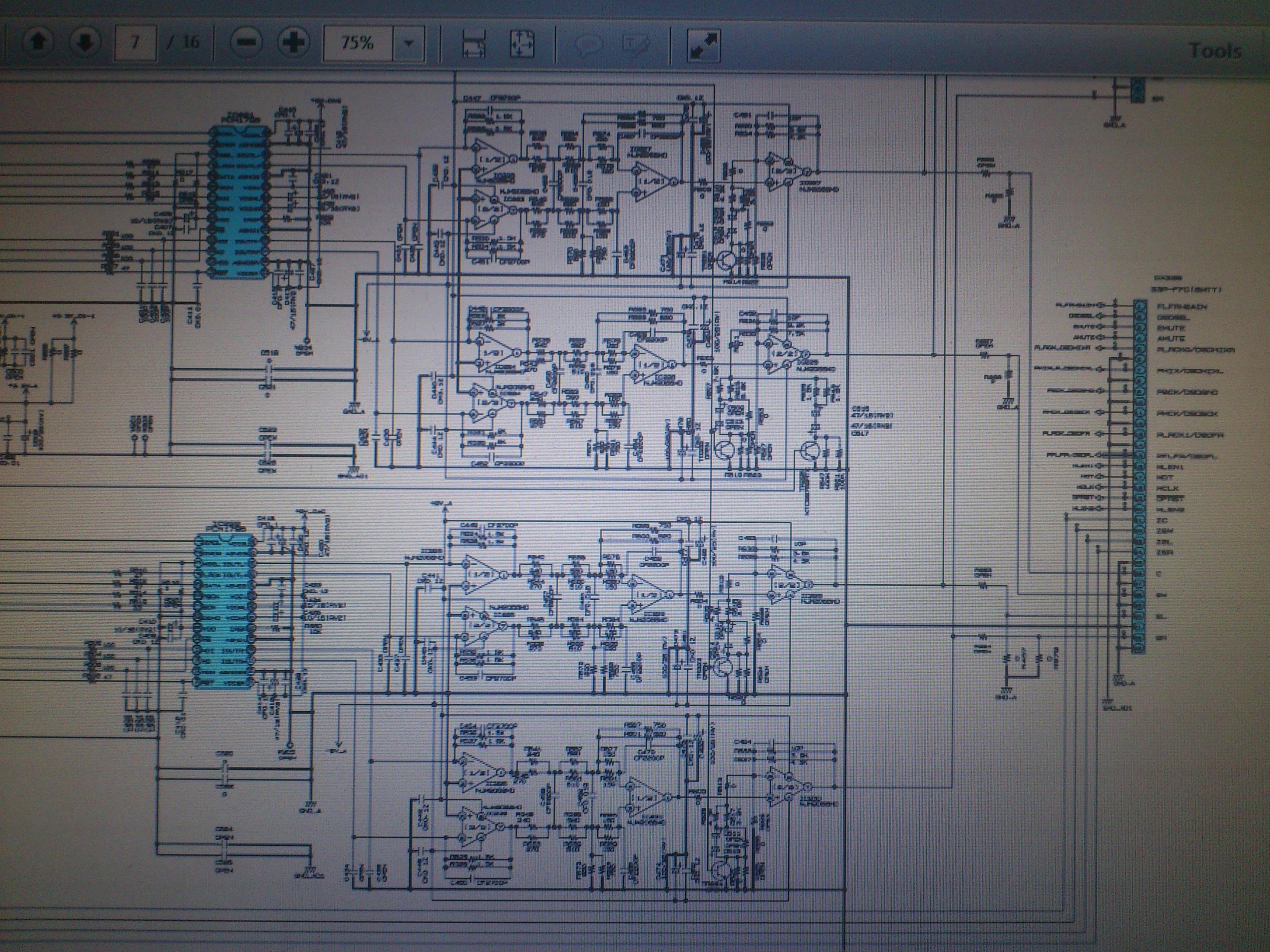

SL. SR .C OPAMPS -Sketch 7
IC223 IC224 IC227 IC228
IC225 IC226 IC229 IC230
FL FR CHANEL OPAMPS- Sketch14
IC301.IC302.IC303.IC304.IC305.
IC306.IC307.IC308.IC309.IC310
Well you can change all of them,but If I where to only use the FL,FR output I would only change the IC307-310.SL. SR .C OPAMPS -Sketch 7
