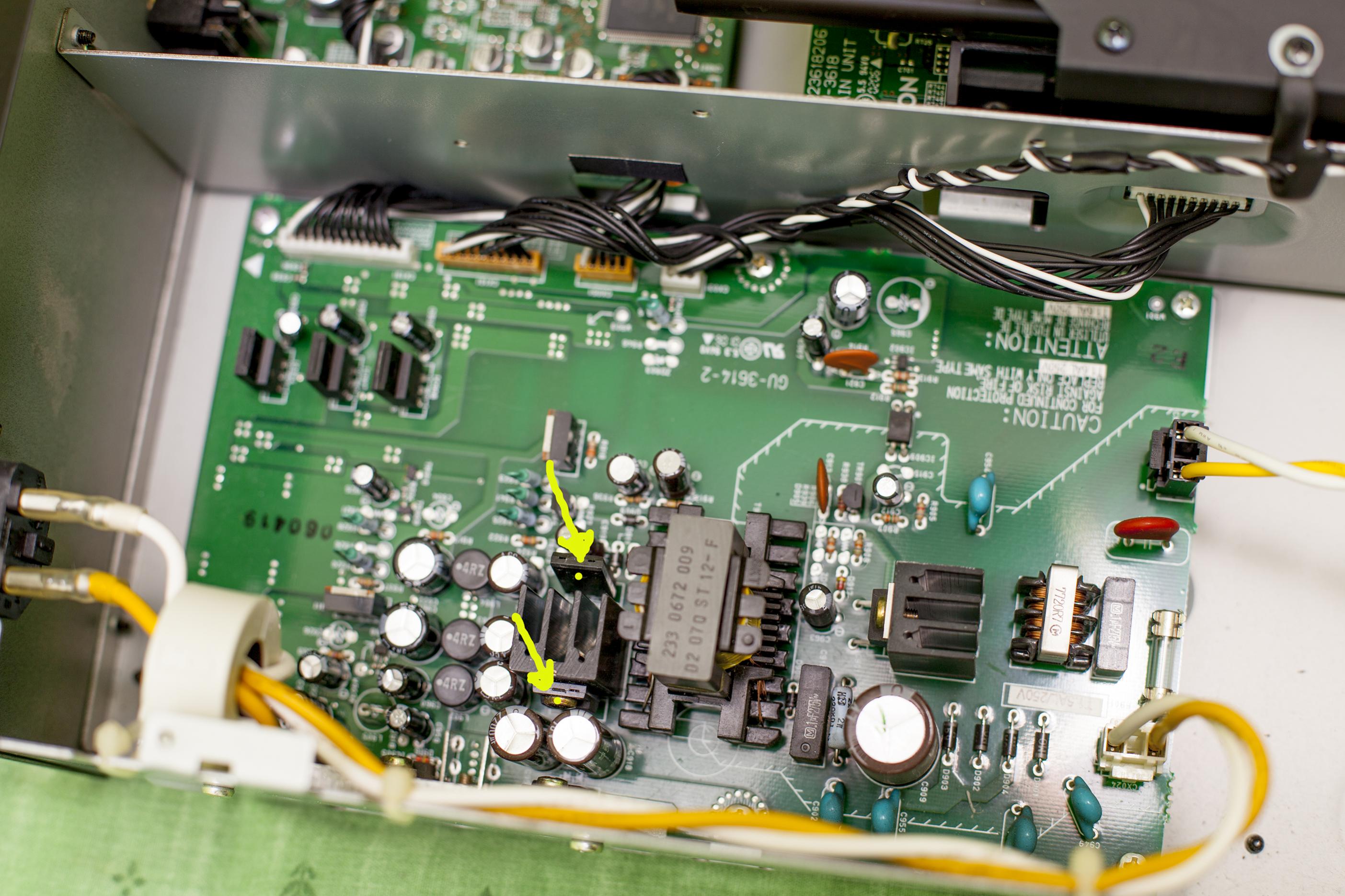

i wont to change the 2 schottky diode
d-908
d-910
DIODE FMBG19L (90V/4A)
in the smps

Now you complicating MeTry to determain the ringing and calculate a snubber (RC) over the diode.

sorry, you have to measure the ringing and counteract it with a snubber. If you have a scope it can be done with some trail and error. Cant't help you with that. Maybe somebody did it already???
It is common that there is a snubber over that diode.

Not replace the two switching diodes
Although they are a lot better than what the Chinese have diodes in SMPS Now
Those two diodes are parrallel in one! package, the cree is only one diode. You don't have room for two.
DudeThose two diodes are parrallel in one! package, the cree is only one diode. You don't have room for two.
Two diodes in the PSU are single
G19L (90V/4A)
I marked yellow arrow in the photo
But if I have to get involved with the calculations of ringing and calculate a snubber and changing the original values of the SMPS
I not replacing the diodes
I did not Understand you brosorry, i was talking about d907.
Schottky are not bad, if cree is better je ne sais pas🙂
So I can replace the diodes to Cree
Without changing other values ןin the smps circuit ?
So just general knowledgeyes, i doubt it wil make any difference
Why did you say first
I need to measure the values of the snubber ?
even with the best diode there is alway some kind of ringing left. Which you can remove with a snubber

But you scared me yesterday that if I change the diode it can make a ring
p.m
Sorry I do not know how to explain it in English Dude
Already bought all the parts for the mod of the SMPS
I will get them a few more days
The diodes of the CREE has been ordered
I just want to be sure that no harm will put them and Replace the existing
