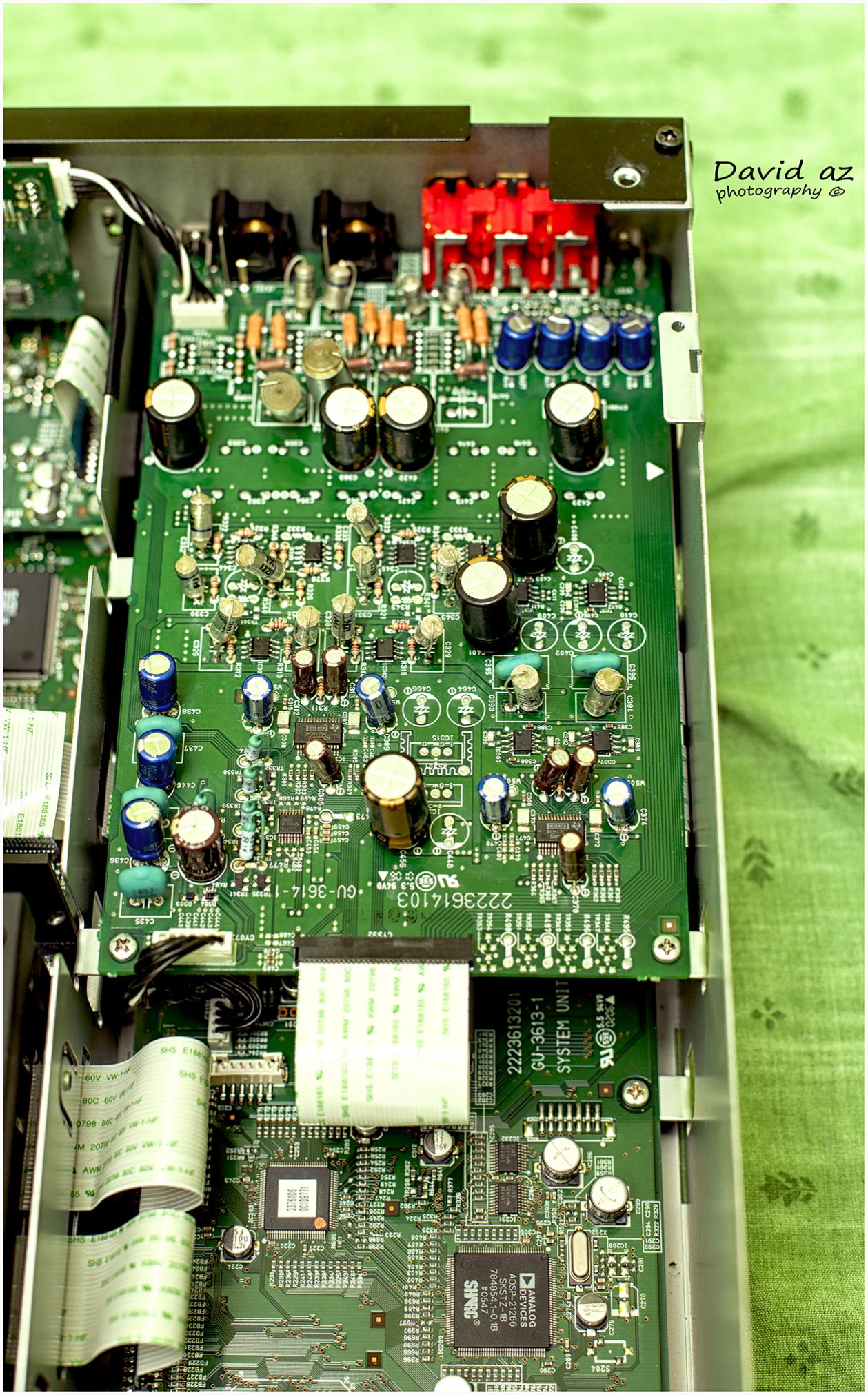

I think you have a 47u/400v cap as c909. I think you can increase it to 100u/450V. Use a good brand (ECC) and check for favorable smps spec's

Question How to calculate arrival capacitor 100UF
Instead 47UF exists now?
It is the model that you would recommend?

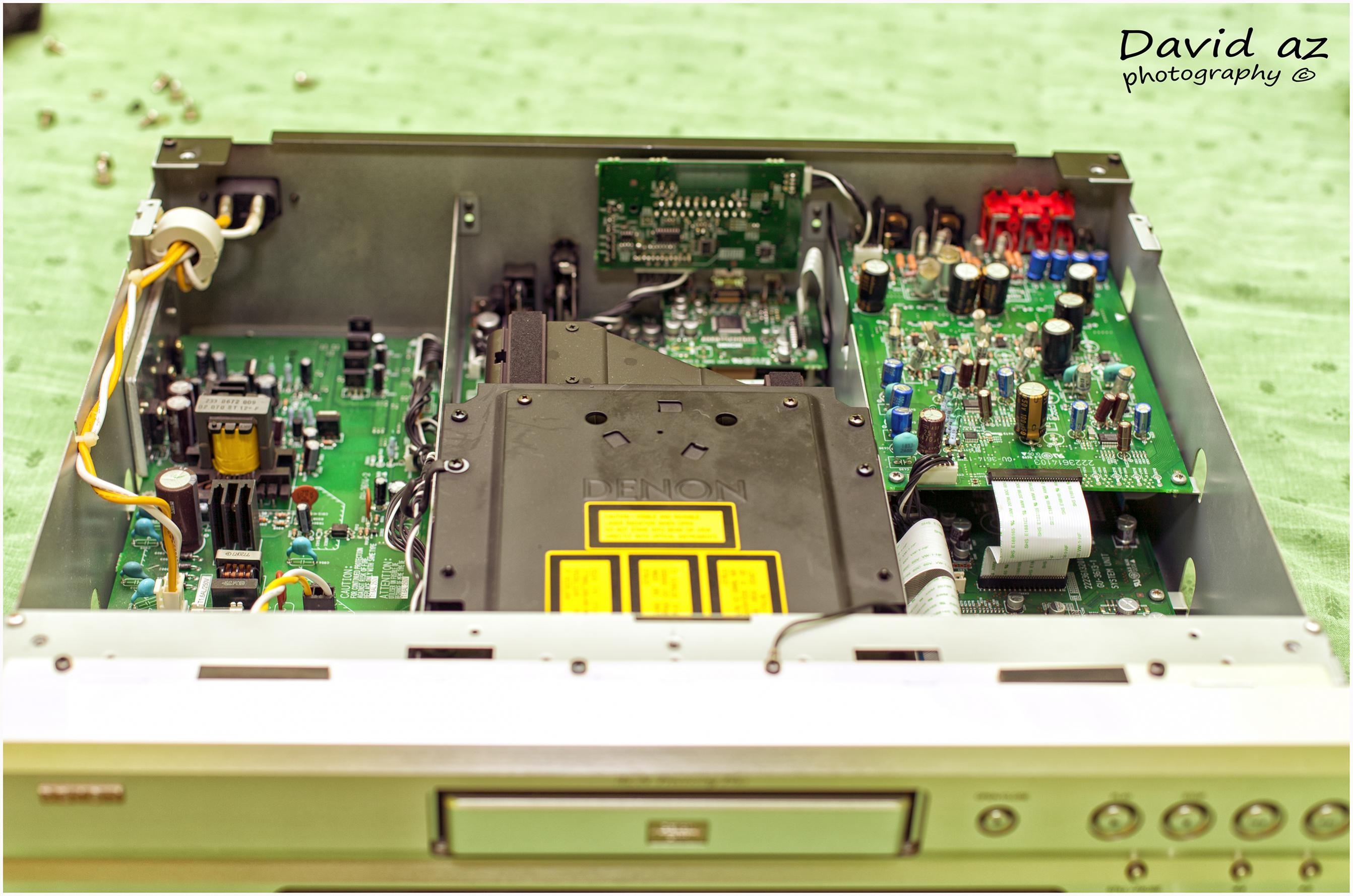

I am replacing the diodes
And some Primary capacitors

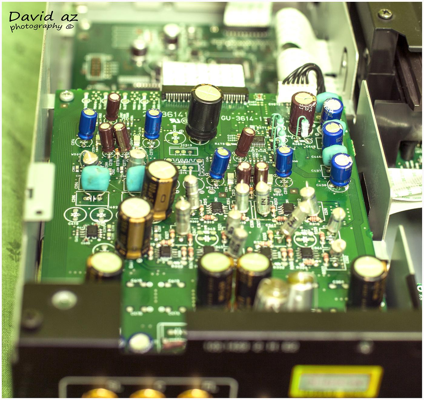

in the audio circuit I changed all 10 op-amp to lm4562
The device has been working 150 hours
Past the burn in
I tried a few discs have a DVD AUDIO
And improving them even bigger than SACD

I need to a capacitor for the switching power supply of the Danon
C909 ----Diameter 16 mm 47uf 400v
RUBYCON-400BXC47MEFC16X25
CAPACITOR, RADIAL, 400V, 47UF
What is the best capacitor is recommended by these
requirements ? 47uf 400v
105°C
High Ripple Current
low ESR
Diameter 16
This limitation diameter 16 mm

I used 100uF without problems,don´t know if it maid it sound better though...
To what company you replace the cap 100 uf ?
And what else you change then in the power supply?
I belive it was Rubycon or Jamicon.
I changed all the regulators and the elyts given in the list you got by P:M 🙂

I ordered the diodes to bridge diodes
VISHAY SEMICONDUCTOR - VS-ETX0806FP-M3 - DIODE, HFAST RECT, 600V, 8A, TO220FP
Choosing capacitors after the bridge prevents him from continuing
I need precise recommendation for most suitable capacitor C909
