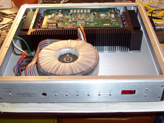

Btw I know the Krell is a commercial amp, and as most of them it has stupidity all around inside it.
The 750VA toroid is not bad, and the heatsinks would be salvageable too. 😀

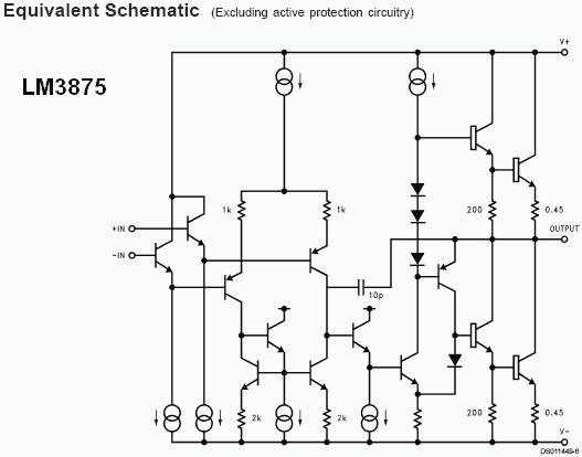

It is true that LM3875, the most frequently use chip amp used in so called gainclone,
has more transistors than widowmaker amp DoGC.
See simplified schematic below.
Each current source makes at least 1 T, and active protection add several more.
We could make a chip without protection, but marketing this would not be good for business!
What is different in LM3875 toplogy compared to a 'normal' amplifier, for example DoGC?
- Two extra input transistors in the differential input stage (reduces input bias current)
- Second stage VAS is no different from normal amp
- Output stage uses only NPN Transistors - not normal

Great idea
I've never looked at equivalent schematic of this chip, but its topology looks damn clever.
This will be good adiophiles hearing differences in resistors , because R's in IC are probably of worst linearity and so on. 😀 100x worse than cheapest carbons.😉
Actually I like the output stage. A bit like quad and the error correction mechanism looks very clear, with output stage in class B except of C in quad I think.

LM x875 has 4 stages, exept output darlingtons (quasicomplementary!!!):
1. input stage
2. diff amp with current mirror
3. emitter follower
4. common emiter with current source
In DoGC, again except output stage:
1. diff amp with current mirror
2. common source with current source
The more I look at the DoGC schematic the more I appriciate it .. it's just a lovely simply, yet elegant amplifier circuit... with a twist, the current dumping current sources..

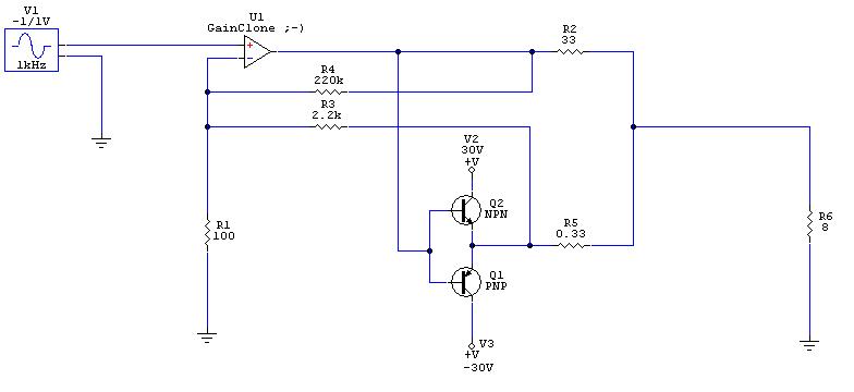

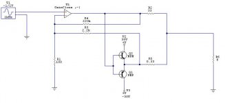

I took my JohnLinselyHood books and start reading about the Quad current dumping principle.. I don't think I quite understand it but would this work?
It's just a proof of concept in my simulator NOT a real project.. the DoGC is a better solution I now understand.

I can explain how it works, but my english is not very good...
This is slightly dificult for me...🙁
The simply explanation is:
The bridge ( 2x1k; 120pF; 47 ohms; 4.5uH ) compare the signal between input and output point and add correction current in output of the amp, wich eliminates nonlinearity of dumpers.
The most important conditions are:
1. Balanced bridge for high frequencies - why for high frequencies? -
less open loop gain, more nonlinearity. In low frequencies we have more gain and negative feedback can correct nonlinearity of dumpers.
In this cause:
The most important component is the output inductor! Make it carefully and tight with thermoshrinkable pvc tube as shown on the picture.
First axial, after that radial.
2. A good and simply ( more components = more noise and nonlinearity) reference class A stage (preferable SE) with less components and a good open loop gain.
SRPP has a poorer sound quality vs. differential input stage.

LM3875 Equivalent cct :
Darkfenriz, what do you think if this equivalent LM3875 cct is made to real discrete amplifier? Can the 3 diodes string (bias diode) replaced by VBE multiplier (for practical bias adjustment)? Is this replacement will ruin the error correction that you mentioned?
Yes, it is clever, especially the lower diode which connected to the VAS resistor.I've never looked at equivalent schematic of this chip, but its topology looks damn clever.
That's what I heard too. Inside chips, all resistors are capacitors are forced to be made of silicons, which are not good for capacitors or resistors.This will be good adiophiles hearing differences in resistors , because R's in IC are probably of worst linearity and so on. 100x worse than cheapest carbons.
What error correction do you mean? The lower diode connected to VAS resistor? I see this in LM3886 inside schematic too. Error correction usually have input and output to compare with. Which part do this in this LM3875 equivalent cct?Actually I like the output stage. A bit like quad and the error correction mechanism looks very clear, with output stage in class B except of C in quad I think.
