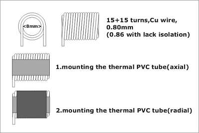

Let me put some exotic taste (in the attachment) in this very old thread 🙂
I have also another, less exotic version with bootstrap instead of inductor.
LTSpice shows interesting things (values and pictures) when simulate both
of them. 2SK369 still can be found on ebay, I use factory matched K369s
with Idss 13.5mA from Japan.
I don't like cascode stages, constant current sources and other similar stuff,
that makes some schematics to look let's say cooler, the only exception here
is the current mirror, not because I like it, no, simply there is not enough gain
without it. In other words it is a necessary evil in this schematic with only two
voltage gain stages.
