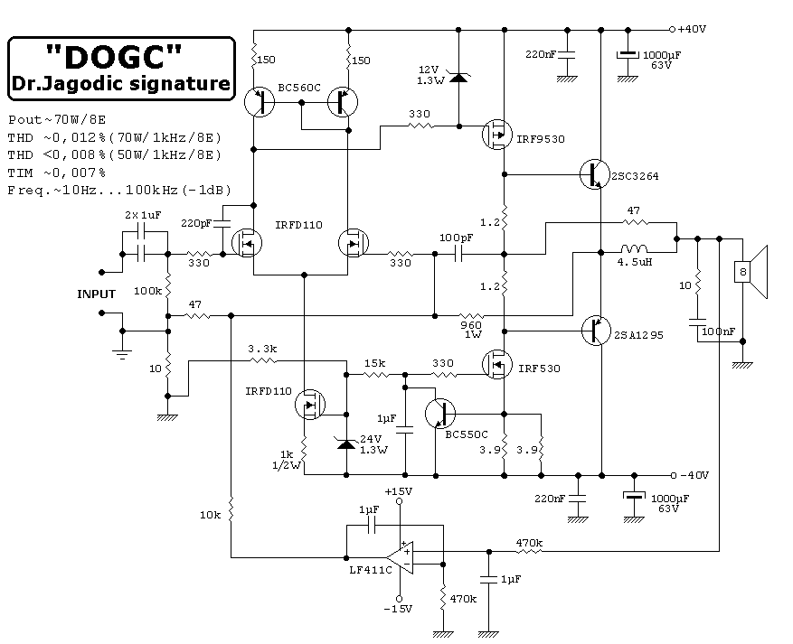

kostazl said:How about that Re-design of the idea ...
With Multisim 8 gives from 1 to 50W THD<0.01% @ 4 ohms (20Hz-20kHz).
The Darlingtons can be any transistors with the desired parametrics.
Looks very, very good, kostazl
A possible variation version of DoGC.
How this compares to widowmaker's original, I guess nobody knows?
You think it is an improvement, kostazl?
What figures you get if simulating the DoGc original circuit?

I like it, especially bootstrapped class-A section and buffer before it. I think that original schematic with mosfets would benefit from buffer too. What is a purpose of 1uF cap in buffer's collector? To reduce C-E and B-E capacitance effects? BTW I think that when using darlingtons, we can put three diodes, not two. That way we'll be closer to class B bias.kostazl said:How about that Re-design of the idea ...

boraomega said:There are some variations of widowmaker's original design suggested by me earlier in this tread as possible improvements.
Well, one of those ideas was recently done practically by me and it is performing extremely well on my bench for last month and a half for several hours every day!
I can't say what are comparative advantages (if any?!) in regards to original design, because I never got a chance to have working original unit to compare,
but if that original is working like this my version, it is a hell of a "machine".

This latest schematic from you, I like.
I am sure it is an improvement in some details of 'original DoGC'.

Hi "kostazl",
My version published a few posts earlier doesn't show any trace of tendency toward self-oscillations at all no matter what is the temperature or is it clipping?! Frankly, my speakers are relatively benign regarding reactive behavior and that could be one of possible reasons. Another could be PCB layout and eventual mutual influence between 4,5uH coil and surrounding components?!
I am rarely pushing an amp into clipping because it is not primarily designed to work under such conditions. If amp is performing marvelously on all levels under onset of clipping, with good sound in any aspect and perfectly stabile, why will I ever need to push it further?! I will use it through entire "working life" of that unit well within its designed limits and it will perform as it is expected. Fact that I maybe won't know how it is behaving during clipping won't diminish my pleasure and enjoyment with that amp.

kostazl said:I am very disappointed, that you've got me so wrong, gays...
I am also audiophile as you are, but nobody, absolutely no body can convince me that good engineered amplifier can give unstable clipping, because that means it will die as soon as you reach the clipping zone.
Everybody knows, that listening to dynamic modern music, Jazz or even Classics are often putting the amplifier near to clipping conditions. This effect is many times worst when your supply is with bad regulation or with less power capability. Never forget the logarithmic transitions of the real audio signal.
And just let me know how many of you actually built that amplifier and tested it ...
Well, some of you may say that I am only using simulating and talking bullshits, but those of you, who are using Multisim knows how precise all the models are. And all of my QUAD405 mods (which are all death now) gave me bad clipping during the simulation, but the rebuild of the original schematic is still working.
Better modification target could be the QUAD303’s topology!
I am not blaming anybody, it’s just may opinion according to my experience! I may be wrong but nobody gives me a good stable argument!

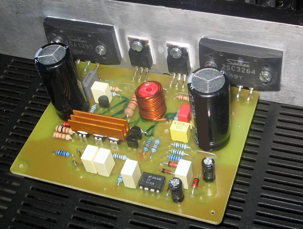

Dr.Bora,
Is your schematic complete as posted and is it possible for one to build a trouble-free working model on that basis?
Tell us more about its sonics!!
Absolutely Samuel! That schematic is exactly the version I kept finally and is actually working on my bench for last several weeks. As soon as my younger daughter is back from holiday trip to Italy (she got my digital camera!), I’ll try to make and post some pictures here.
As I said previously, Iwill NOT post PCB and layout files here because this is “widowmaker” tread, but anyone interested to try my version is free to contact me on my E-mail address available in my profile. Those files are FREE for anyone for personal use!
Kostazl, your countryman's nick is "widowmaker" and not "windowmaker", even thou some windowmakers could easily become widowmakers if they try hard! 😀
Boraomega, I am interested in getting the PCB design and trying out this amp.
In the meantime, here are a couple of questions.
1) Would it be possible to use two pairs of 2SC5200 and 2SA1943 transistors in place of the hard to get Sanken output devices? If the answer is yes, what would be the value of the emmiter resistors?
2) What are the devices under the small copper-coloured heatsink on the PCB?
3) From the picture posted, some of the resistor values don't seem to correspond with parts shown in the schematic!! But I could be wrong here.
