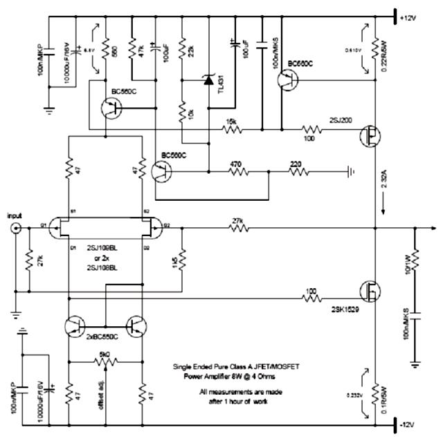

Personally
I like the Single End Class A - 8W/4 Ohm - +-12V supply
by widowmaker better, see CIRCUIT below.
I think it has greater potential to become a very popular project.
What I should change is to use 2SK389 instead of more hard to find SJ109 in input.
Even 2SK389 is not easy to get a hold on everywhere.
So I would make 2 separate, but closely match single JFETs, an option.
TL431 and BC550/BC560 is no problem to find.
The output MOSFETs 2SK1529/2SJ200 is not everywhere
but can be found most countries??
Complementary output MOSFET pair are biased 2.32 Ampere for 8 Watt into 4 Ohm speakers.
A nice little class A project!
What would be a proper Power Supply for good +-12 V DC ??
