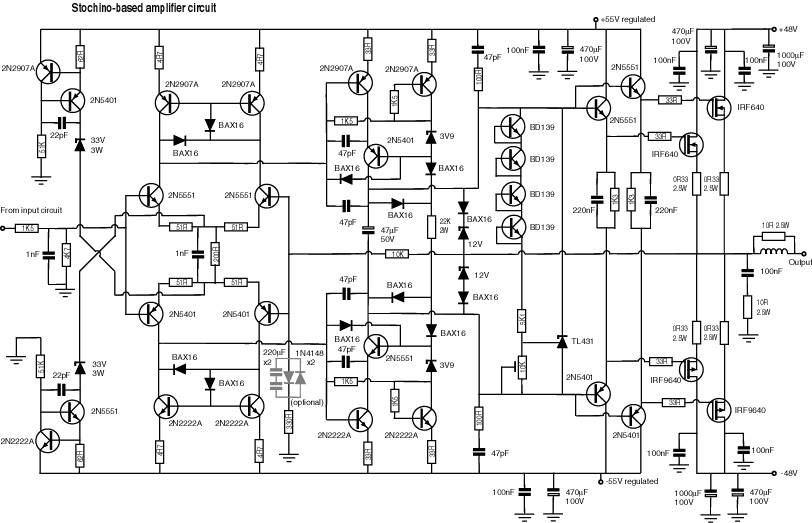

This is the schematic of a 'High-speed 100W amplifier' based on Stochino design from 1997 Electronics & Wireless World.
It is far more complicated than DoGC.
Notice use of parallelled 2N5551 and 2N5401 small signal transistors!
as drivers of IRF640 and IRF640 HEXFET.
Aslo using TL431 as VBE-multiplier to set/hold output stage bias.

I had to re-draw the circuit a bit to see the 120pF, 4.5uH, 500 Ohm, 27ohm feedback topology .. That is the feedforward part right?
I have no experience with that kind of topologies, but I have read about the Quad amp it is similar.. but could you explain? I never understood it..
