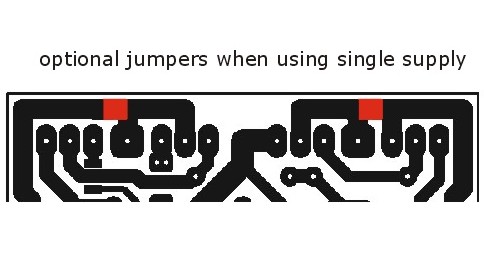

if one would like to build the DoGC in classAB like the shem in the first post.
Why are there two solderpoints each to attach the supplyvoltage? Schould the voltage for the BDs be filter by the Inductor, or what?

Re: PSu question
There are two points for supply voltage - one for class B (BDs) and one
(with inductors) for class A - diff and IRF9610/620.
As you see on attached picture, there is an option for one PS.
Resistors in bridge are 1% - 2x1k and 47 ohms...
The most important part is inductor, make it carefully!
120pF is Wima, 5% tolerance.
I made (and many people made too) a lot of DoGCs here, in Bulgaria...
The project is enough old, it started in the beginning of 2005.
Possible substitutions:
2SK170BL, 2SK117BL, 2SK364/369BL or V...
There is one condition:
Id=9-10mA(or more) @ Ugs=0V

Hello
so I may add the jumpers and use the amp with a normal (non-inductive) Power supply? Like it is shown in the shematic?
Or are the Fets running in Class A all the time and the BDs runnig in class B at the same time? this makes no sense to me.
thank you for the substitudes!
Twin power supply eliminates pulsations in PS for input stages caused by the collector current peaks of dumpers @ high (not only) output power...
