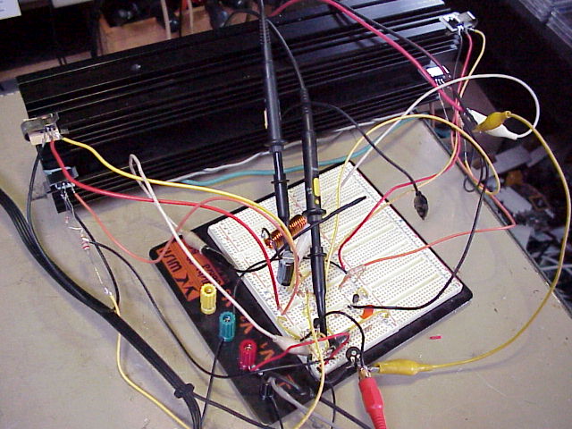

I’ve breadboarded one channel with slightly different components as I had them at hand.
BC560C has become BC415, BD911/12 is replaced by MJE15030/31 and the 2R2 drain resistors are 2R7 for the moment.
The 120pF is 100pF and the parallel capacitors 3300µF/4.7µF are one single 2200µF. The 10ohm/100nF combination at the output is omitted.
The 4.5µH coil is made from a two times 18 windings of 1.6mm copper wire and an inner diameter of 6mm. Not sure I got the correct value though.
At first I forgot the CE 100nF capacitor on the BC550C which made the amp oscillate.
But it plays and idles at 180mA. Offset is only 30mV.
I’d like to know what makes the coil so important.
I understand it’s, together with the 47ohm, 120pF and 2//1k some kind of filter.
A picture? Sure but it's ugly as hell.
/Hugo 🙂

These values are very critical, and should be trimmed for optimum settings .. It forms a bridge circuit so that the current dilivered by the currentdumpers is compensated for by increasing the feedback...
here is a schematic which sows the principle .. the 4 resistors (r2, r3, r4, r5) form the bridge.. the ratio of the values is very importand..
http://www.diyaudio.com/forums/attachment.php?s=&postid=793335&stamp=1134915935
now you can exchange 1 resistor with a coil, and another with a capacitor.. and the ratio stays the same (correct?) .. the circuit will still work, and will have less power wasted due top resistors in series with the loiad...

I can not say I undestand how this current dump with inductor works.
I only have a vague idea.
Inductors does not not behave as normal resistors 😀
