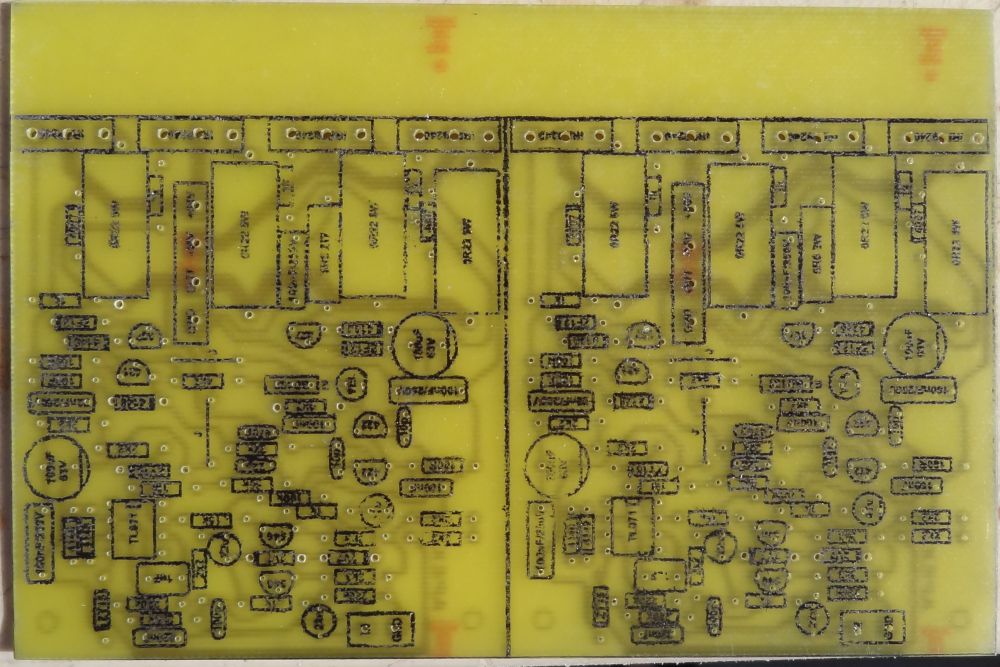

It's exactly what I have built (only Zobel is 4R7 + 100n due to lack of components).
Thanks to Mile. The amplifier sounds very nice.

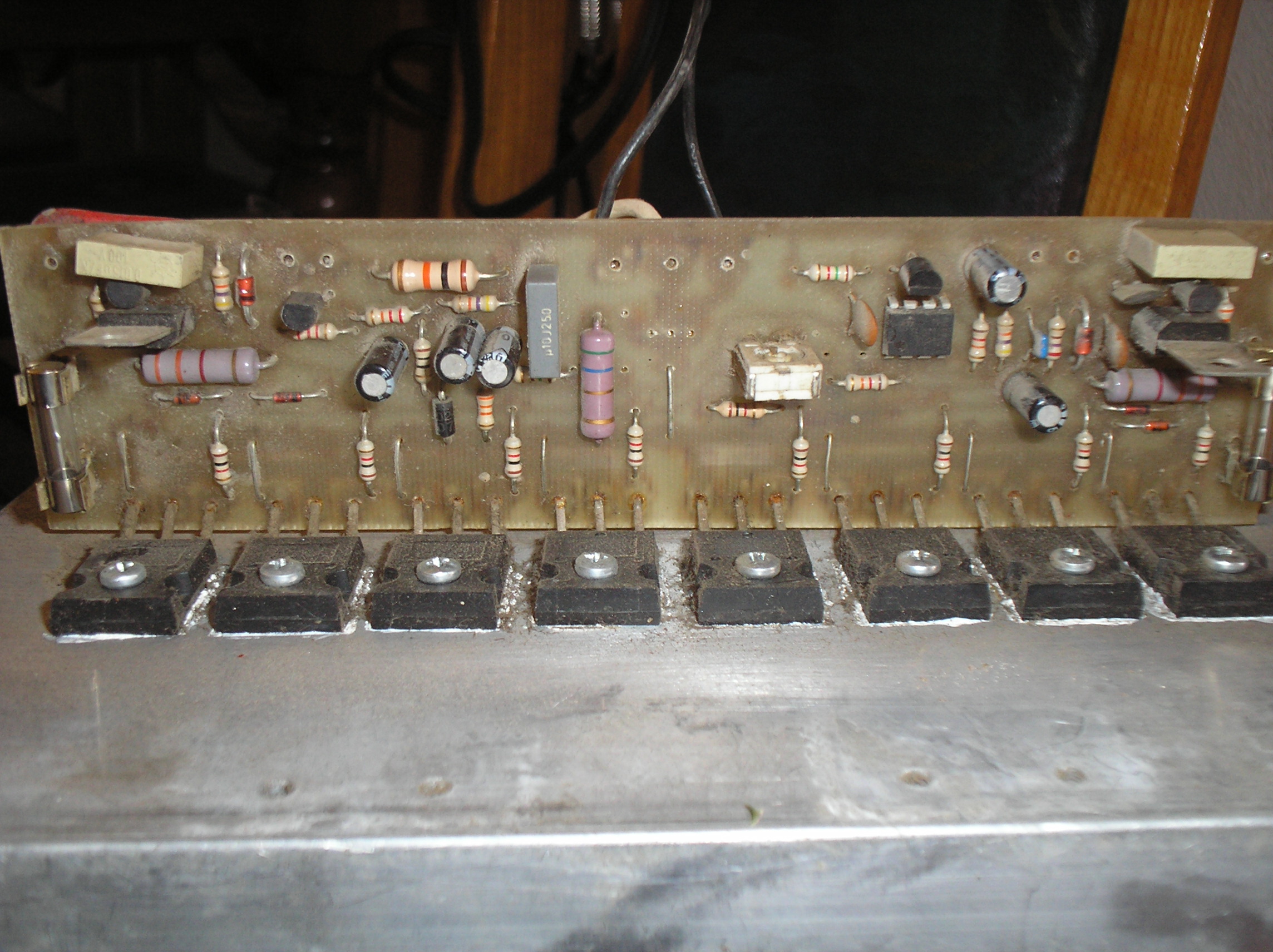

I hope Mr. Mile will share this F400 version.
This F400 is over 15 years old and I must redraw pcb and schematic with some upgrades.
Regards

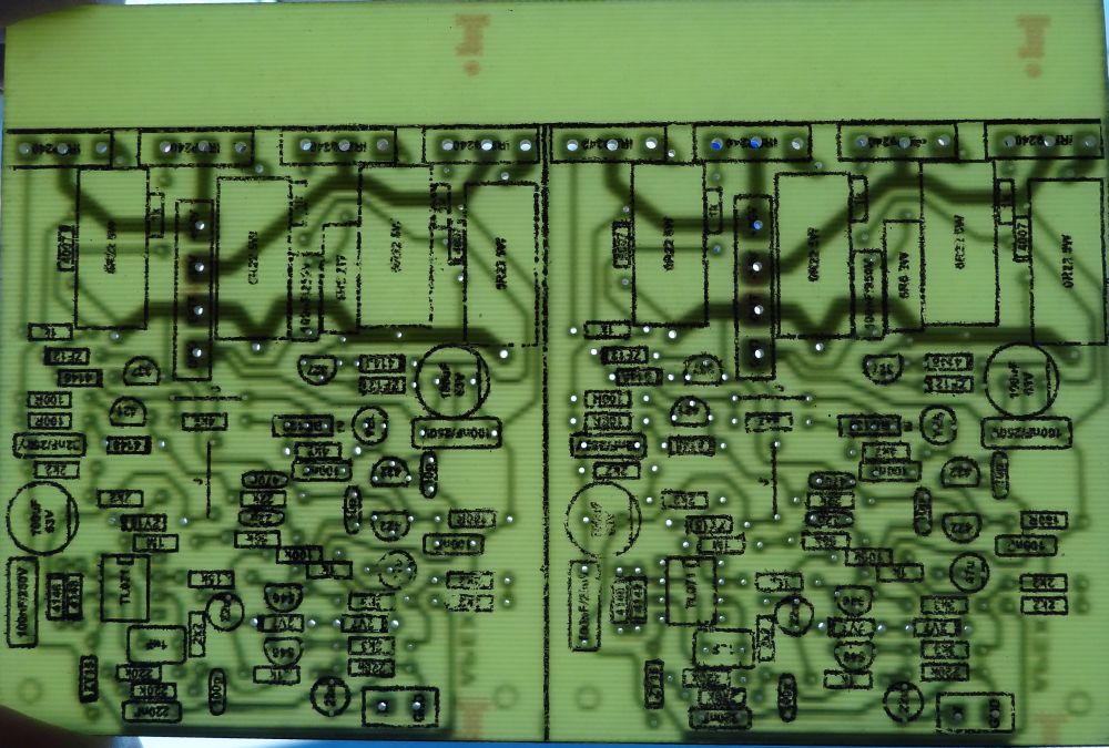

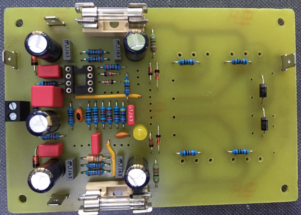

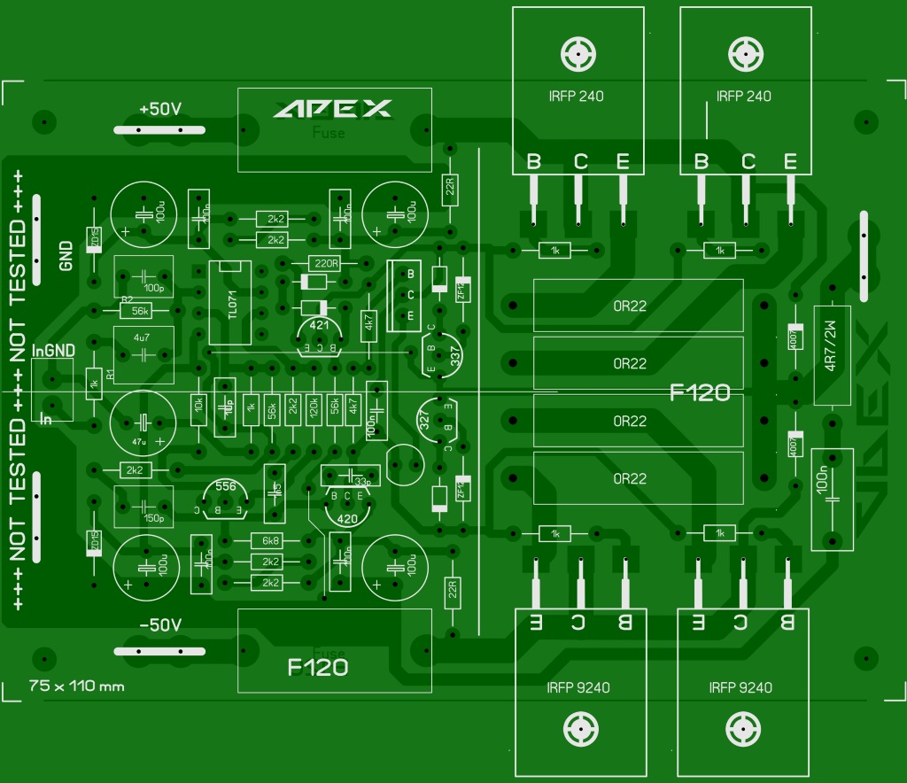

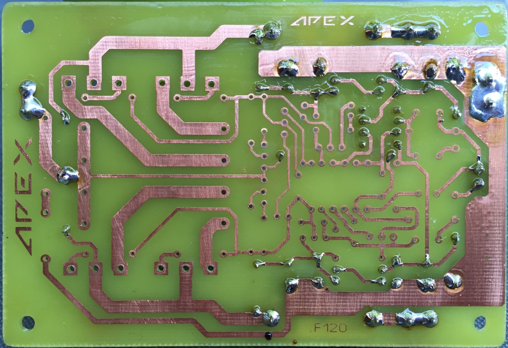

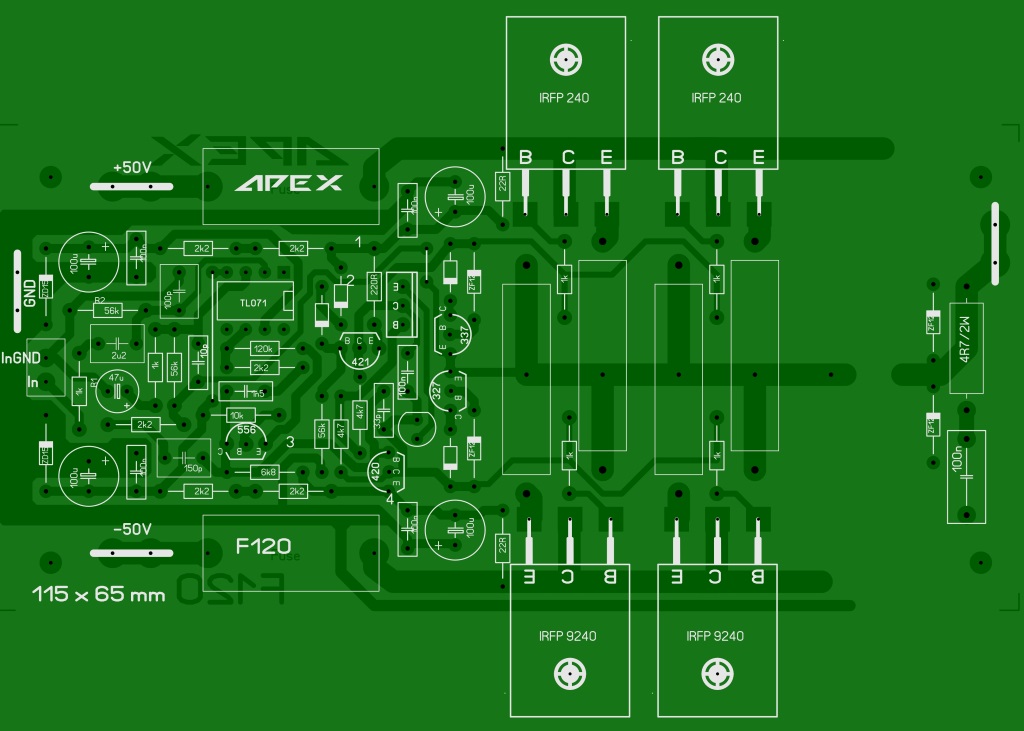

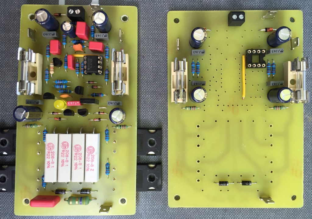

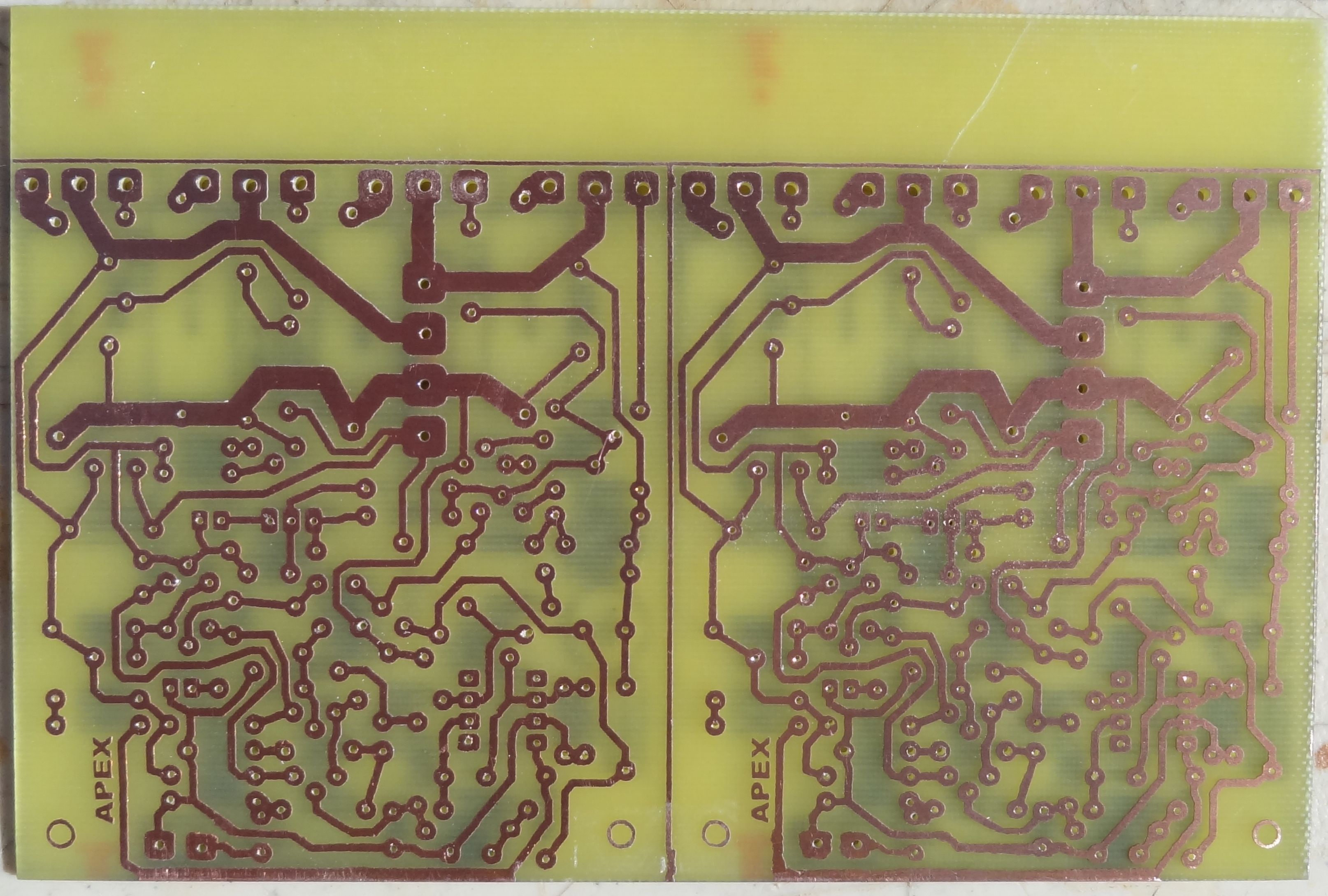

Hi, here are a few photos of my second trial with the F120. I could not get it stable running.. A few times he was working, then again not, I have found no reason for it.
Does not matter. Because I no longer had patience to look for, I have a new attempt and started a new layout and a new prototype. Let's see. I will report.
regards Olaf
regards Olaf

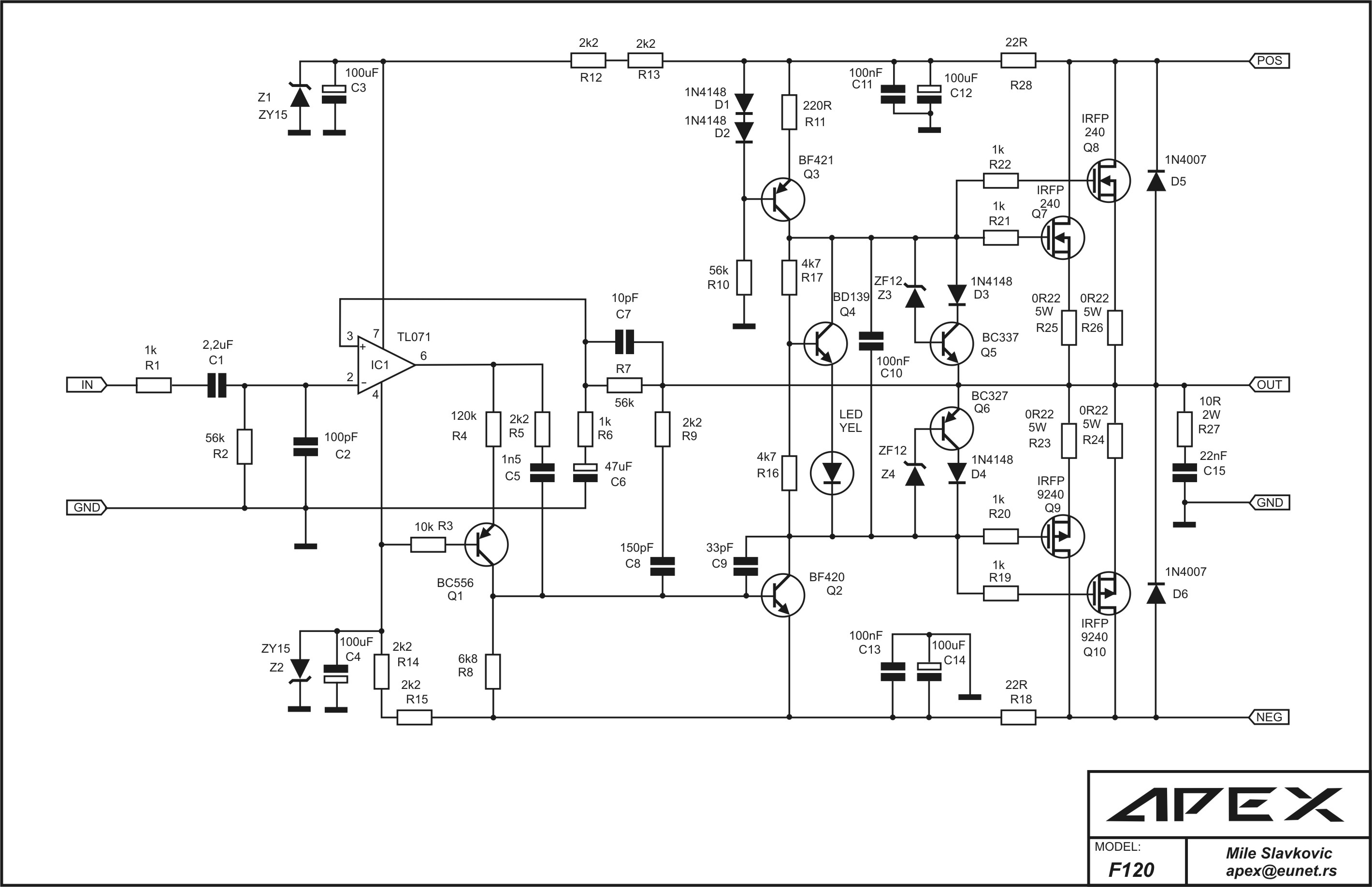

I suggest F110 for new prototype.
Regards
To late 🙂, some more components installed.I suggest F110 for new prototype.
Regards
regards Olaf

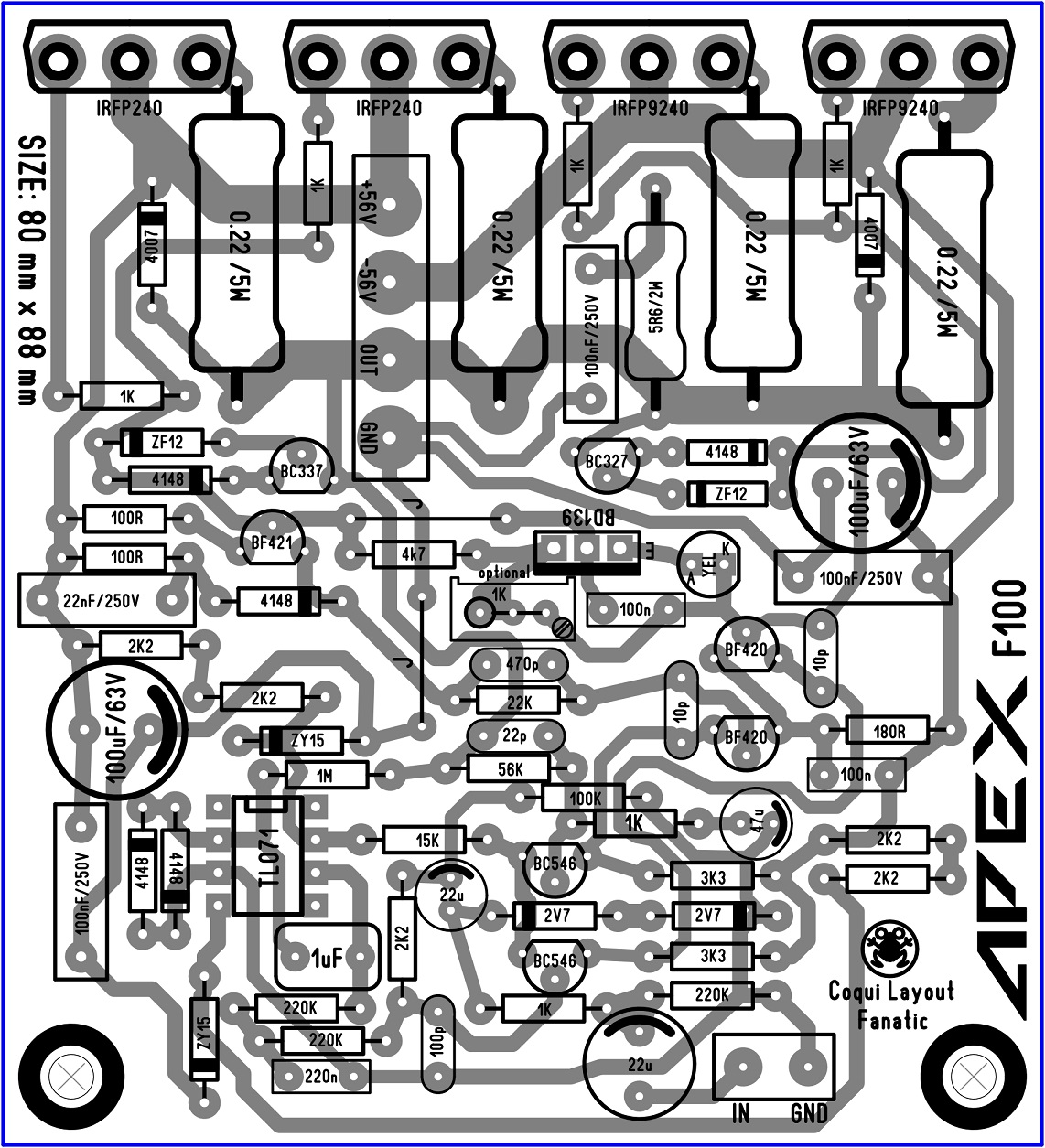

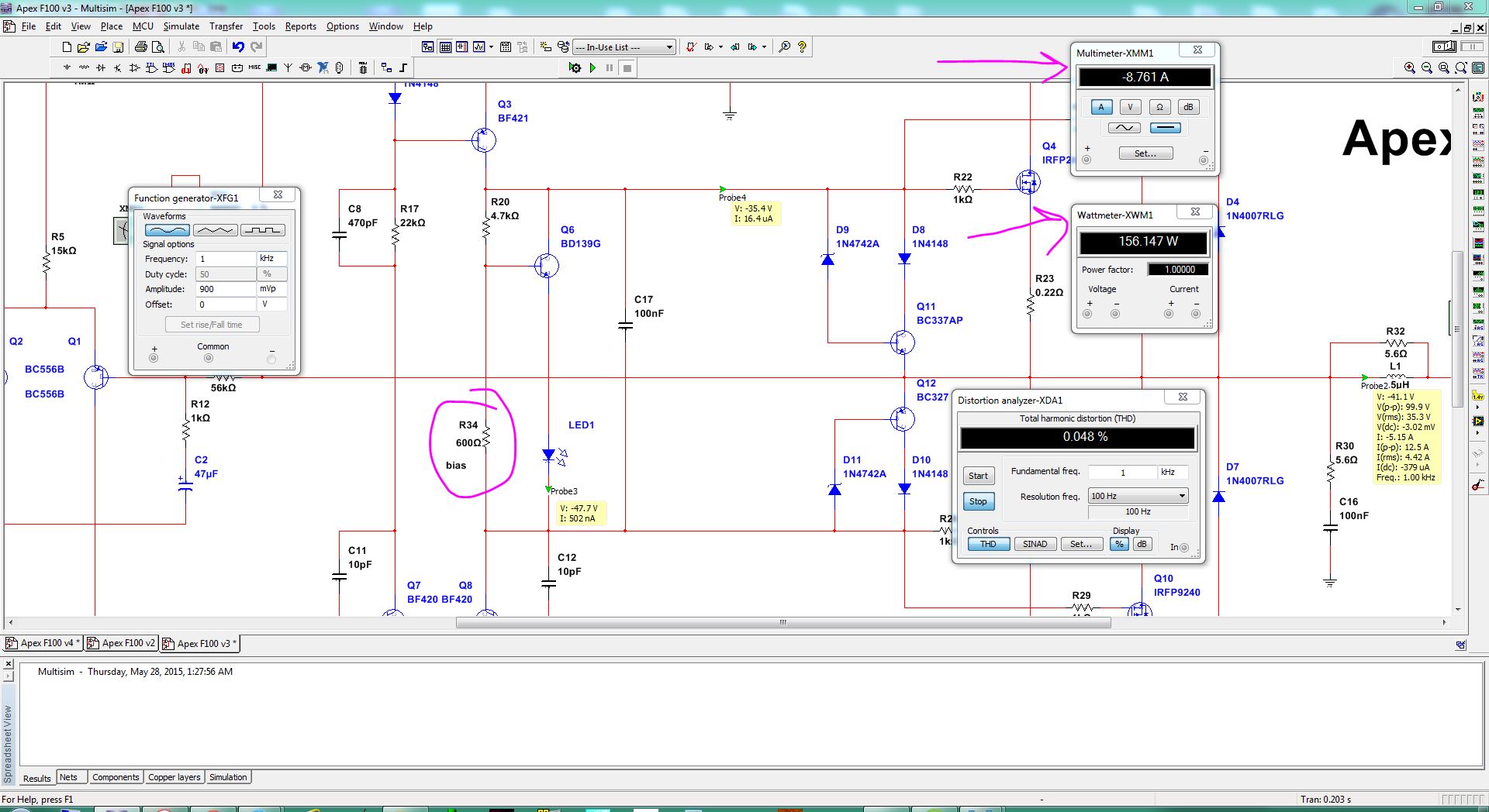

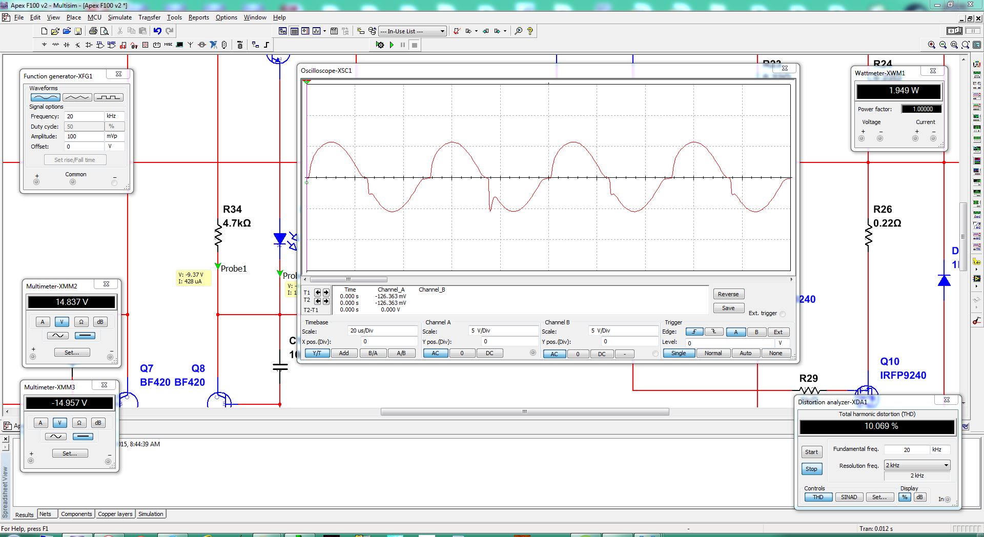

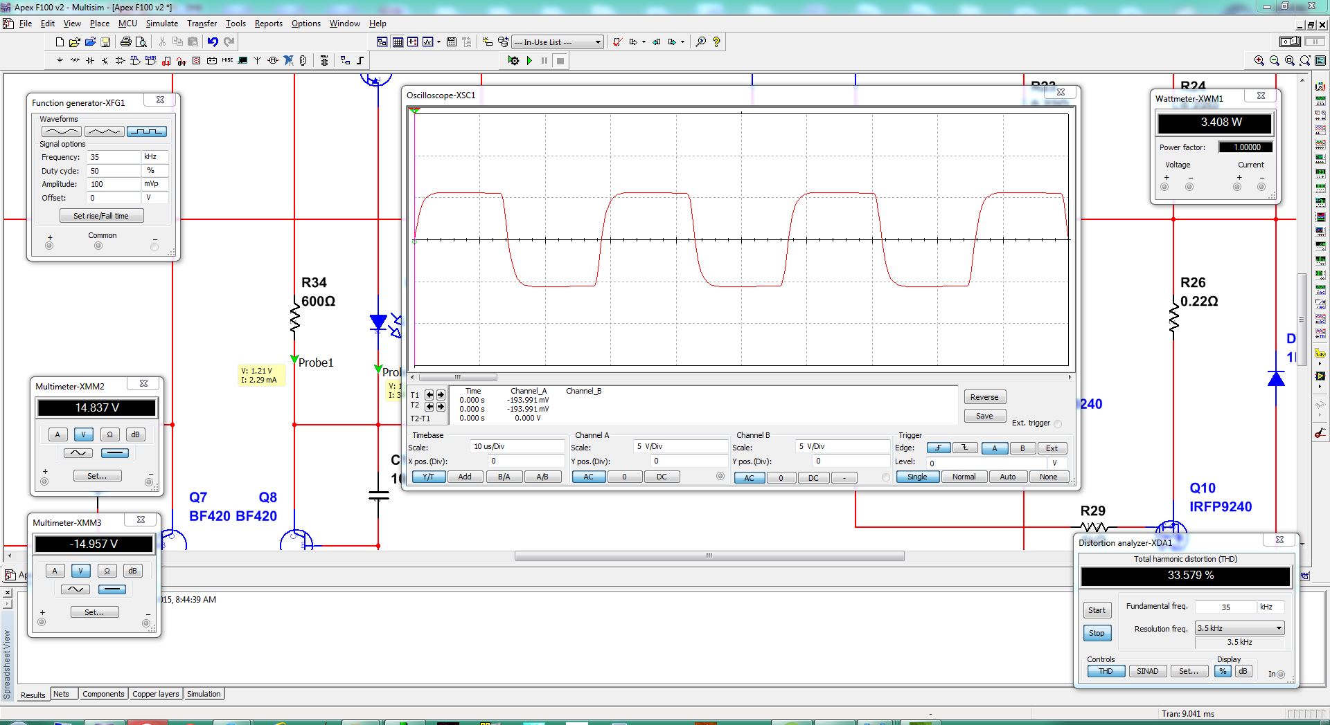

I was simulating the F100 and I notice that after I simulate with 20K the sine wave does not stay smooth and has some sort of anomaly "not to be alarm" so I spend a few hours checking and it come that R22 4.7k I changed to 600R so now even if you go more than 20KHz it will continue to keep the output nice and clean, I mean this is my diy thinking I might be wrong, what you guys think ? 🙂

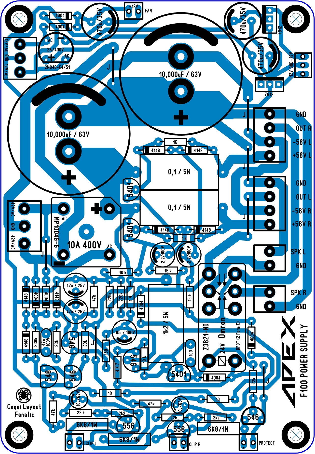

well I just re-drawing the F100 and add a trim pot and also a illustration of the original R22 4.7k to be placed there or trim pot 1K to do fine adjustment 🙂 also a re-drawing of the supply too please if some one see a mistake let me know I will leave the Sprint Layout 6 file here please only for diy to enjoy yourself guys 😀 I wandering if mister Terry already made it 🙄 ?
Regards
Juan
Regards
Juan

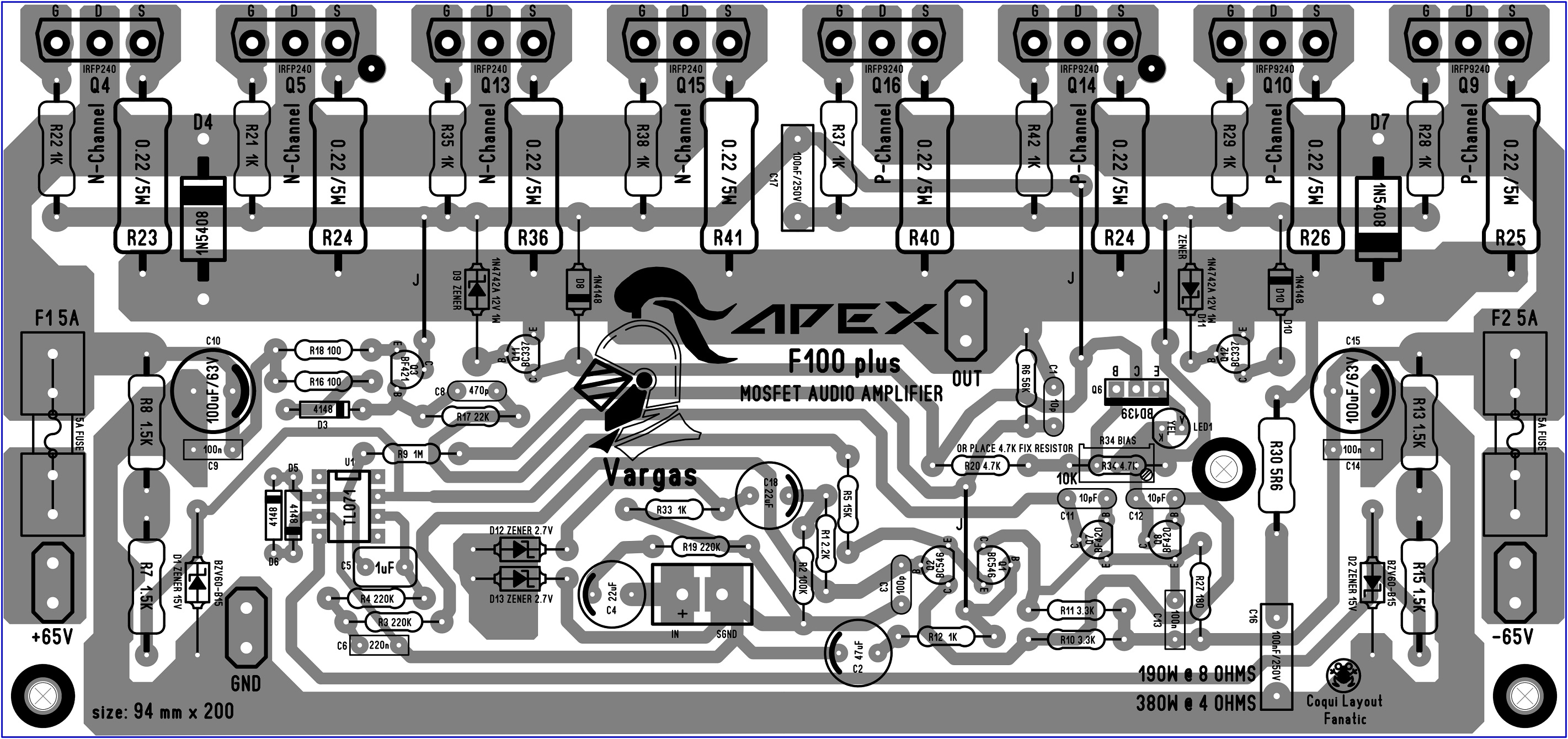

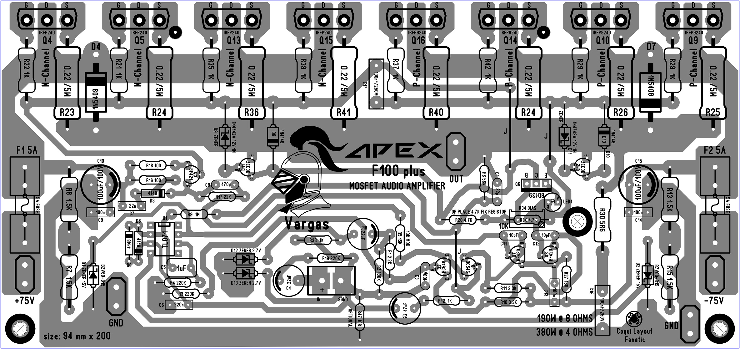

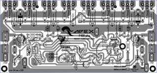

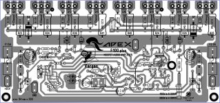

question, I was just making a larger version of the F100 and I was wandering if a coil can be add it to the circuit ? this layout is not test it yet just in case 🙂 I already simulated and respond really well, I think 😉 , I have to completed and check for errors here is the layout now "not tested"
one note the R34 can be adjusted to 1.5K and that will give about 45mA so reading one of the 0.22 5W resistors is about 10mV to be on the save area 🙂
I know is not like BJT but not to be abuse them jejejejejeje 😛 been mosfet
Regards
Juan
Regards
Juan
Nice work, go to post #35.question, I was just making a larger version of the F100 and I was wandering if a coil can be add it to the circuit ? this layout is not test it yet just in case 🙂 I already simulated and respond really well, I think 😉 , I have to completed and check for errors here is the layout now "not tested"
Regards
Juan
