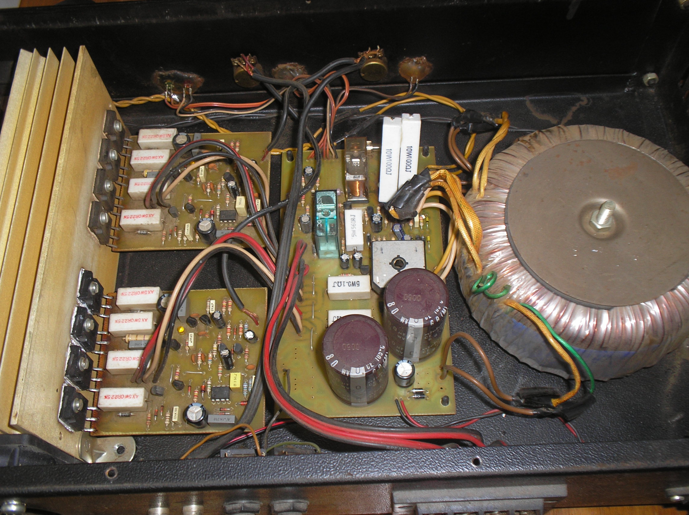

The Pub Cleaner must be opening up and cleaning it every alternate week.
I cleaning it and replace fan every 5 years 🙂
15 years old amp work over 16 hours every day in pub.
Nice one Mr. Mile... Hard Working and Heavy duty Amps...
