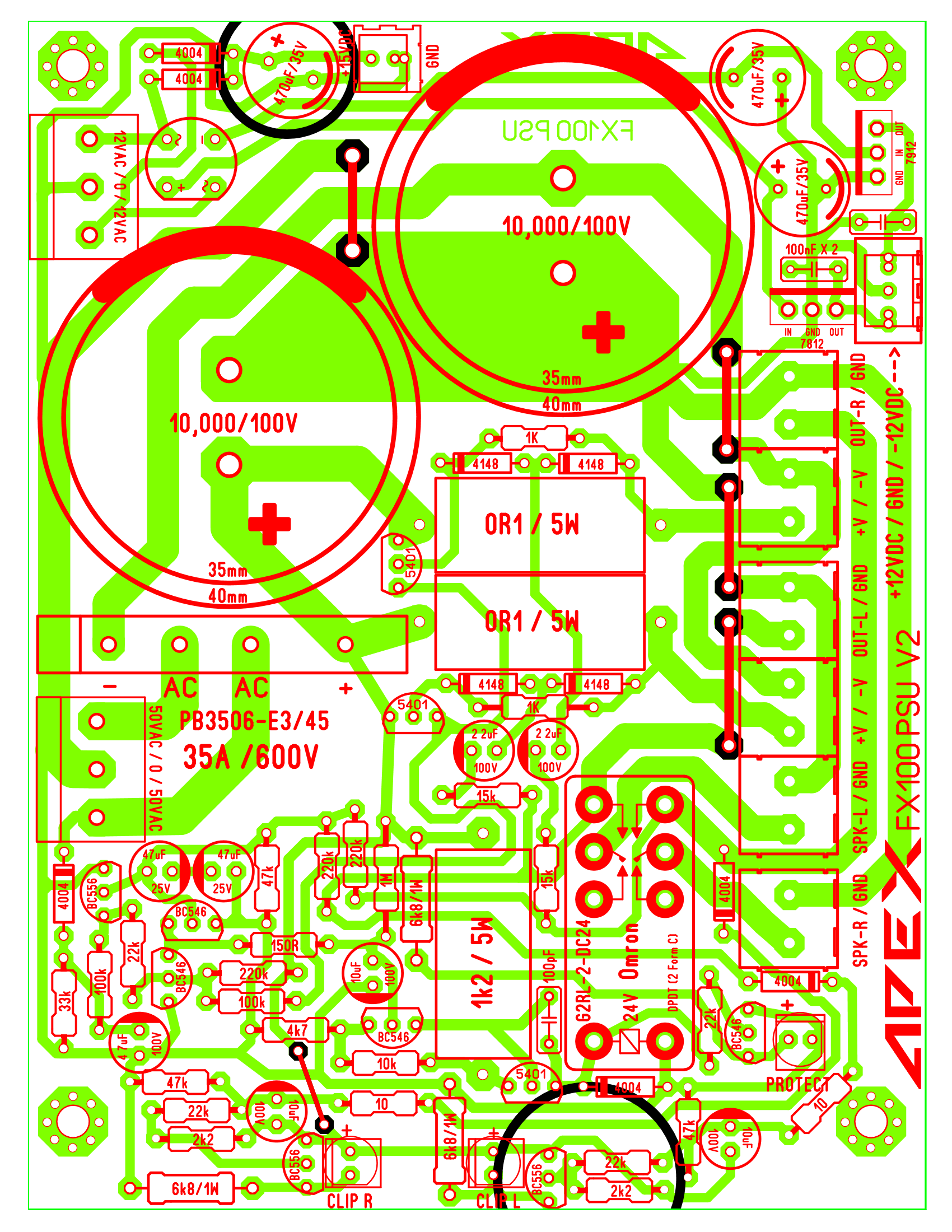

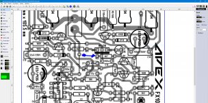

I found two errors and fixed them. This has been tested and works well.
Some tracks missing...
Use this PSP100 for FX100 with 3 pairs.

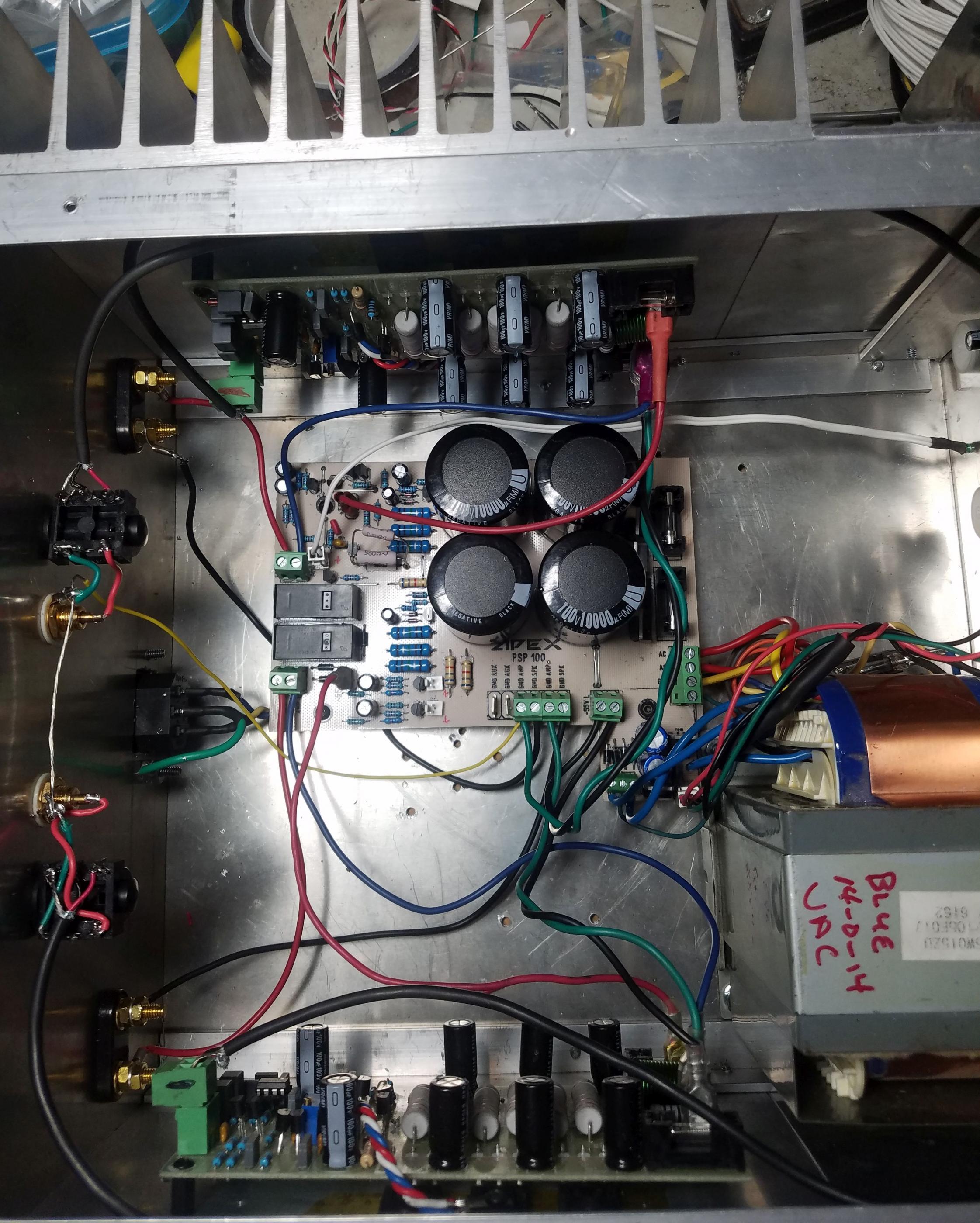

Hi Mile,

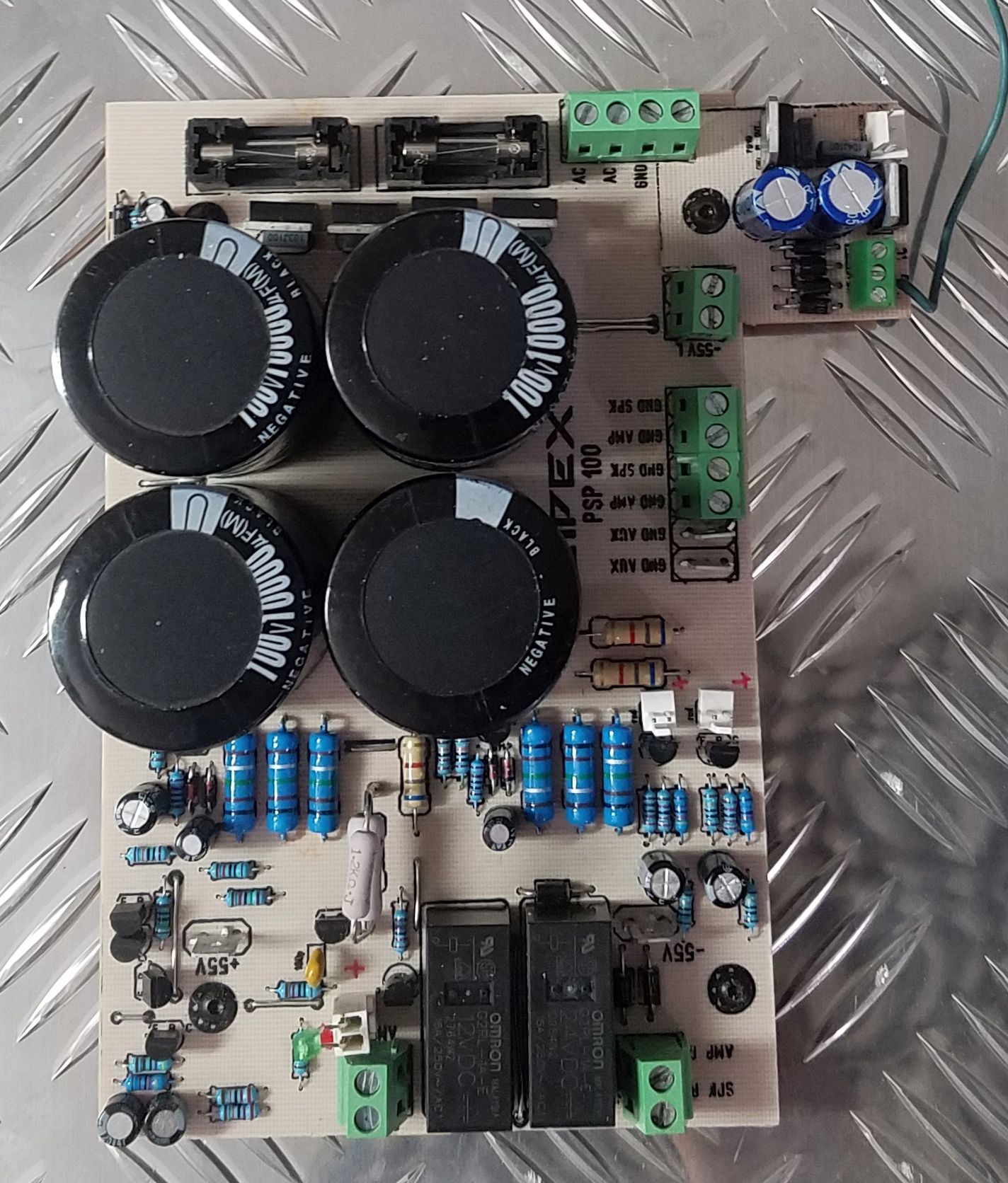

I took your advice and built the PSP 100 PSU. I had to make a little daughter board to output +-15V for the XLR pre's. Here are some pics of it installed.

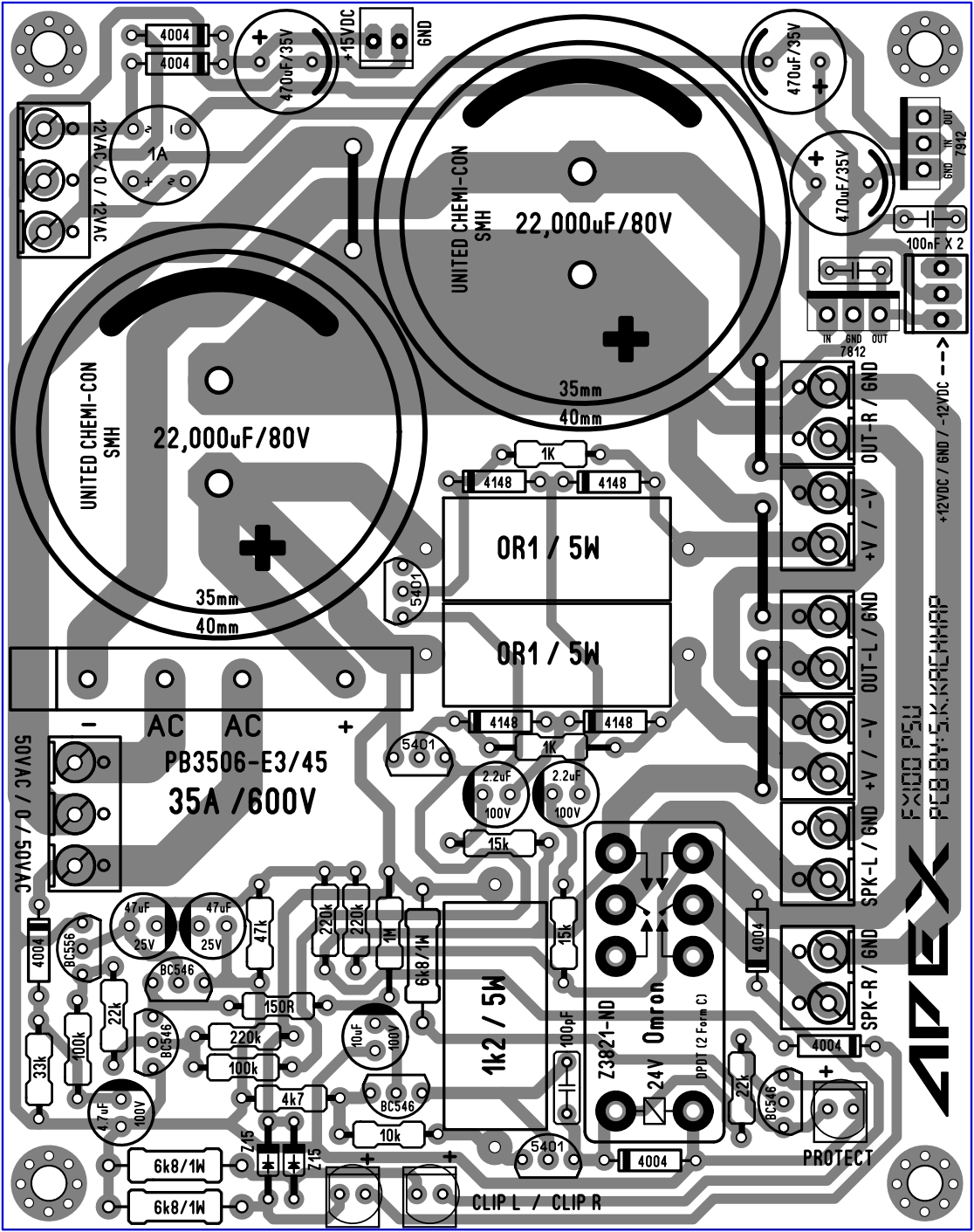

By the way, the protect LED is inverted in the file you shared in the post above.
I did a bit of a redraw to be able to use some euro blocks instead of all spade connectors.

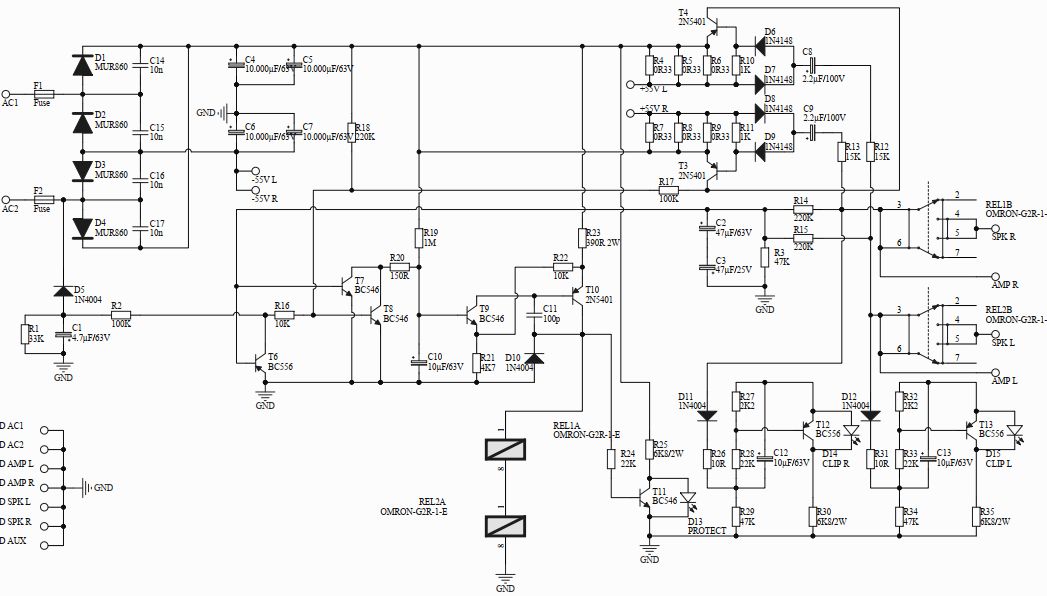

I hope you are still monitoring this thread. With this PSP100 PSU the clipping circuit is a little too sensitive. The LEDs start flickering and a pretty low volume. They act more like VU lights than clip indicators. Are there some changes I can make so they don't flicker until clipping occurs?
Also, I was out of 0R33 2W resistors so I used 0R15. May I assume that these will affect the over-current circuit?

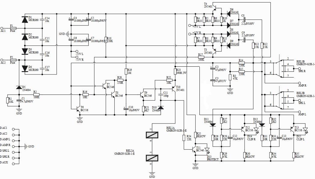

OK so now I have a question. I looked at the schematic and I have the clipping LEDs inverted. When I measure the polarity on those LEDs the positive is on the cathode. Does it reverse the polarity at some point?
Sure.output signal changes polarity... can you post schematic?
Schematic corected.

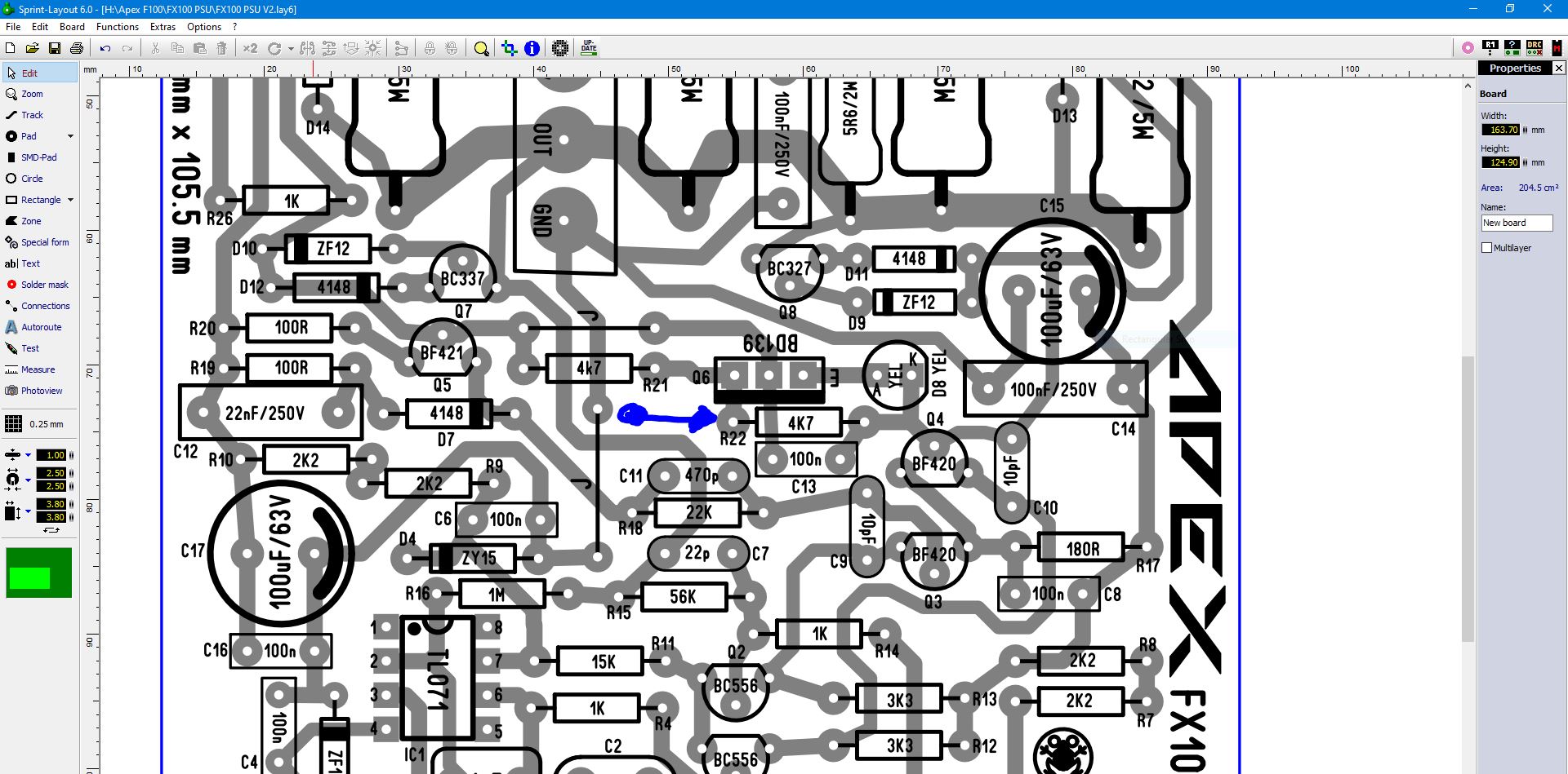

Apex FX100 R22 to trim pot adjustment value
hi guys is been so long I'm just checking my Sprint file collection and I don't remember if this R22 was change by a pot and what value it was? also is this PSU good to go no changes? looks good 🙂
