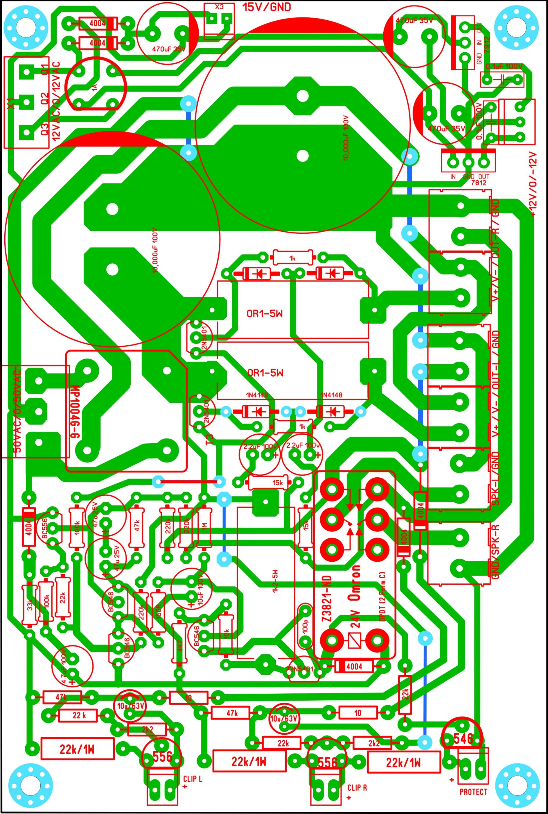

I looked at the board layout and there is a distinct lack of star grounding, so that the high currents from the rail decoupling capacitors get injected into small signal ground - that's probably enough to risk oscillation.
This is made worse by the ground trace being pretty thin and split two-ways, rather than flood-filled plane - most of the top side is unused and could be used for decent ground.
Dear Mark, this pcb ( one of my first) was done with some inputs, read back. input ground is separate.
This is an old styled DIY pcb with no provision for top layer but for jumpers🙂. Anyone with copper clad and few parts in his bin can build this.

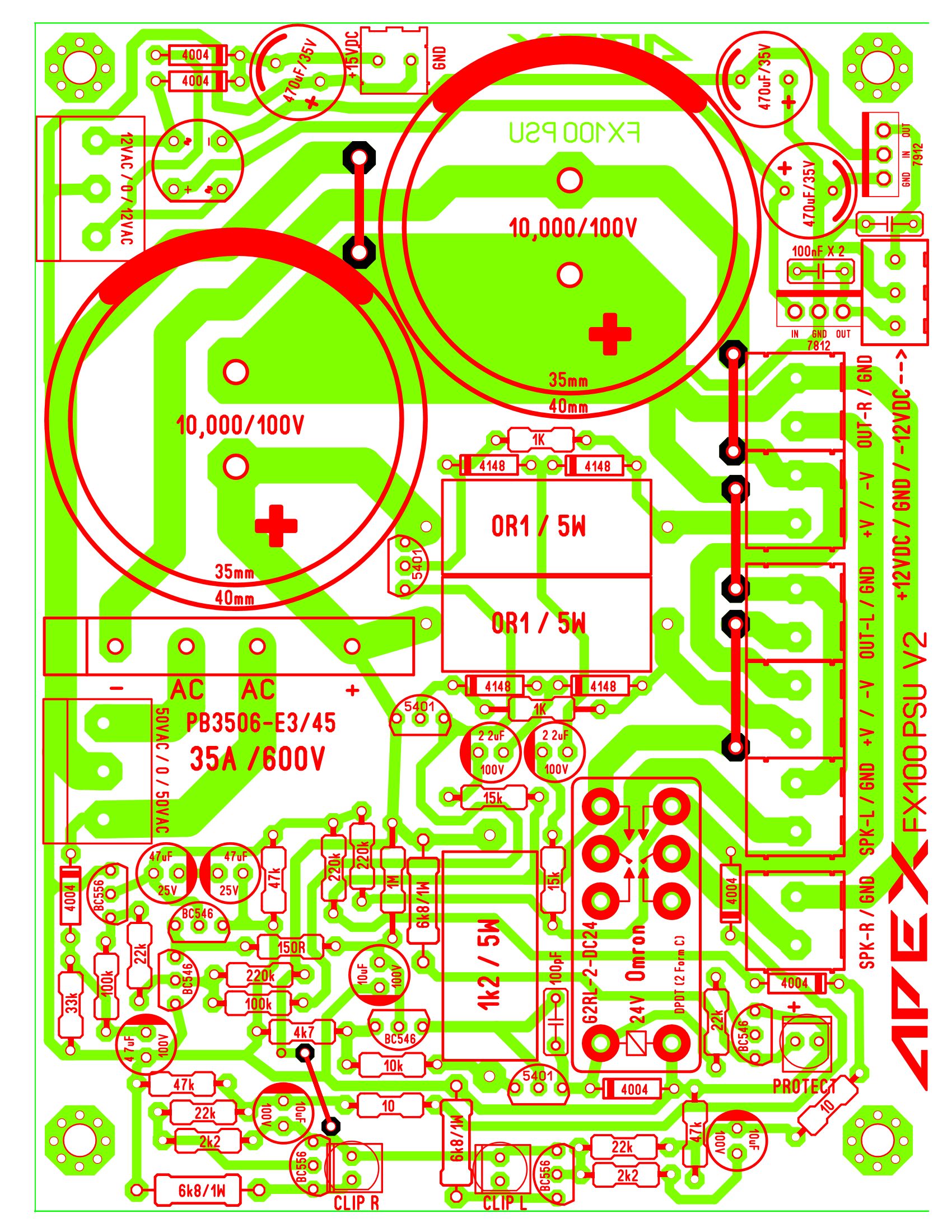

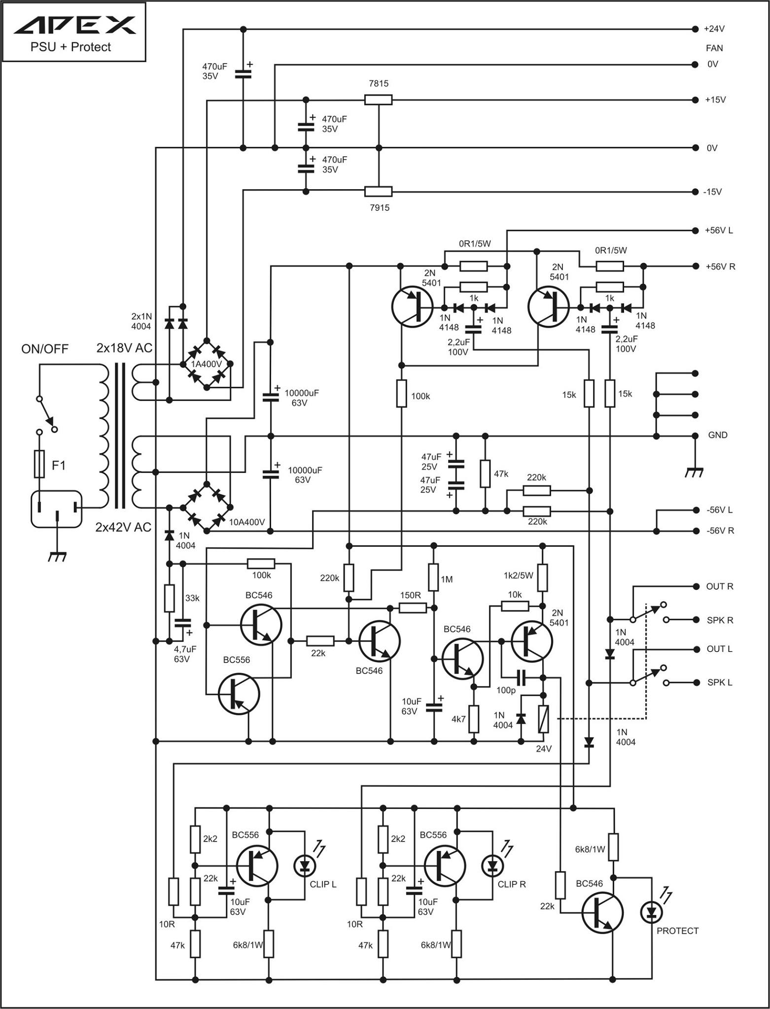

Hi Prasi,
The PSU I used is the original FX100 PSU. It has clip LED's built into the circuit. I tried to use them but every time I drove the amp hard enough to make it clip it blew the LED. I thought I had wired it wrong initially but after 4 LED's I realized it is hitting them too hard.
