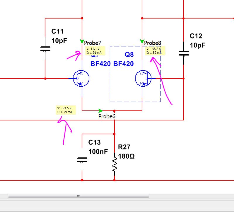

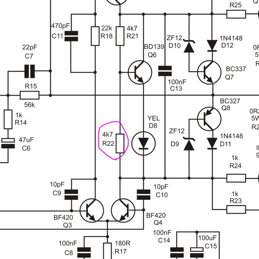

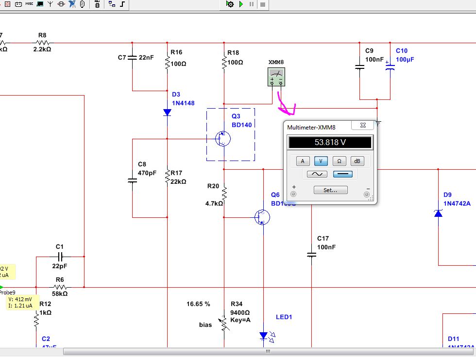

Hello Terry
I think it might not hurt to change them to the ones you want, the thing that change is the leads position, also I think I read here that BD139 can be placed on the main larger heat sink then adjust R22 bias on my simulation respond really well at 1.5K it does lower the THD and respond really well in my diy opinion really nicely but R22 do not lower the value too much because it begins to drain more current from the rails supply 🙂 been mosfet they act as vampires if you provoke them jejejejejejeje 😛
BF420 EBC VCEO 300V
KSC1845 ECB VCEO 120V

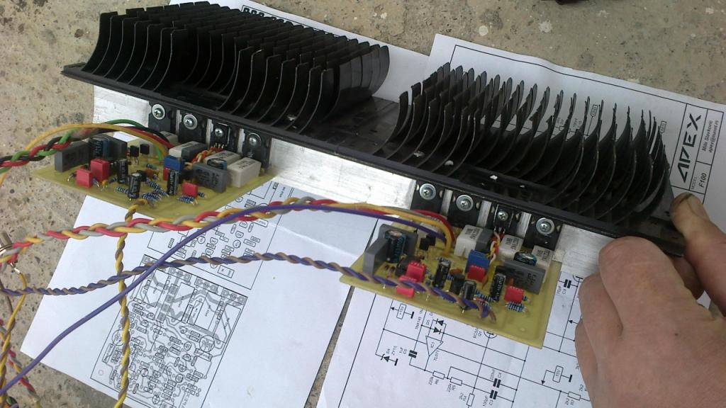

It is singing. I used the KSA992/C1845 in place of BF420/421 and BC550/560 in place of BC327/337. I also installed a 10K trimmer in place of the 4k7 resistor. I have the bias set to 50mA. It runs a little hot with the music turned up. Probably be wise to mount them on separate heatsinks but this is fine for testing.Square waves look good and it clips nice.
Be sure if you build this that you use BC556 fpr the LTP. I used BC546 initially because that was the label on the schematic but it was in error. They are PNP so must be BC556.
Blessings, Terry

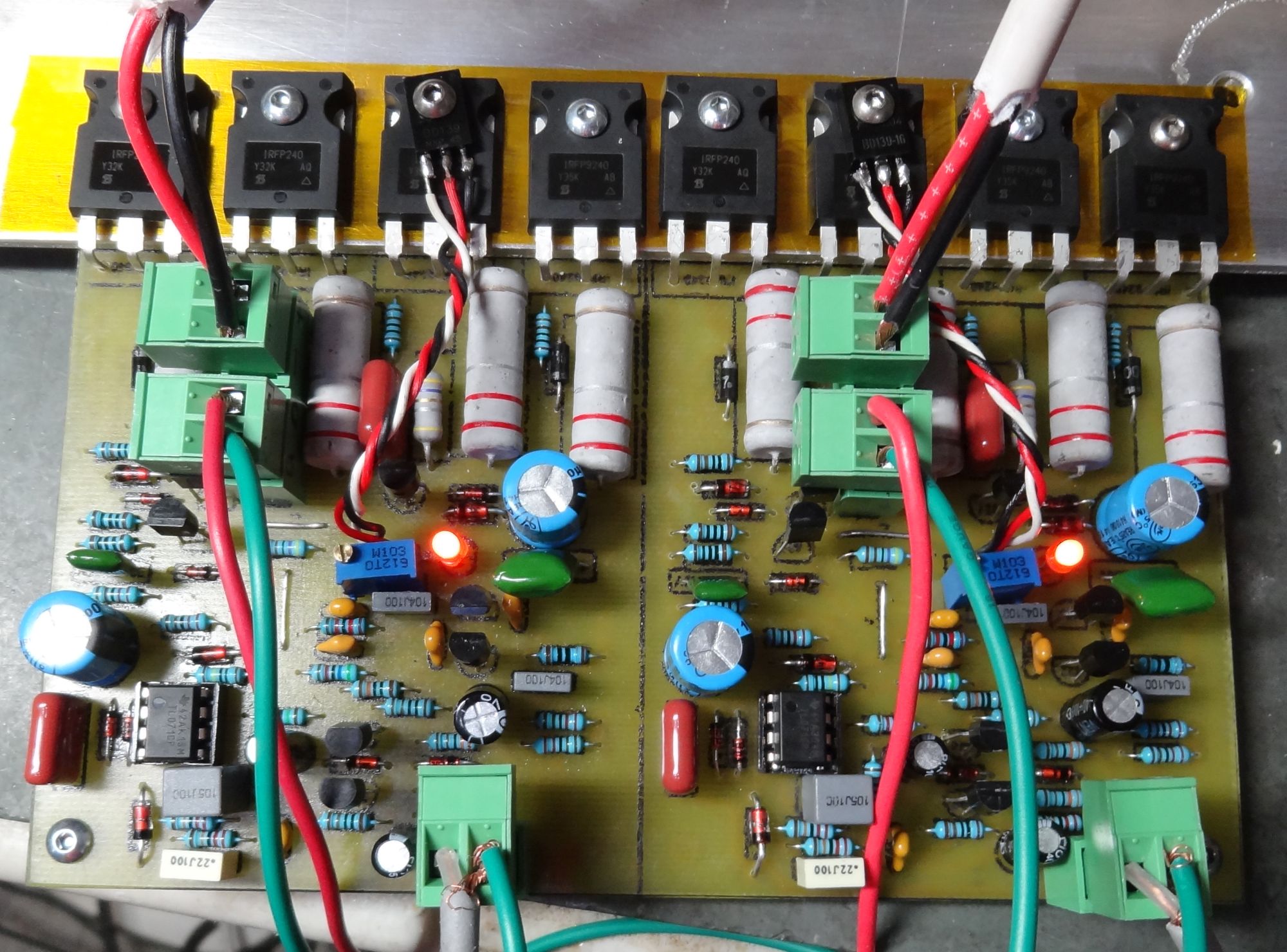

this is my F100. now it has 300VA toroidal transformer and 10000+4700uF+1000uF per rail in power supply.
i tried it with smps,than with same torodial transformer and two "jars" but it lost it´s mid´s and hi tones. than i tried a solution big+medium+small uF in PSU and i have brougt back it´s mid and hi tones.
it has a lot of power,and it should have at least 500VA transformer to really hear what it can give.
anyway,even with this 300VA transformer it has more than enough power for listening in a living room.
i also transformed it from b-class to ab-class (multiturn instead 4k7) and it has about 80mA per pair (160mA in total for one channel). BD transistor is mounted over one output mosfet,connected to a PCB over triplet and that works good.
it is really pleasant amplifier to listen,with a lot of power,made by "easy" parts.

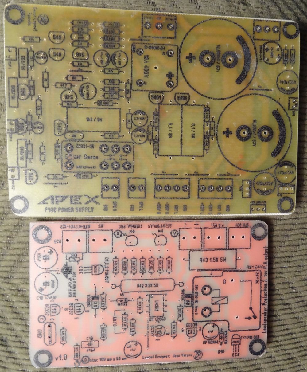

God job! So far I have only tested it with a small PSU. +- 40vdc 300VA 6X4700uF. Sounds really good and plenty loud for indoor listening. I suppose if you want to use it in a club a bigger PSU would be warranted. I couldn't tell what frequencies your were testing with on your youtube video but they looked similar to what I see. Very square up to 20khz. 50khz starts getting rounded but that of course is way above human hearing.
I just etched the PSU and protection boards so I will try this PSU once I have it completed

Terry i can't understand , isn't a good practice using two relays in signal path.
You must use either the protected power supply or the protection circuit.
Hi Thimios,
I don't plan to use both on the same amp. I just intend to build them. As usual I am just hoping to learn something. I have a few protection boards built including Valery's 21 century board. If I use one of these it will probably be the one that is PSU/protect combo board. One of these days I am going to have to stop soldering and build some cases. I don't know how I will ever decide which amps to use. I have a huge stack of awesome amps now.
Blessings, Terry

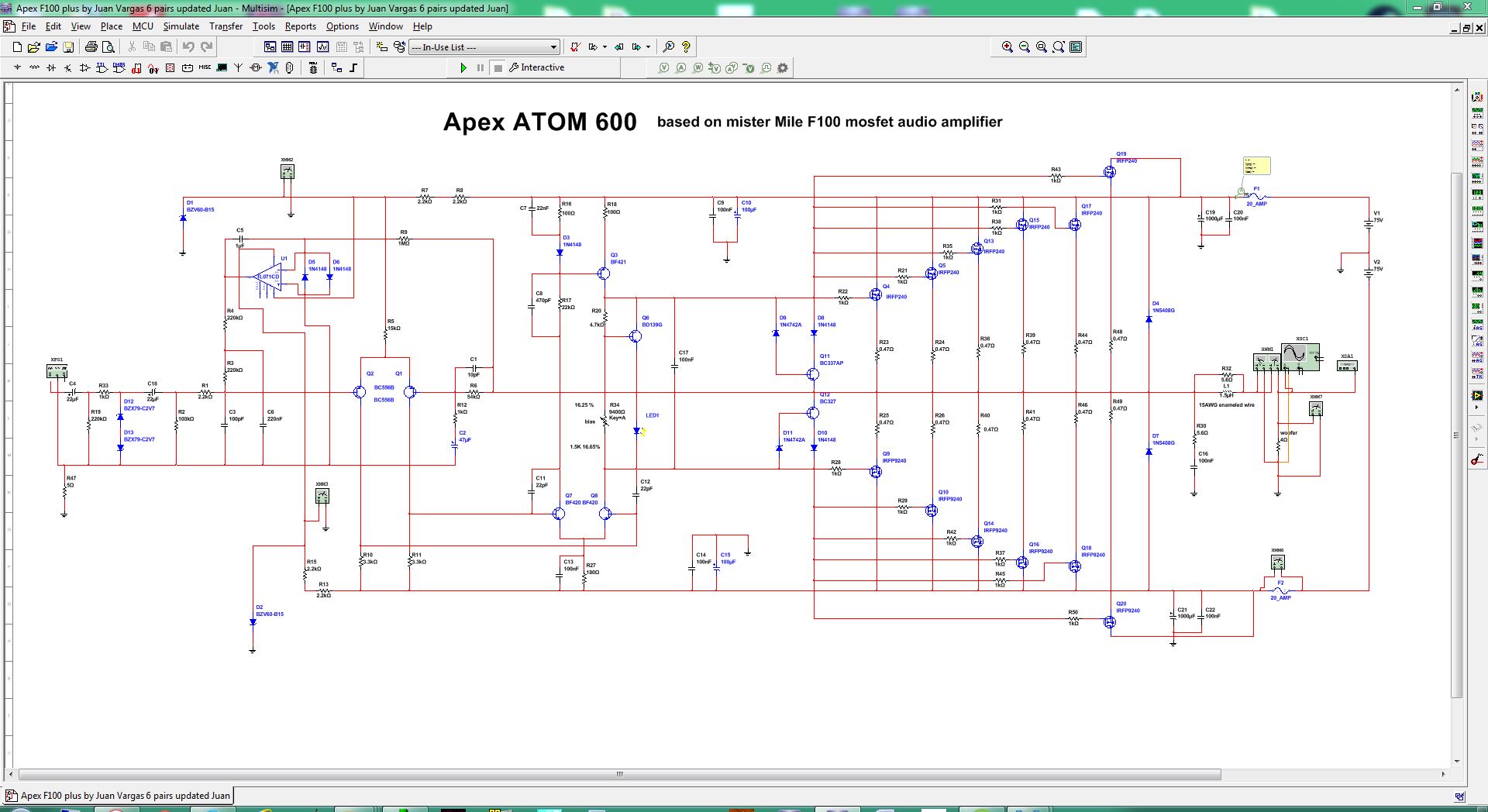

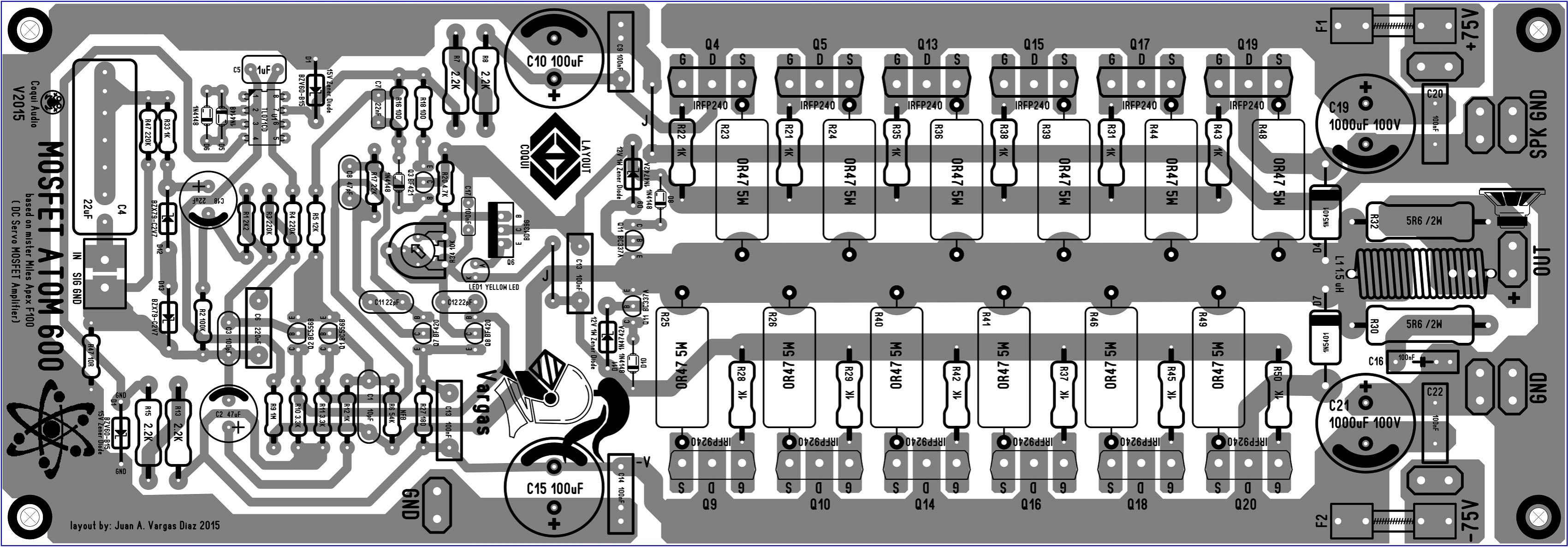

Hello mister Mile
I have this crazy idea of adding more pair mosfet for the F100 so far I simulated as it is with original schematic, " I know is not accurate because is software simulation"
do I need to do any further modifications to able to use 6 pairs of mosfet ?
don't mind about the name Atom it will be always be F100 just with more pairs 🙂 ATOM 600 is just to identified my crazy ideas 😛
The PCB is not completed yet I still hunting for errors = erratas
Regards
