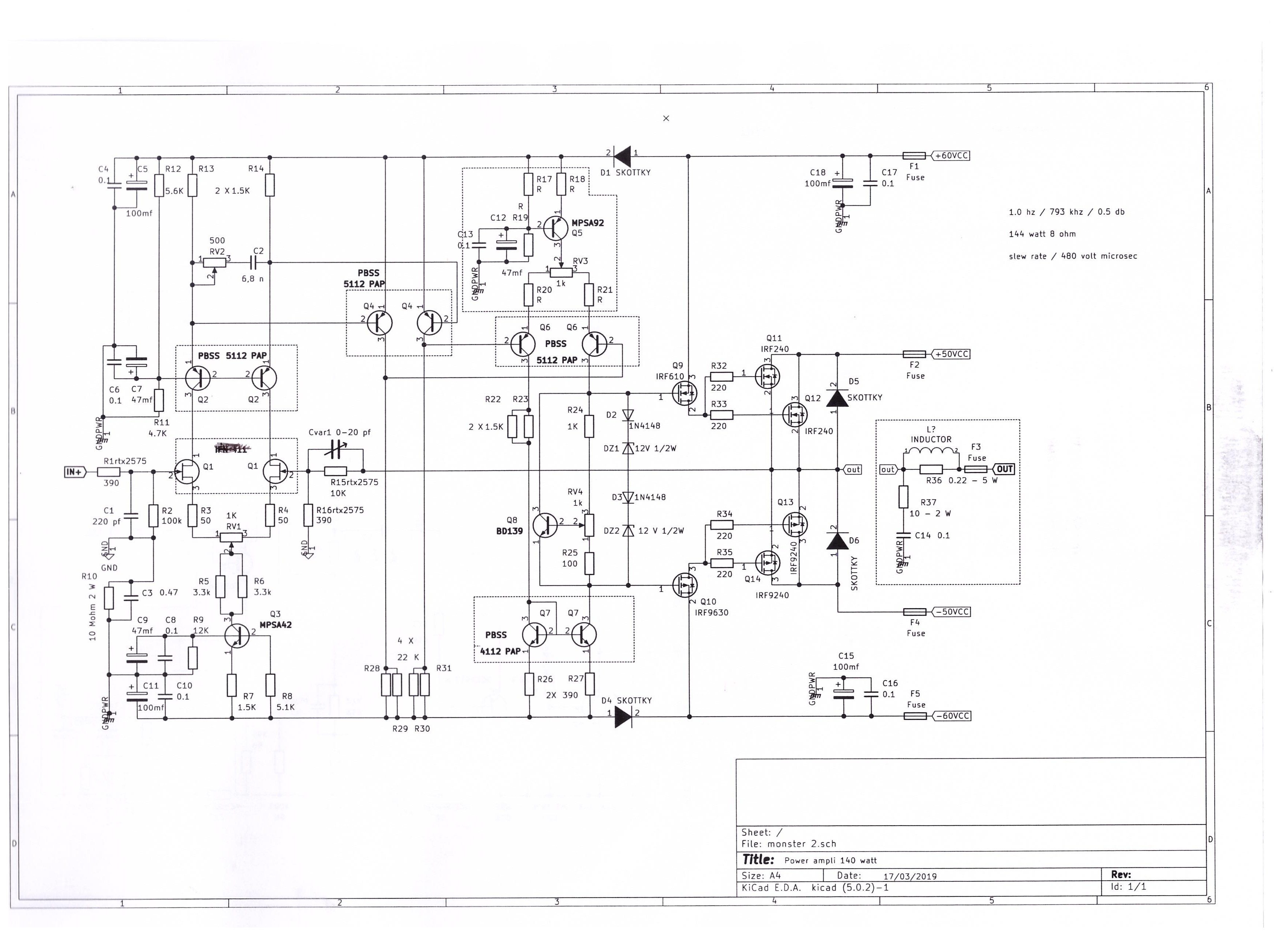

Someone re-engineered the 458 and he came up with this.
Taking into account the particular method of reverse engineering we can expect a reasonable interpretation, but not a true facsimile. Still, it appears pretty convincing.
There is one particular area which baffles me. The +-5v separate supply for the CCS and the offset compensation. Apparently the sole reason for this additional PS is to reduce the power-on thump. Seems very unlikely the original was designed this way; a separate PS for the entire front end (VAS in this case) would make much more sense.
Any thoughts?

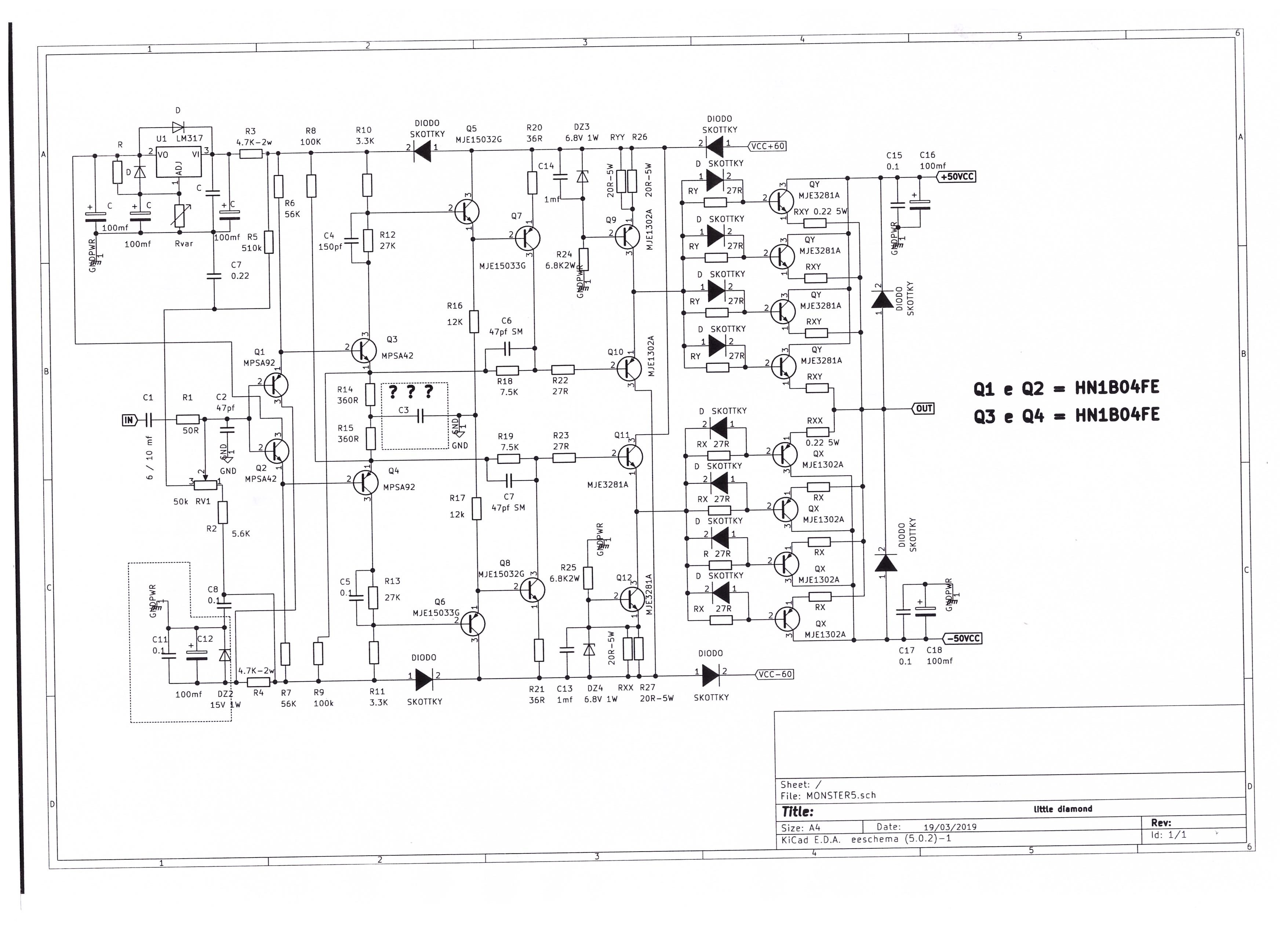

this is a revised scheme so that I define excellent.
I think that the input stage with the 2 bjt Q1 and Q2, channel P and N, separated only leads to problems.
idem Q3 and Q4.
I believe that in 2019 there are excellent products to overcome these strange and archaic audiophile habits of testing semiconductors when there are those who do it, and better, at the level of multinationals.
in any case this scheme sounds, in my humble opinion, in an interesting, very interesting way.
very important is the entry cap that colors or not the final result.
low and dynamic range, unfortunately, not exceptional, the rest is very interesting.
In the scheme there are two choices:
the input stage power supply, with zener, simple, and with LM 317, more complicated, but preferable: everyone can choose whether zener is for VCC + or -
or with 317 and 337
NB
ERROR
C 4 = C 5 = 150 picofarad , pardon🙂

if instead you want a totally coupled DC power amp, without any compensation, very fast, dynamic and with a first-class low range, here is an ad hoc scheme:
a revisiting of Goldmund, Norma and Spectral, all derived or copied from the Hitachi book, just revised and adjusted by each, but nothing unnatural:
this scheme revises and adjusts for the year 2019, the 3 derived from the Hitachi book and adds something from Otala, not bad

pardon , R 2 = R 6 = 510 Kohm
it seems that it does not affect.
I could say that I listened to the stabilizer with the zener and with the 317, but I would say a nonsense to which nobody would believe 😀 .
317 or 7815 especially to avoid the zener that I just can't stand
the PCB gets messed up, though

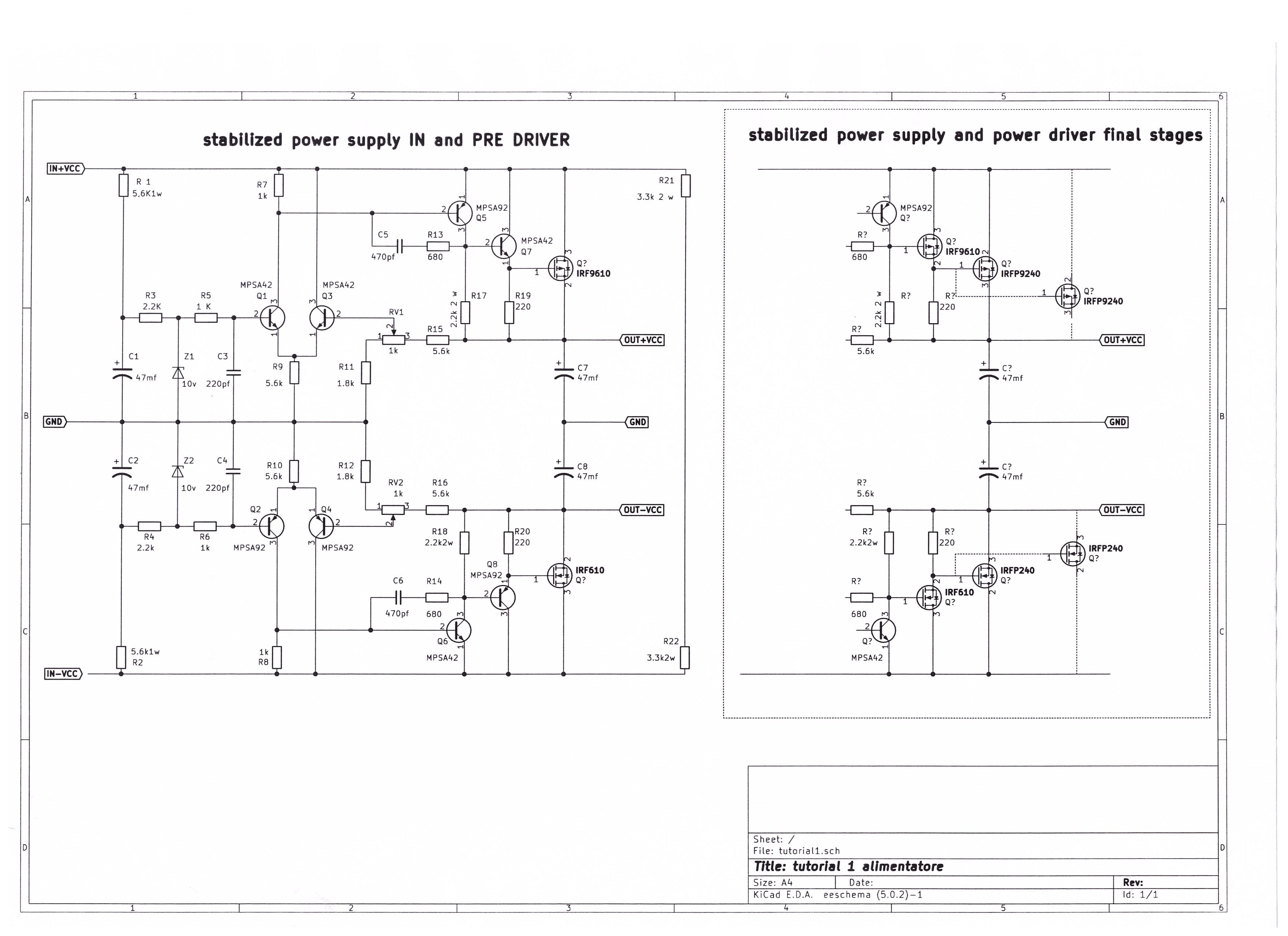

I use this stabilizer, good enough for all occasions
derives from the Naim R, but has been modified to use the N and P driver mosfets and power discarded in the selection from the Goldmund / Norma / Spectral scheme

the stabilized power supply of IN and DRIVER provides the Skottky diode downstream of the drivers and pre-drivers before the IN power supplies with the two chips because Q 9, 10, 11, 12 are final power transistors equal to the final ones, they heat and must polarize and pilot the finals of the power amplifiers WELL.
The different absorption I always fear may create problems at the delicate entry stage with those chips.
you could eliminate the diode just before the drivers, but, I wouldn't know whether to delete it or put it changes something, I admit
The diodes between power supply and output antiilektregertikes forces protect the speakers.
The between powering the final power stage and output
antiilektregertikes forces protect the loudspeakers.
