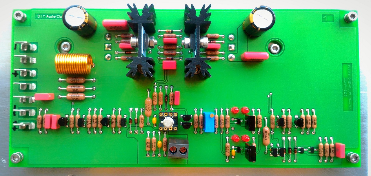

in series with the power supply there is a resistance of 5 watts, then restoring with the zener and then finally using the 317, less noise etc etc
the first 4 transistors are crucial for the amplifier, so they must have a very high-performance network
the offset varies from 15 to 26 mv
the BCM53DS chip for Q 1, 2, 3 and 4, two chips, manages to minimize the offset and makes everything very easy

I bought the Chinese card, but had several problems
the transistors are not matched and with a scheme this is a problem
so better to think of matcharseli alone and everything will be fine

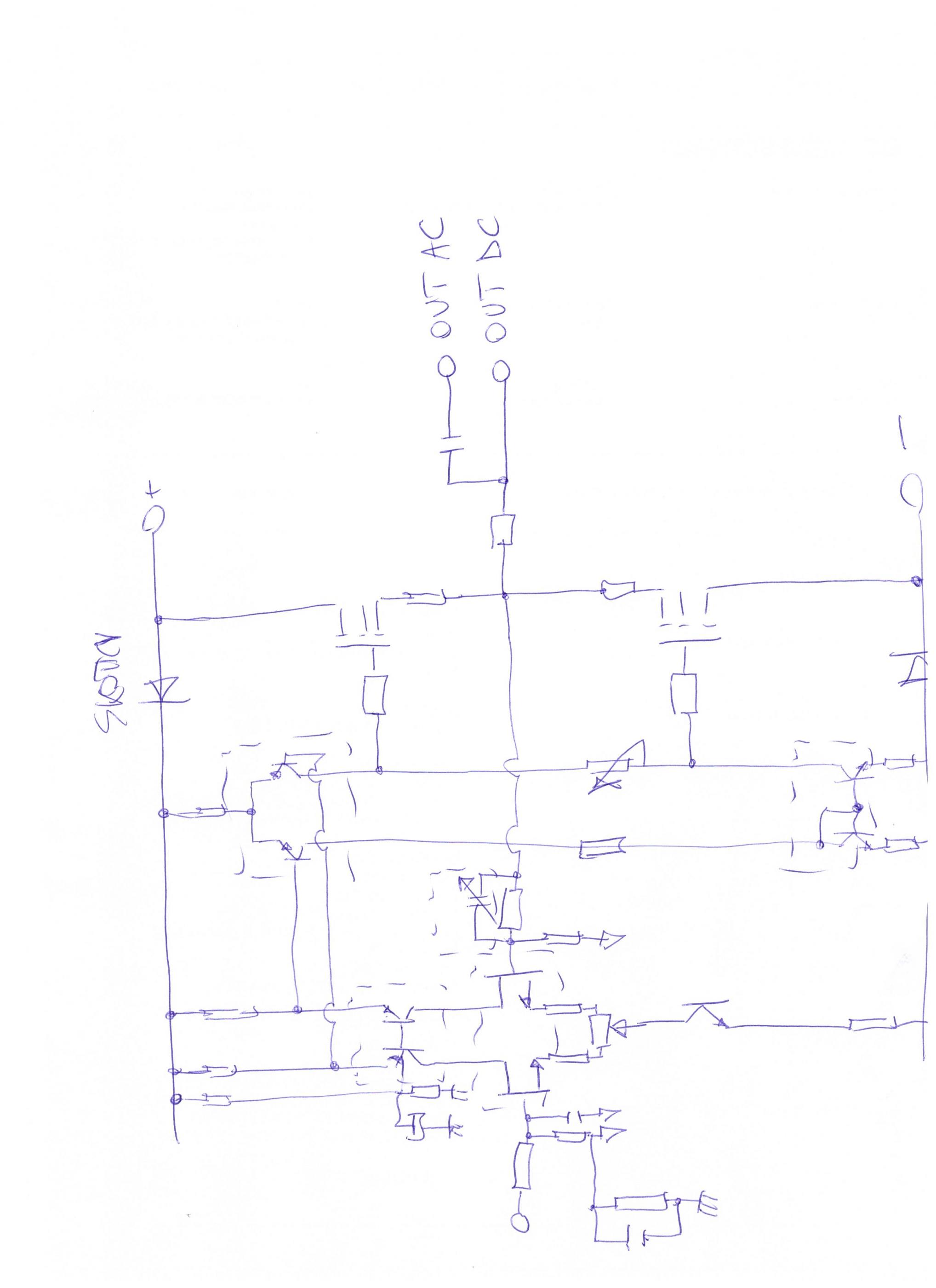

my interventions lead away from the original project or scheme that cannot be discussed, I think.
but a DIY can do whatever it wants.
do as I did leads to very interesting results and ask several questions
The input stage, which has always been very important, TODAY, 2019, in my humble opinion, cannot be managed by a selection using the curved track, provided that the selection was such and not even with a tester
Today, 2019, there are super chips with BJT matched on an industrial level: what we want to talk about!

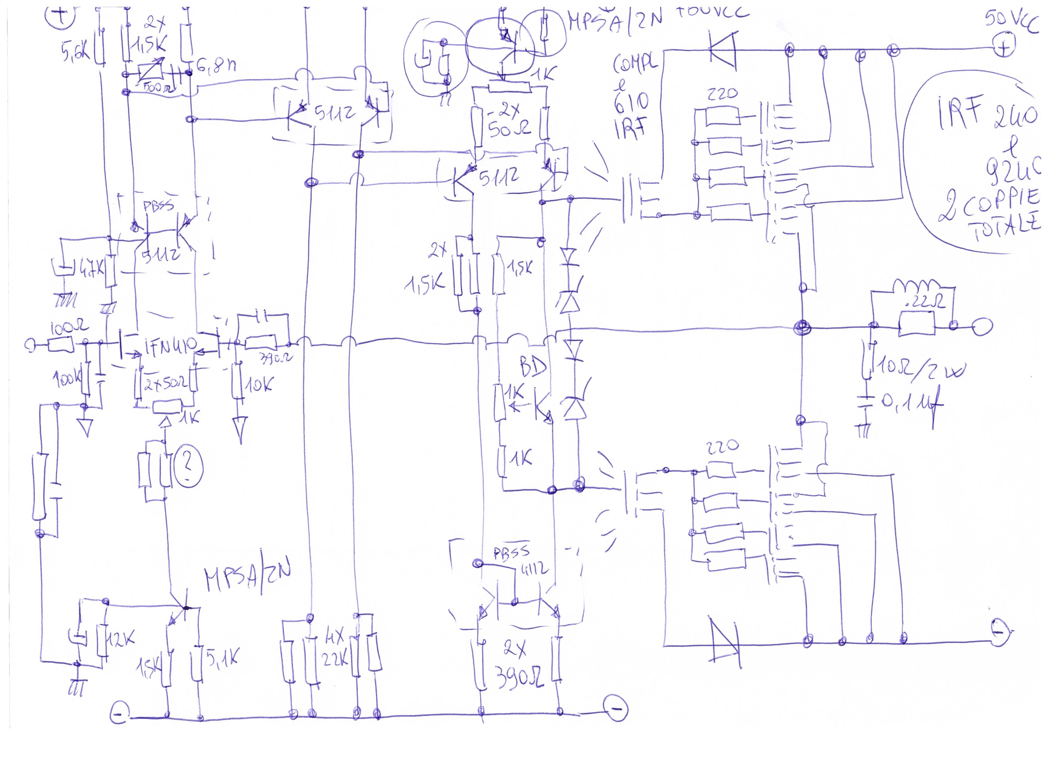

the other scheme that I posted, derived from a Hitachi application notes, from which Spectral, Goldmund and Norma are born, also benefits from the use of these modern chips, again if we DIY want to understand that some BJT chips match the difference
the basic problems of an open loop final remain, but it sounds very good
it is clear that we can not expect a bass and a dynamics and speed like this scheme,
but voices and high range are relevant

Buying the Chinese card hoping that it will come close to the original is there, but it must be revised as best as possible (absolute BJT selection) also to preserve all the limitations that characterize the original.

also the other scheme I posted is superior to both Goldmund and Norma and also to Spectral.
Superior both technically and listening, in all the parameters dear to audiophiles.
is a scheme derived from Hitachi, just like the other 3.
Spectral comes from Hitachi, Goldmund as well, and Norma comes from Spectral, anyone sees it.
Goldmund has drivers in TO 92, in my opinion an error, Spectral and Norma in TO 220.
All three have the same identical and well-made entry stage.
Norma has in addition an emitter follower, at the time with the dual fetal J 109 Toshiba, now obsolete, derived from Electrocompaniet.

the Chinese card, I call it this way, goes in the direction of fascination and interpretation, like the valves, therefore with all the pros and cons of valves and open loop schemes.
my reinterpretations greatly diminish the limits of the scheme, but more than that it is impossible, except to distort it: but does it make sense?

In the other direction the second scheme goes, complete, has everything, speed, fidelity to engraving, low range, dynamics, articulation, but never could have the magic of the Chinese card that can be defined a splendid my sound.
Important is the combined final amplifiers: the Chinese card is finicky, the second scheme, instead, is a running train.
PS
to note that in the second scheme there is not a single compensation, not bad, indeed

with the second scheme, if I use his pre, I can play by inserting a cap at the AC output and playing until you find a cap that you like, but we're in my total sound

this too I consider it a very good pre.
sturdy, simple, reliable, performing, well-sounding
The 2 AD and DC outputs allow, the AC one, an excellent my sound

Your schematic look like my project. It same as your topology. BW is about 3MHz (-3dB), slew rate some where above 250V/uS.
Input by Siliconix 2N5565, output by Semelab ECW20N20/20P20.
