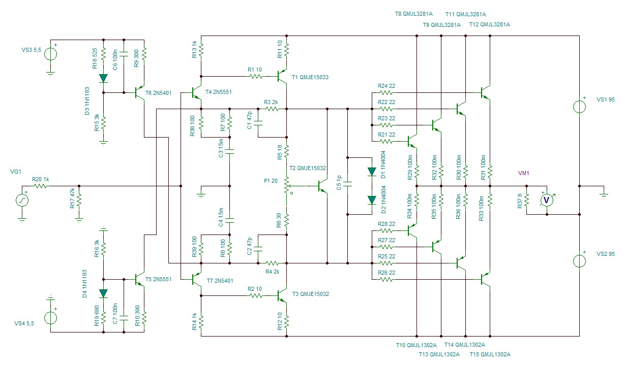

Dartzeel amp schematic - build this?

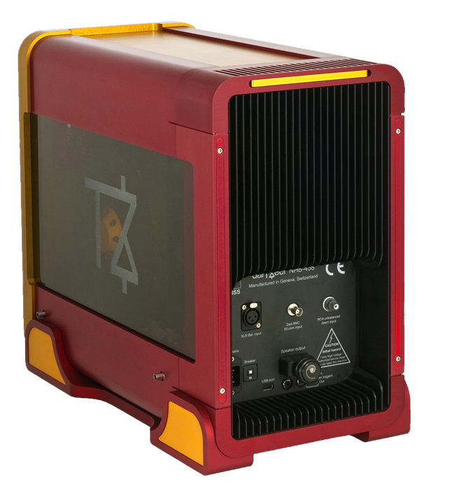

Most certainly it is not. A silly servo, sound-degrading output relays...it is just a misuse of the 108 circuit. Besides, the 458 does not use the array of To220s but just 3 per channel.
Someone re-engineered the 458 and he came up with this.
At first, he just wanted to test it but he got a very positive result so he made a decent enclosure for it and he uses it as his main amp next to a very high-quality DIY hybrid amp.
Second picture the original 458 (not DIY)

I know. It's old news. Looking at the factory movie his circuit is probably accurate, but until someone disassembles his amp there is no way to be 100% certain. As the 108mk2 is supposed to follow the same topology with a single o/p pair and readjusted op points for the lower supply voltage i have been meaning to try it out in place of my 108 clone. Very interesting that it is bye - bye diamond. Perhaps the circuit is now even more stable and certainly having a different distortion spectrum. Owners who have upgraded all tend to be ecstatic, but of course this is meaningless. I have some misgivings about the huge caps decoupling the nfb, but to be fair, for an expensive production amp it is highly irresponsible to rely on the end user adjusting constantly the offset.

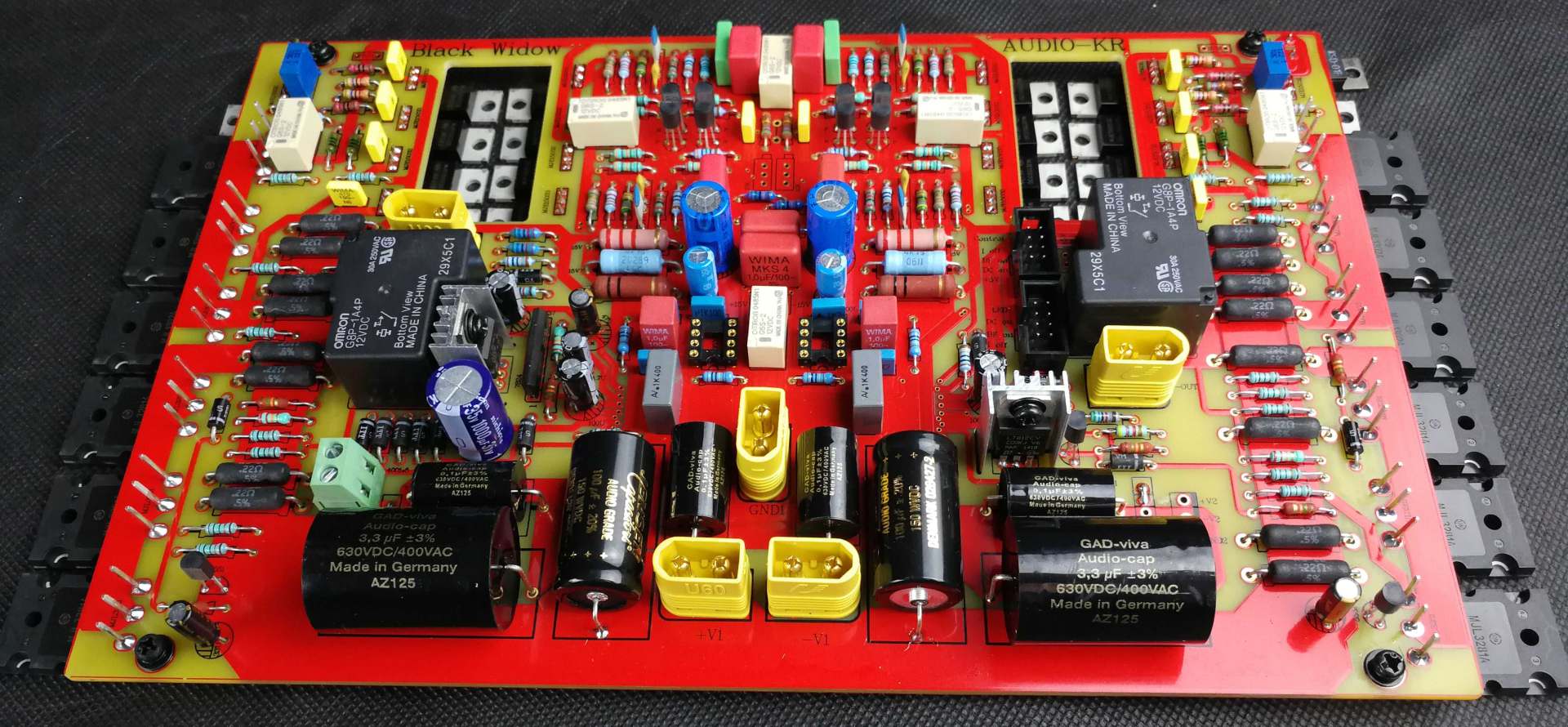

A four pair amp looks great as an idea, but where can we find the pcb's? I've done a search on ebay and haven't found anything.
the pcb does not exist.
I bought the Chinese pcb with the single pair and I reviewed the scheme
added 3 pairs, changed the polarizations, some capacitors, changed MJE drivers
at the 4 pairs an emitter resistance of 0.22 ohm 5 watts has been placed and everything is wired wired , with an aluminum bar that fixes the 4 couples to the heatsink
changed the entry capacitor and put a cap of 22 millifarad, bypassed, to ground between R 9 and 10
VCC of 60 VDC drivers, 50 VDC finals

Hi Misters,
I would like to built one but don't know witch one... what are your recommendations between these two types selling on aliexpress :cheapest one with black pcb and 2 pairs of MJE15034/MJE15035 or the one green pcb and one pair of MJL1302 / 3281?
I think later to explore I could add two output transistors and supercap for exemple.
Many thanks for your experience.
I bought the Chinese card, but had several problems
the transistors are not matched and with a scheme this is a problem
so better to think of matcharseli alone and everything will be fine
I have changed the board with 4 pairs of final transistors per channel
changed Z1 and Z 2
changed R 19 and R 20
changed the drivers for Q 8, 10, 90 and 100
eliminated Z 5 and Z 6: powered input stages with 317 power supply in cascade to the driver's stabilized power supply (60 VDC)
changed Q 1, 2, 3 and 4 with BCM53DS
inserted scottky diodes on the VCC driver and input, after the drivers and before Q 1, 2, 3 and 4
