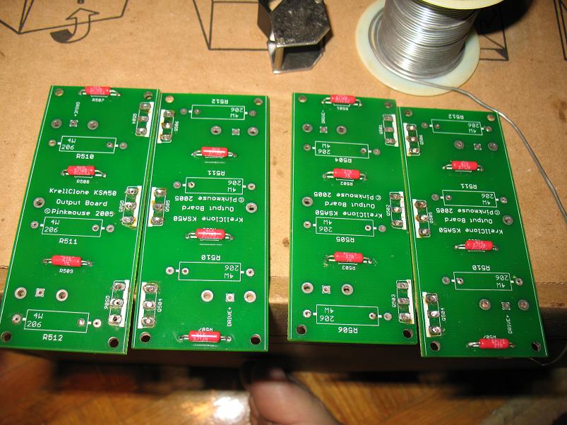

I am almost finished to populate my PC boards.
I have a couple of question

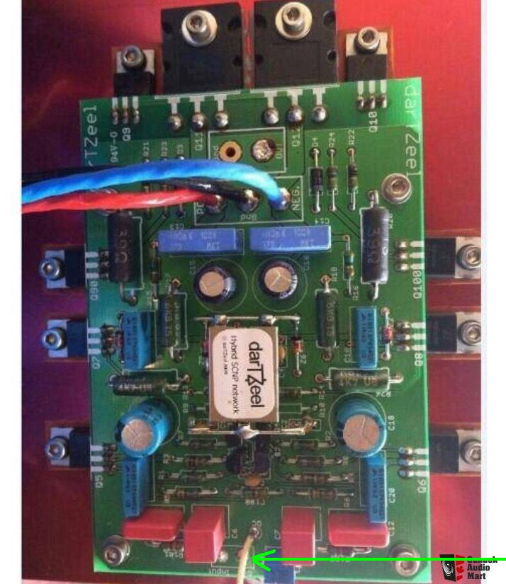

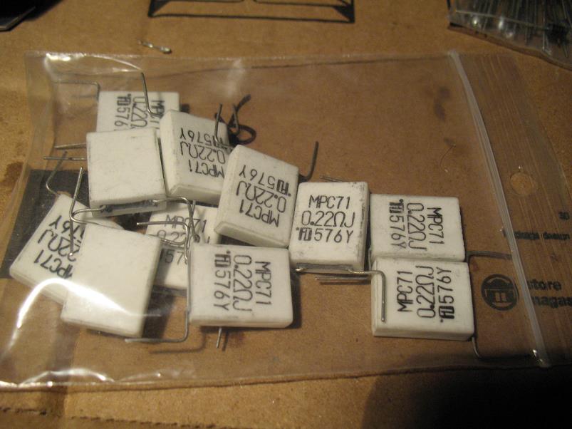

The emitter resistor value 0.22R acceptable or too low. The reason I ask people tend to use higher values like 0.5R or 0.66R. I am confused because Danny advised using a lower value like 0.1 or 0.22. I already prepared the 0.22R to stuff it but I thought I will ask.
I know to simulate a circuit and used in real life can be differences but Danny made always exceptional sim work on other amps like the Alpha.
Please, someone, let me know what value should I use, I have at hand 0.22R and 0.47R. I need to be sure, that Output PC board was stuffed several times already for Krell and Aleph 4 also. If I stuff it again with the wrong value and has to be removed I can throw those boards into the garbage.
Second question where should I connect the DC wire?
Please take a look at the first picture, green arrow.
By the way, for stabilizing the amp I will use the super caps like the original.
Thank you
Speaking of the DarthZeel NHB-108 clone board, the 0.22 OHM resistors, as Danny suggests, are perfect and after initially installing the 0.5 OHM resistors I removed and replaced them.
The DC point highlighted in the first picture, I did not use it or even connect it, because it is essentially aimed at adjusting the Offset through the blue trimmer and is used in case you use the Servo DC card, alternative to the use of the Supercap that you will use.

Hi
Thank you for the answer, that helps a lot to know the amplifier works well in real life with the 0.22 emitter resistors
Now I can go on and finish the output boards.

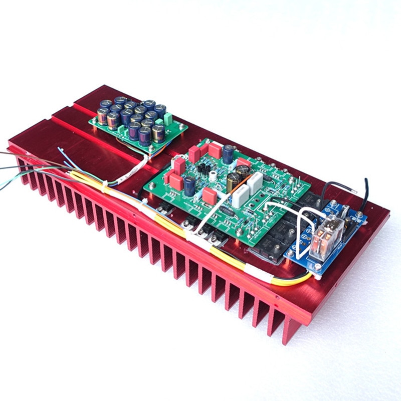

What are these extra boards for?
I wish buying stuff from Aliexpress was easier. They always have multiple version, unclear description of what you actually get and what you DON'T get.

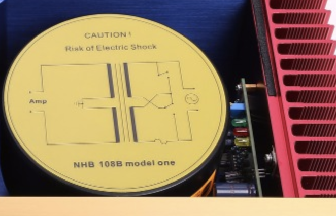

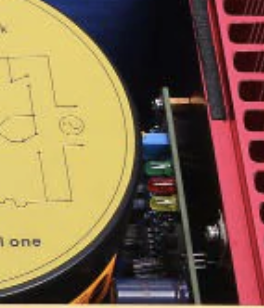

If you look att the more expensive NHB-108 listings they have a PCB next to the trafo, which basically looks like a power filter with caps. Some version have three leds (R,G,B). What are these things? Where do you get them?
Mounted on the heatsink, except the amp, you see one of these cap arrays boards and then a relay board next to the MJE13033's. That's some kind of protective circuit if you have no speakers connected I get that, but where do I buy one?
