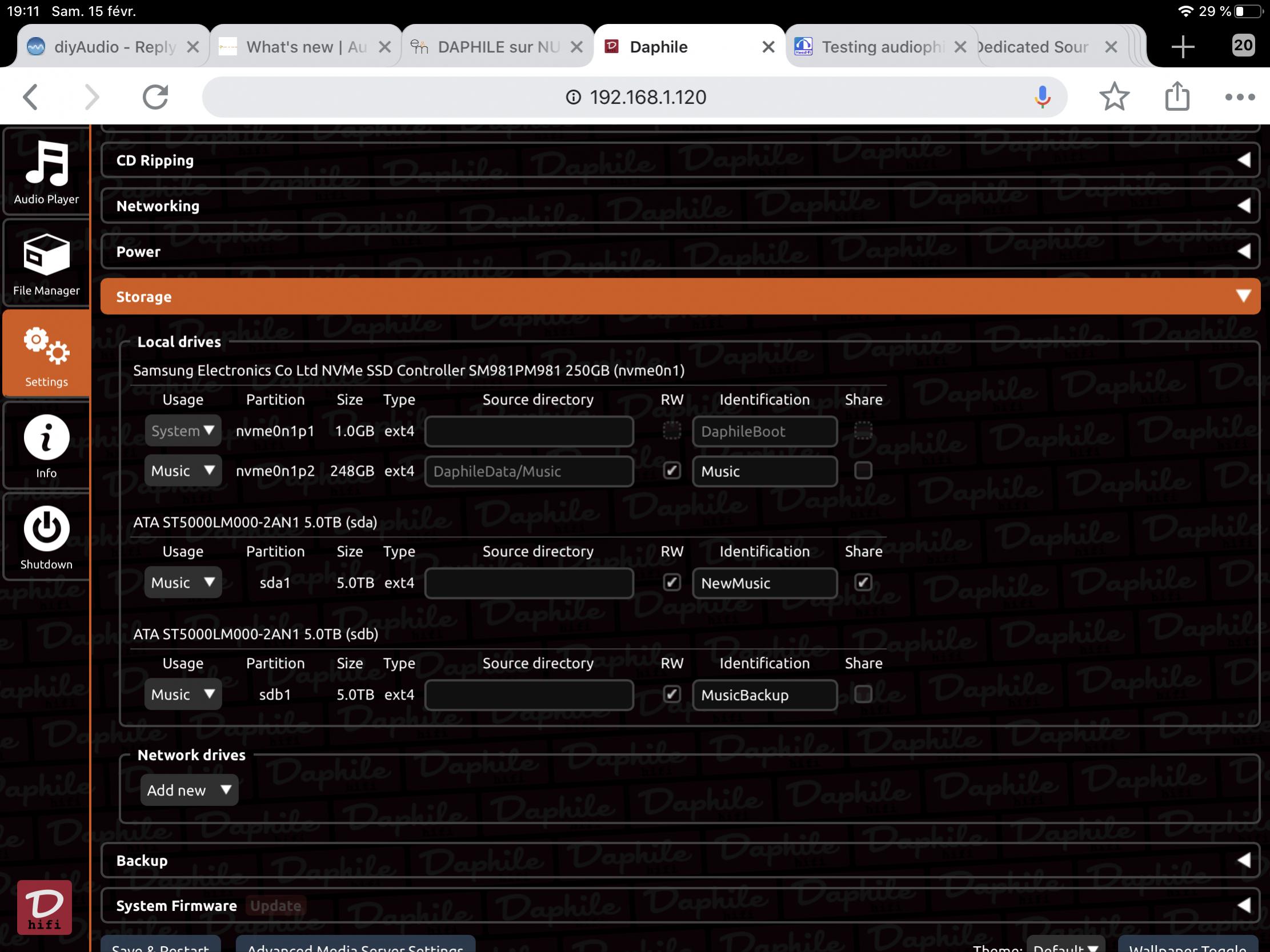

Hello gentlemen!
I use Daphile since two years and now I am trying to help a friend with his Daphile. My system uses a NAS folder for music.
My friend uses a WD HDD connected to the USP Port for music storage. Near everything is alright with the last beta 20.01 except I cannot copy files accross the LAN top the Daphile USB HDD.
In the Settings, Storage, Local Drives I have the "Share" box ticked but I cannot see it with my W10 computer.
I can the "Daphile" computer when exploring lan, but cannot see this share.
Another point, I am not sure what I have to enter in the "Source Directory" text box.
Thanks in advance for your help.

Source directory may be blank. It is in my settings.
Did you checked the RW box?

Bonjour Renaud,
Once file server is enabled:
You have to tick RW and Share on the storage part for the USB mounted partition to be able to write on the share.
You can use the share as \\daphile\<NAME> using any network drive mapping !
You will do what you want from windoas explorer or whatever.
You can also use the FileManager from the web UI to upload files ! this is not the most reliable way to do it...
My predered way is to use sftp with winscp, bitvise ssh client ... the USB drive is under media\music\USB Drives\.
Bon courage.
Addendum :
Daphile is sometime not visible in network, this will not prevent to mount the drive using net share command, the Map button, or from explorer once in network, type daphile in address bar you should see all !
daphile i.e. the daphile device name

Ok thanks, with your explanations I've understood I can drag and drop, it's working fine. Thanks a lot!
