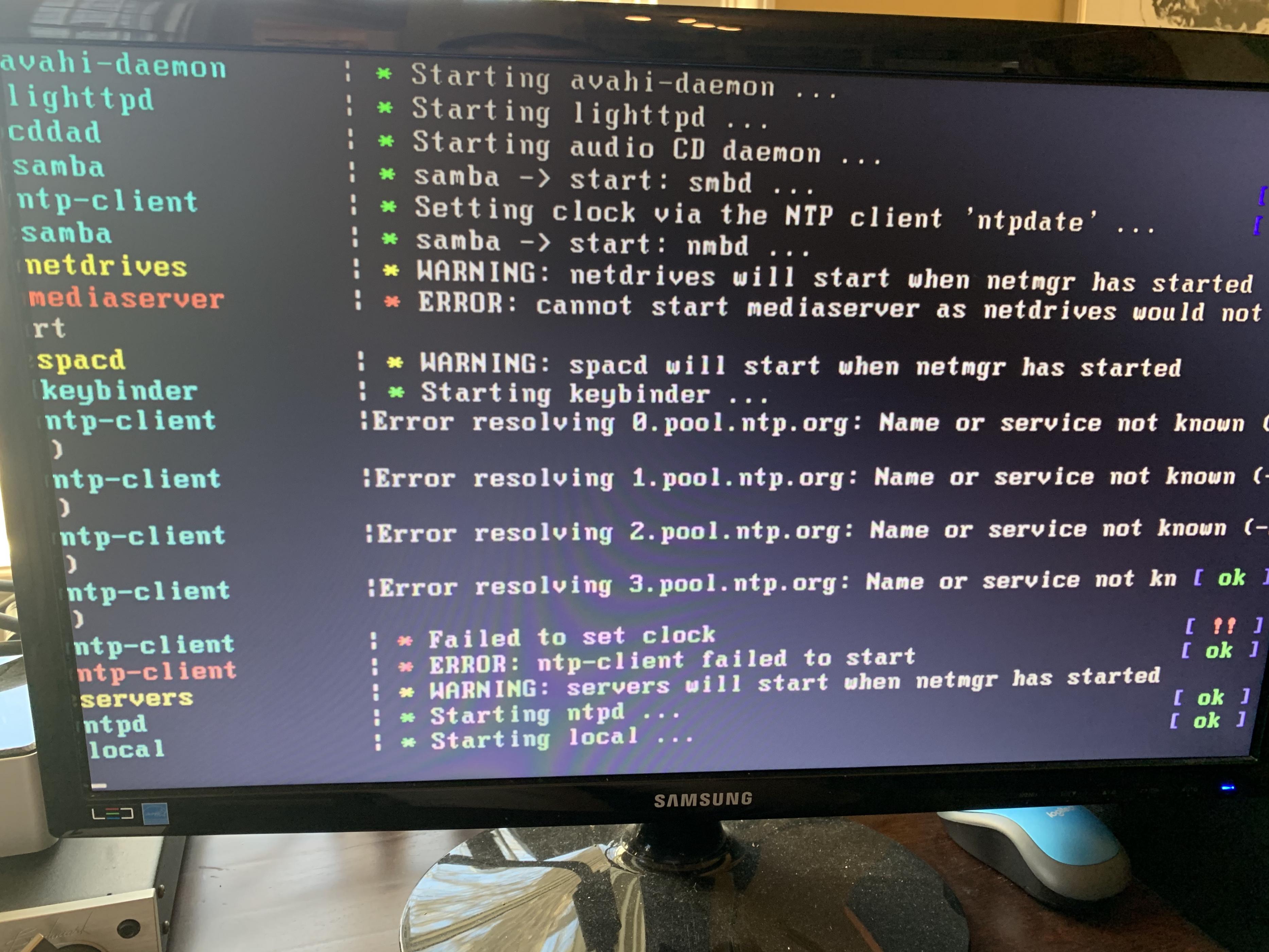

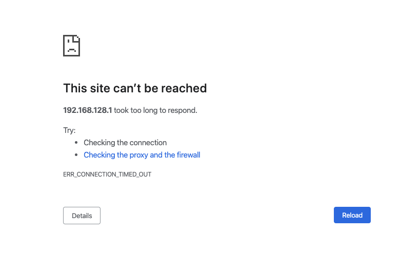

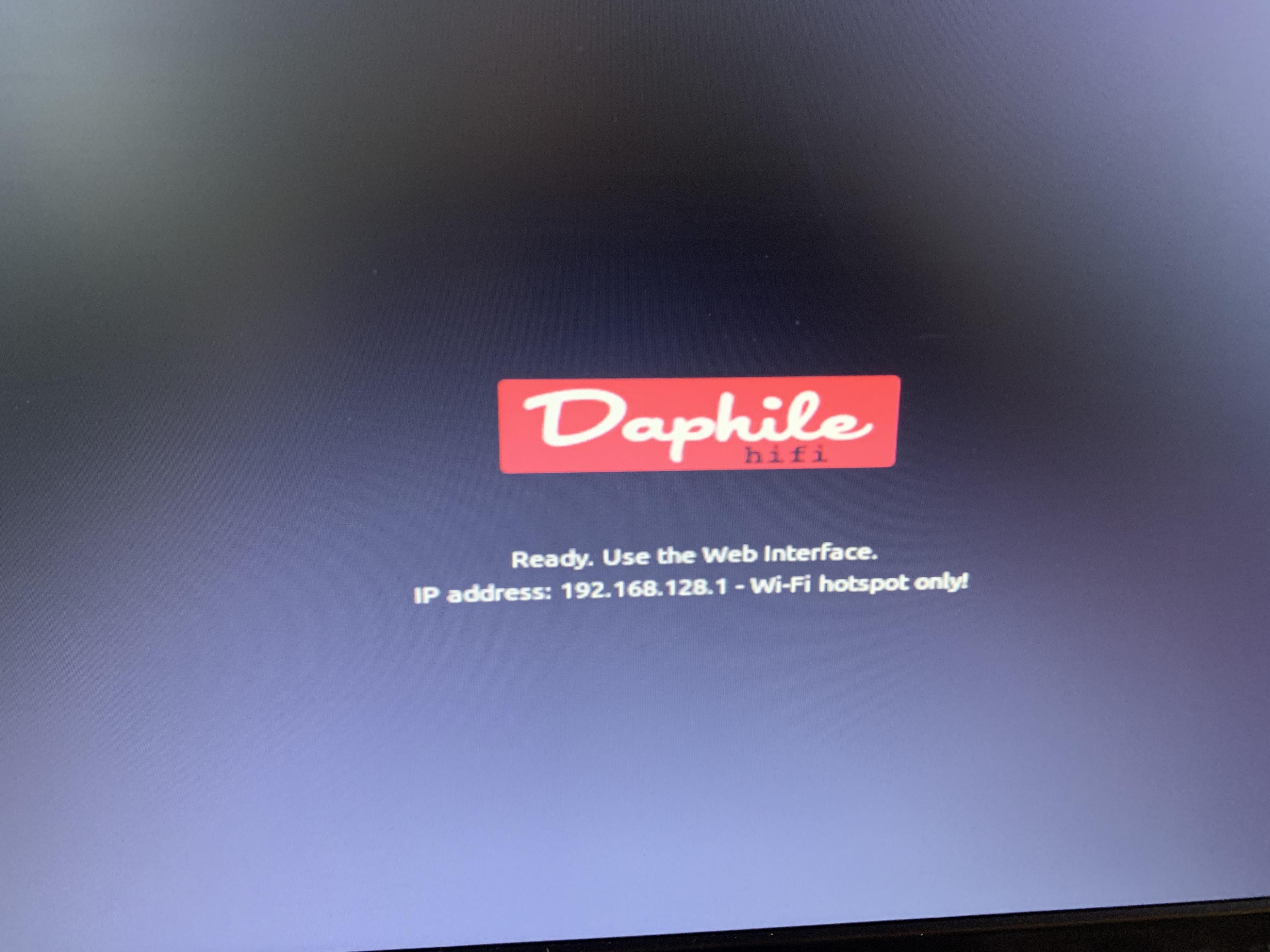

Connect a monitor and keyboard to the box and use the local GUI to change the network settings.
That is very unusual. It is initially hanging on NTP servers. Try booting from a different USB or CD.

Thank you all for your patience and helping me think through this.
It was a bad network cable. I replaced the cable and got it up and running.
Ha, sometimes, it is the simplest and most easily overlooked.It was a bad network cable.

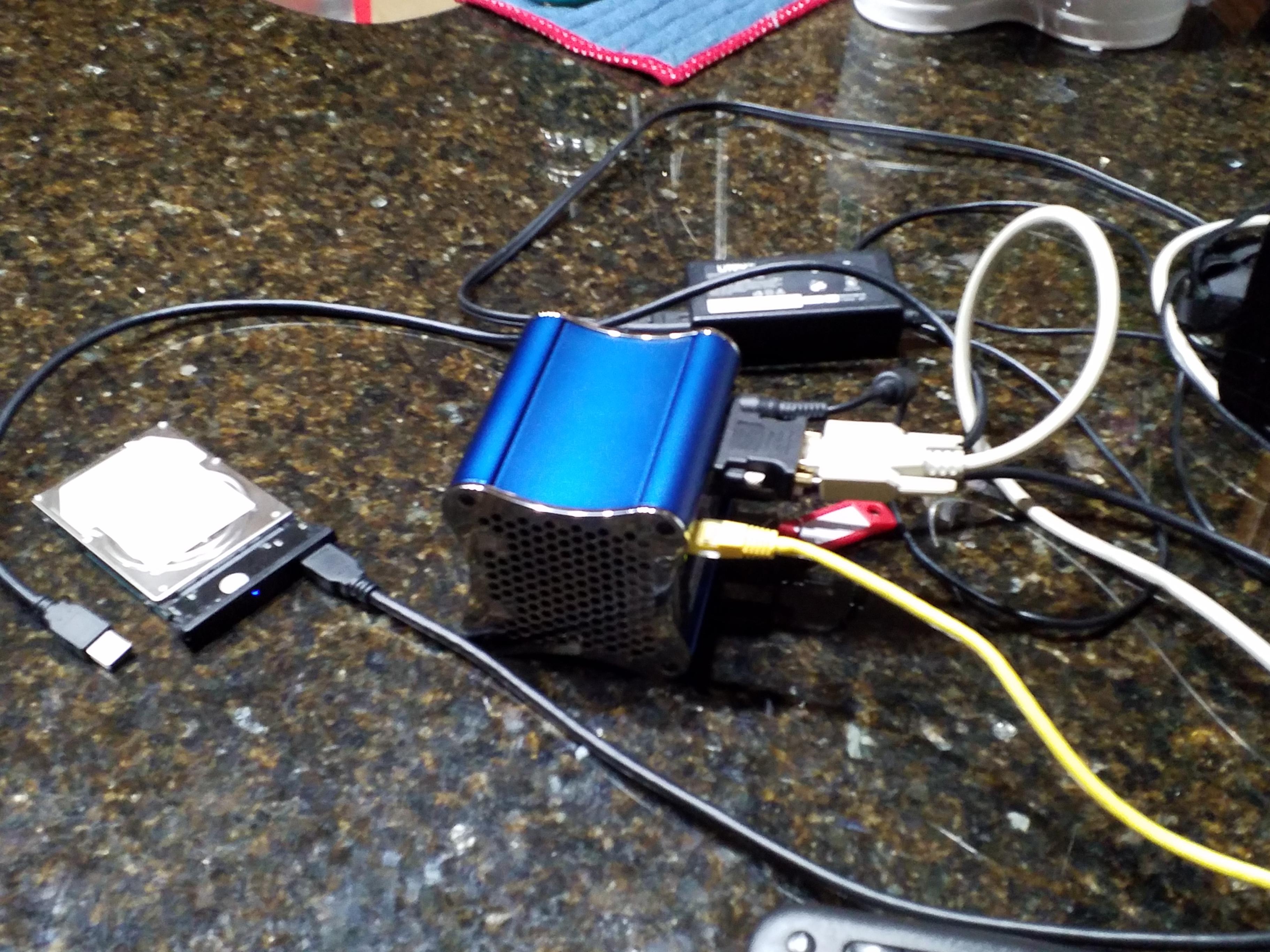

My music library was on a 2TB USB HDD that was permanently connected to the Daphile computer. A few weeks ago I copied a few CD’s from this external USB HDD to the MUSIC folder of the internal HDD and noticed that the same files sounded noticeably better when played from the internal HDD. The next thing I tested was to remove the USB HDD (that is doing nothing at all while playing from the internal HDD) and then the sound quality goes another step up. I found that the SQ improvement of removing the USB HDD to be bigger than the difference between internal or external drive.
I opened the 2TB USB drive and found that a normal 2.5” HDD was inside. Now I am using this disk as an internal disk and installed Daphile on it and recovered the music library from a backup disk. The (former USB) disk was formatted in NTFS and when you install Daphile on it it is all data on the disk gets lost and it is formatted in EXT4. That’s no problem because I was expecting this and I have a copy.
