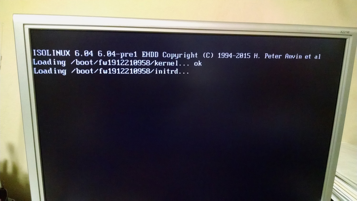

I successfully made a bootable USB stick per the Daphile instructions and it boots and runs from my windows 7 desktop no problem...and I can see it on my network and I ripped a CD for fun..all good.
I have a couple of IEI single board computers laying around; a model PV-5252 and a PV-5253..they are both atom processors booting off of CF cards and running win7 embedded. I would like to use one of these as my headless Daphile device.
My first issue is that the bios on these SBCs do not have USB as a boot option, so my USB stick isn't an option. I also made a bootable 2Gig CF card in my desktop card reader with the Daphile ISO image and installed this in the PV-5252 Atom board.
It begins to boot...and I get this......followed by a black screen.......any ideas?
