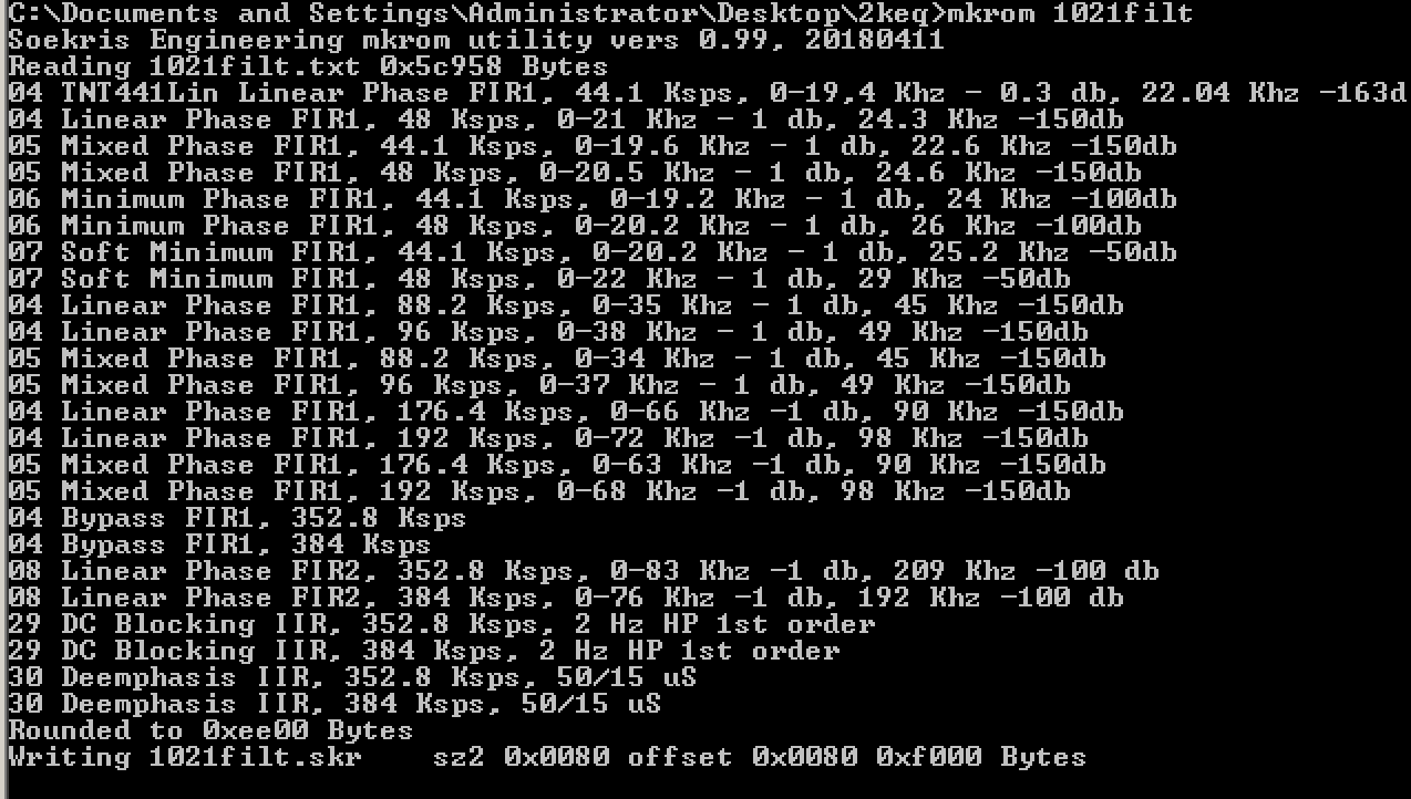

Confirmed that both channels are mixed to mono as the test track "this is left channel", "this is right channel" is both audible but centred between the loudspeakers i.e. mono. The center test is OK, the out-of-phase test becomes silent.
It was loaded with this filter:
+ a few biquads not showing here.
dam1021,44100,8,4,1999,8

OK, I know it's not documented anywhere, but the first 8 biquads are reserved for the crossfeed function, that could mix the two channels as mixing the two channels is needed for the crossfeed function.
Try moving your biquads filters up to 24-30.
No crossfeed is a function added in dac1421/dac1541, and the dam1941 is based on the dac1541 so it support crossfeed.
For those who don't know crossfeed, it's a function to be used with headphones to reduce the with of the soundstage to simulate speakers. The dac1541/dam1941 do it using digital filters that mixed the two channels.
Try google if you need more info.
Correct, the first 8 biquads is reserved for the crossfeed so there is only 7 left for the user. I didn't expect that to be a problem, but if needed I can add a software switch to disable to crossfeed function.
