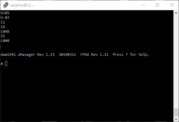

has someone already brought the second I2S port to work?
I have updated the firmware to version 1.23 and switched to the I5 input. Have tried moode audio and volumio with dam1021 selected, but get no lock. Unfortunately, the LED always blinks.

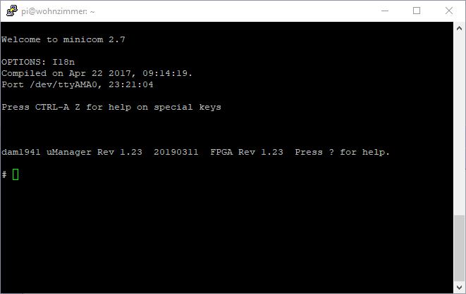

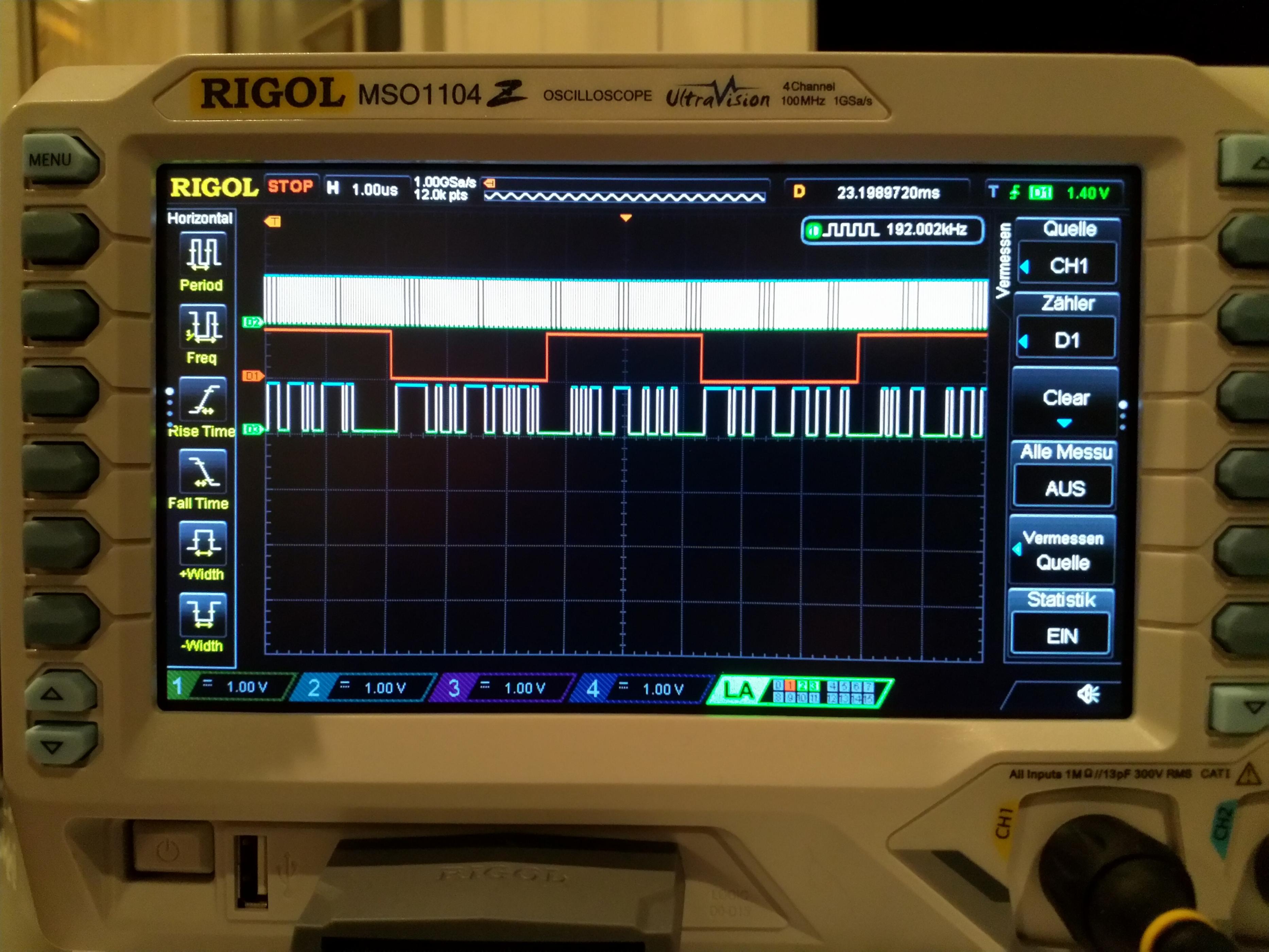

Work here, so check your wiring, make sure they're connected correctly.
Doublechecked the wiring and tested the I2S signal with a dam 1021.
- The I2S signal works with the dam 1021.
- No lock with the dam1941
Don´t know where to search next to get the I2S port work.
Hope the firmware update worked well (see attachement)
It do look like that the fpga firmware is an old version, something must have gone wrong merging and moving the files....
A correct 1.23 is now on the website, please try again.
At least the second I2S port is working as expected 🙂
The FPGA firmware is now 1.23 too.
