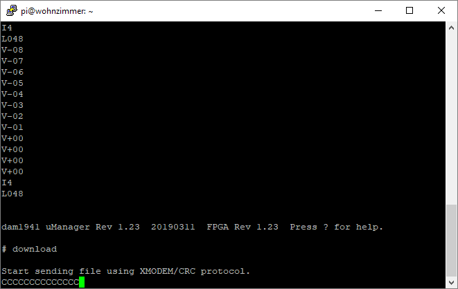

I do not have any response from the dam like cccccc. When I download and then send the file, I get in the receive data window many cryptic characters. After the send process is finished, I wait a moment, but nothing happens. When I turn off and on, is still the old (1.21) firmware on it ...
the output from the DAM should not be "cryptic" (see attachement).

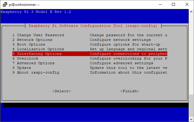

I can write a small tutorial for the firmware update with the raspberry pi if you like. When you have the raspberry pi already connected for I2S, you need only two additional wires to have the serial port over the rpi too.
Howto connect, control and update the DAM1941 with a Raspberry Pi

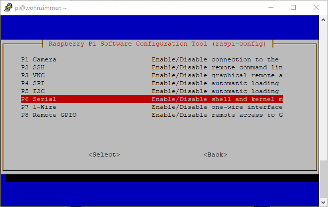

1. disable serial port terminal shell output on the Raspbian/Raspberry Pi
If you do not disable the shell output, the DAM will receive all the console output from the Raspberry Pi and will crash immediately. When this happens the front-panel-switches do not react anymore and you have to powercycle the DAM.
select "5 Interfacing Options"
select "P6 Serial"

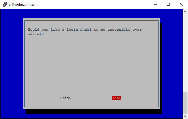

select "<No>" at "Would you like a login shell to be ...?"

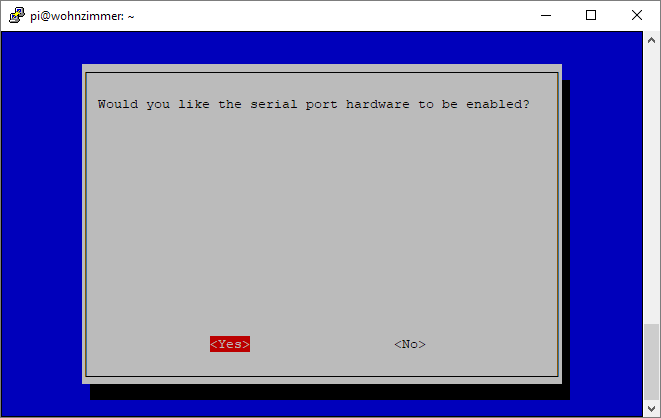

select "<Yes>" at "Would you like the serial port hardware to be enabled?"

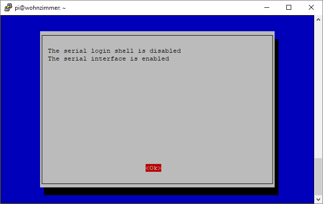

select "<Ok>" and exit the config tool
2. reboot the raspberry pi

type +++ to start the uManager
6a. The file upload procedure
type download <enter>
when you se the CCCCCCCC on the console you have about 45 seconds time to select the file. and start the upload of the firmware file

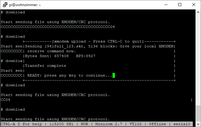

type <CTRL> A S
then select xmodem
use the up and down arrow keys and a doubleclick on the spacebar to navigate through the filesystem.
highlight the .skr file with the spacebar and press the <enter> to start the upload.
The byte-counter should conunt up. If the counter is not visible (as shown in the attachement) you were too slow with the file selection. press <ctrl> c and go back to step 6a.
press any key when the upload has finished.
Finish the firmware update. cannot remember the last procedure exactly but i think you have to confirm the flash procedure for the uManager part.
After everything is done type exit to close the uManager. Exit minicom with <ctrl> A Q

EDIT: add some screenshots for raspi-config and the file upload procedure
Code:
sudo raspi-config
select "P6 Serial"
type update <enter>
confirm the flash procedure for the uManager part with "y".
EDIT: forgot the "update" command for the uManager
