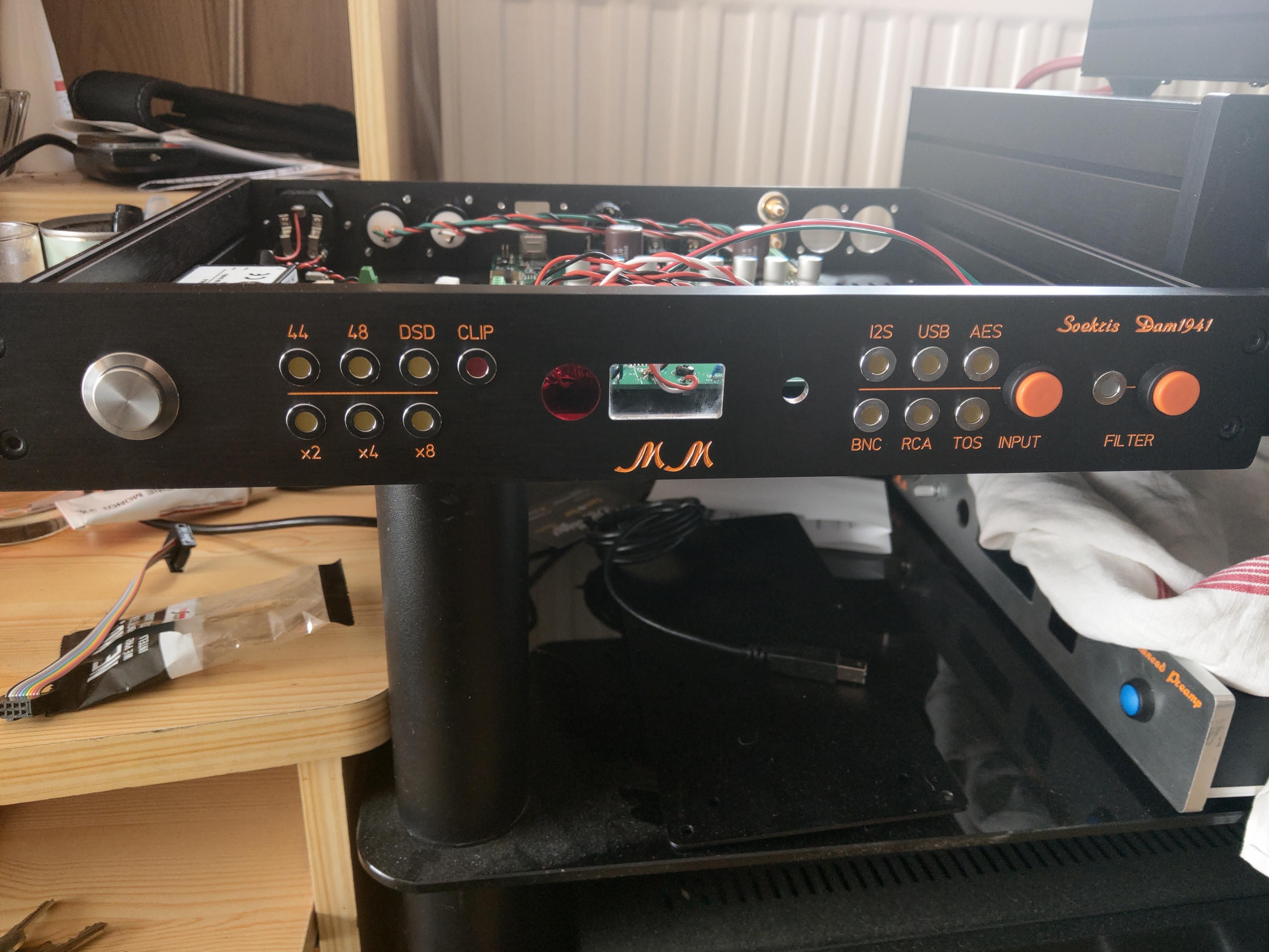

I've been working on my build the last few days. I didn't want the front panel as it is, i don't like the look 😀 So i use a custom one, with custom led and switch.
It is working fine exept the small board with the led matrix and encoder. I use the multicolor flat cable you see on the left corner of the photo. The only mod i do is changing the led matrix for the orange one of the same serie (vishay) to match the build.
When i plug this pcb, the matrix turn on but don't show relevent info (i put -20db in the soekris and the matrix show 0), but if i mouve the encoder the matrix turn off and the dac control go crazy, all led blink, go on/off or change color for the filter led. I don't understand where it come, i check many time the pcb and i don't see any mistake or short circuit.
An idea ?
Regards

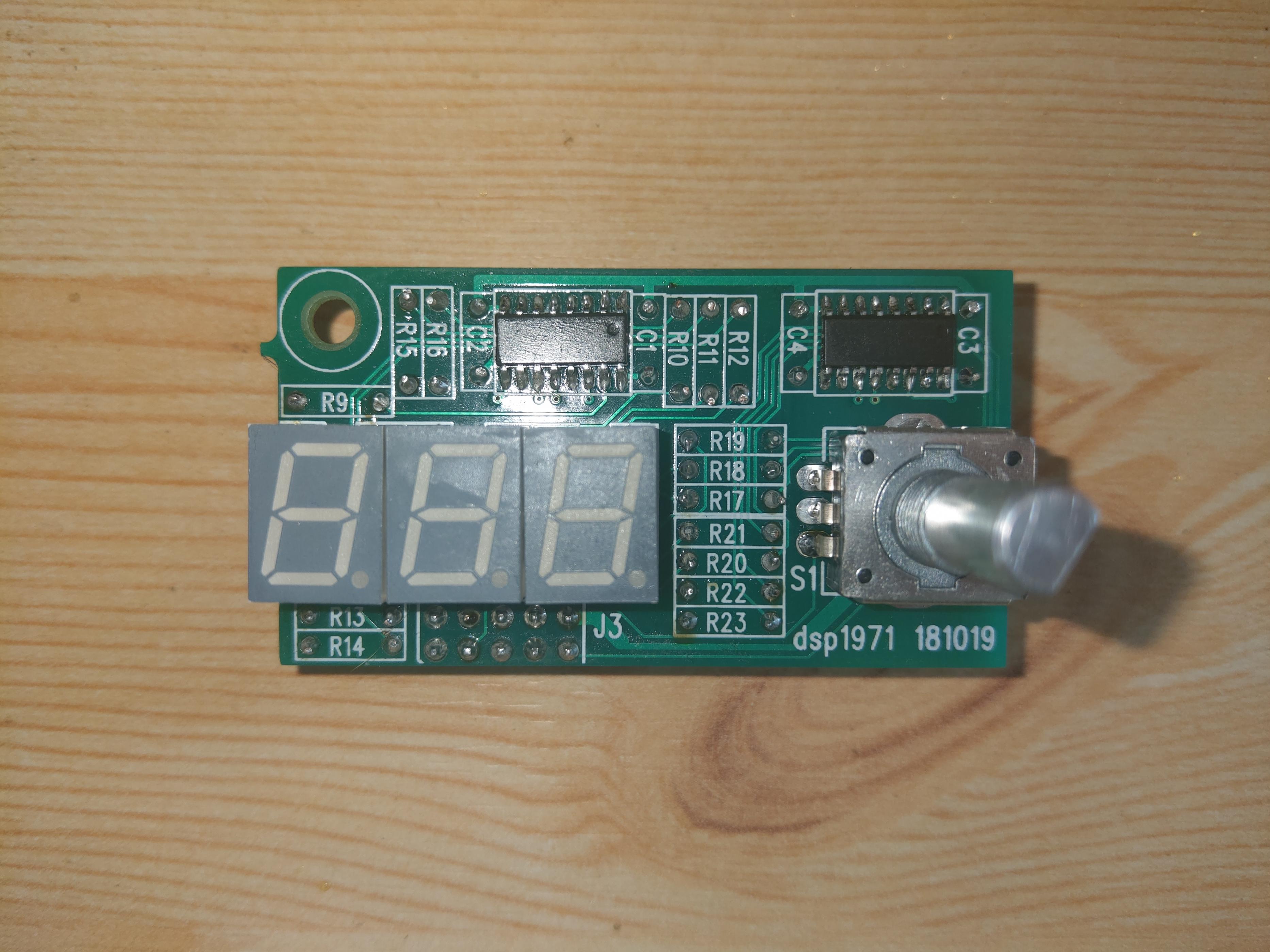

I forget to mention but i use a different encoder : PEC11R-4220F-N0024
It is suppose to be exactly the same but with a different shaft that work better with the knob i choose.
I also attach a photo of the encoder/led pcb. Resistor, cap and connector are on the backside as it allow the pcb to fit my panel.
Regards !

Sounds like a basic case of incorrect wiring....
Otherwise your build is nice.

Indeed but i just don't understand. It couldn't be a bad resistor as their are all the same value, the 3x ceramic caps are good value, the 2 x 74HCT594A are solder in the right side and i don't see any pin badly populate. And for the 2x8 header i just use another flat cable to try without success.
Is the problem could come from the DSP board ? I don't understand how as everything is working fine when i don't connect the led/encoder board.
Is it possible the two 74HCT594A don't like the heat when i populate them ?
Regards

Does the display board work when you plug it directly into the dsp board ?
Make sure that cable is wired so the same pins goes into the right pins as when connected directly.

I resolve the problem by using simple arduino prototyping cable, so i'm sure it's pin to pin. Pretty stupid problem, i still don't understand how these connector for flat cable are not pin to pin. Anyway, thank you 🙂
