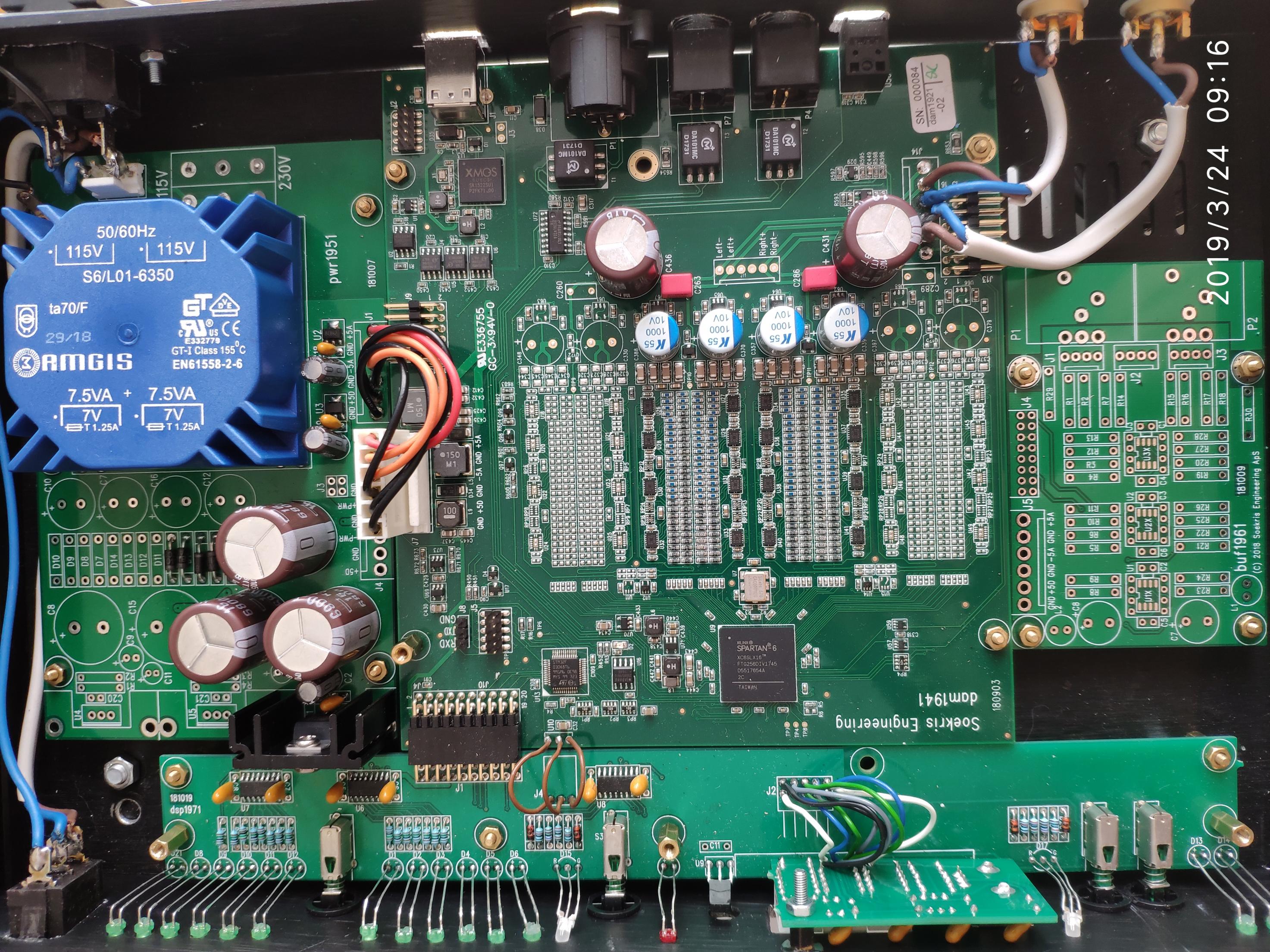

Junked the stock PS. Wow, what an improvement! It is now very similar to my 1021 with a bit more solidity in the midbass and better ability to handle peaks. Beginning to sound very promising 🙂
Err - what did you do actually?
I just junked Vref caps an replaced them with BG N 10/50. I might be imagining things, but it seems like everything sounds so much better now. Gone is the slight edginess, the texture and definition of the bass, rhythm are all better, very impressive low level detail and overall presentation much more natural. While before, the DAC sounded promising, it entered brand new territory now. I will be still experimenting with those caps, but for now I’m quite satisfied with a sound.
...Peter, what are the big red guys ? Looks like BG as well, no ? Any source for the Bg N 10/50 ?

What i wrote: removed the stock board and added separate transformers and lots of Mlytics. Like PD, only uglier 🙂
It also entered a brand new price bracket. Those are NX, right? 😀
All red caps are N type, the bigger ones are 100/50
And yes, all those BGs are worth more than the DAC board itself ;-)

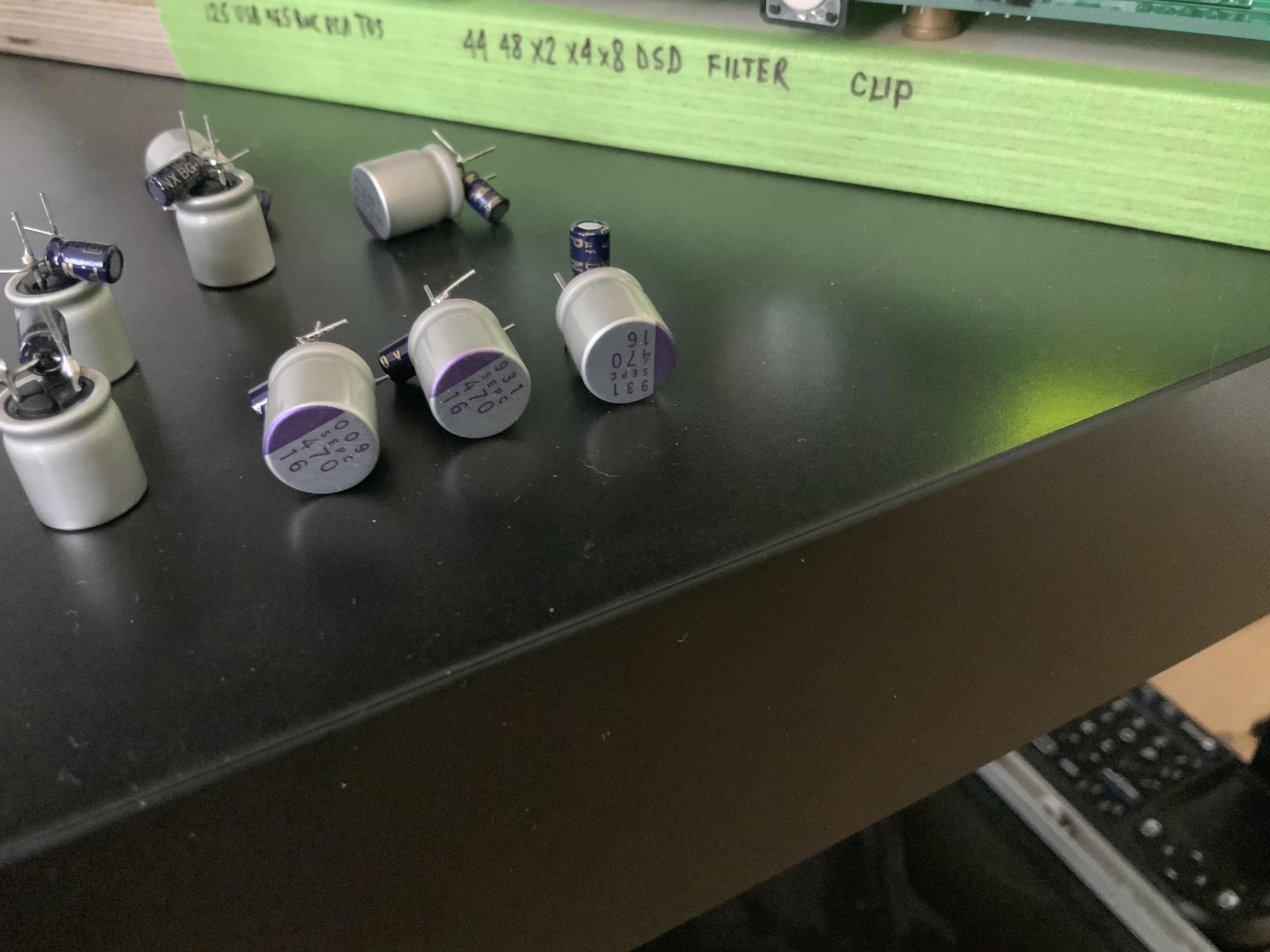

Yes, that’s exactly what I did and it works perfectly fine for me. That choice was inspired by my past experience with my own DAC design where smaller caps produced better results.
I also tried OsCons here briefly, and they produced marginally better results than stock polymer caps, but it was nothing like the change I’m experiencing with those small caps.
But why those expensive BG then ? There are real polyprops at a nicer price point around, no ? But its interesting that these areas are identified to change the sound...so if one chooses to go wild, why not a couple of CDE 947D...they really sound transparent...serious stuff, big like a COKE-can...
I just happen to have a good stock of them and use them when occasion arise. I would never pay current prices. As pointed previously, the OsCons may be a good alternative.

An important thing on DACs is low impedance on the vrefs at frequencies from DC to Mhz, especially on a R-2R DAC where output is directly related to the vrefs. The importance of that have been discussed many many times on the dam1021 thread.
The dam190x1 have opamps being used as regulators, those closed loop output impedance start to rise at 10 Khz, there the capacitors take over, simulations showed that a 1000u polymer was an excellent choice, not a random choice. That one have low impedance up to several hundreds Khz, where then a number of ceramics take over, both large and small, low inductance is also important, what's why 0402 sizes are good too.
Paralleling capacitors works very good, that way you can get low impdance and inductance over a large frequency range. And only low impedance count on vref decopling, any magic caps are a waste if their specs don't match the needs. My taget is 10 mOhm from DC to Mhz.
