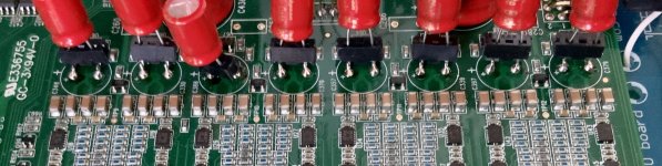

So I’m feeling adventurous tonight and would like to remove some of those ceramic caps and replace them with 0.1uf BG NX. There are 8 sets of four caps and it seems like each quadruplet is in parallel with a large electrolytic. Are they all the same value? Why 4 per each set?
BTW, after recent discussion here in this thread, I went back to original electrolytics, just to make sure that I was not imagining things, but I didn’t like how the DAC sounded. The harmony and naturalness was missing and I quickly put back my “magic” caps.
I don’t expect much from removing those ceramics, but at this point I need to check it out.

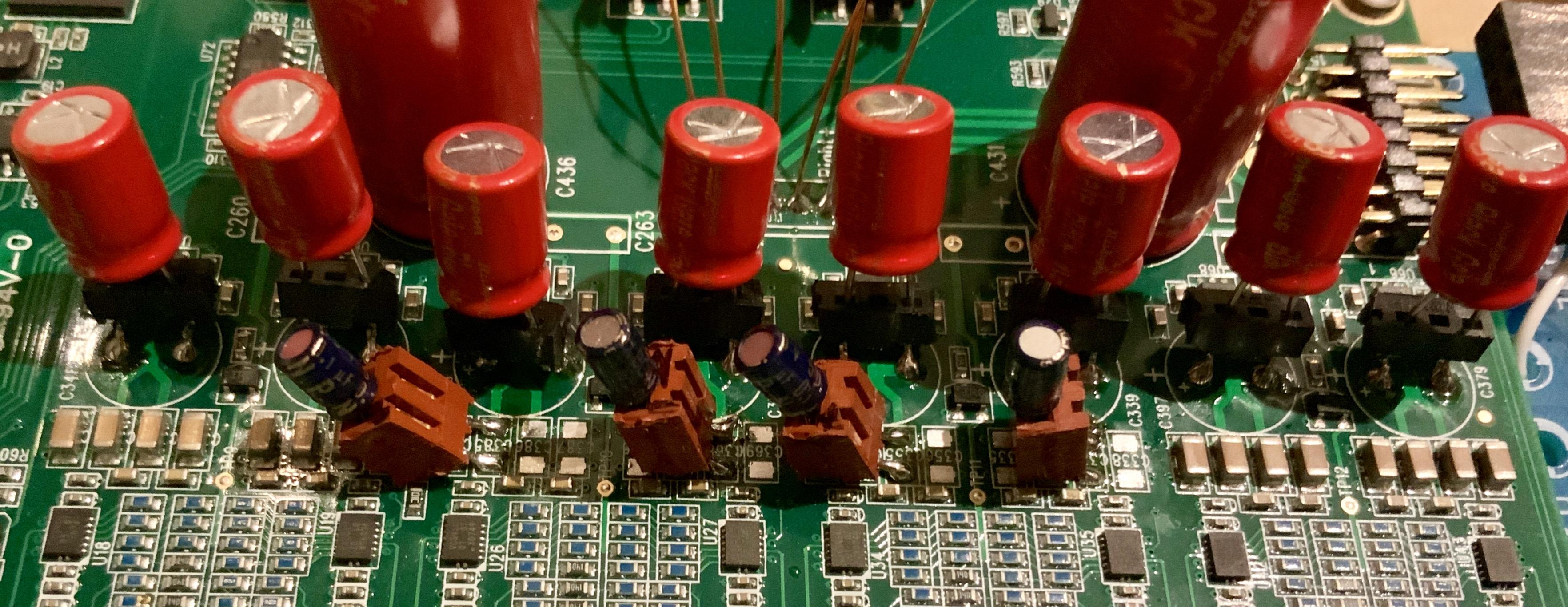

OK, so back now to the mods. I remove 8 ceramic caps as presently I'm using unblanaced output only. It was an easy and clean job. While I said earlier that I try not to bypass the caps, I keep here the BG NX 0.1uF as I think it may actually sound better with them (I didn't listen without those caps yet and I will try it tomorrow).
So how does it sound? Well, the difference is rather subtle, but I would say quite important. I didn't observe much changes in overall tonality, but what stroked me first was increased depth to the sounds and much better audibility of lyrics.
I just hear more, there is more layers, the separation is better, each sound follows it's own melody (if I may use that expression), there is more space around instruments, more air, more detail, more background sounds (no matter how faint they are, I can still notice them). I think overall presentation is more relaxed, less forced and there is less edginess. I cannot complain about the bass at all, it's well defined with very well pronounced PRAT.
And while I said in the beginning that the DAC sounded promising, I think it finally delivered.

Thanks, Peter...so for sure this is an area to influence our experience...awesome job...I will try this mod later myself...need to think which cap...BG at current prices is a nogo...
