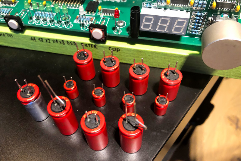

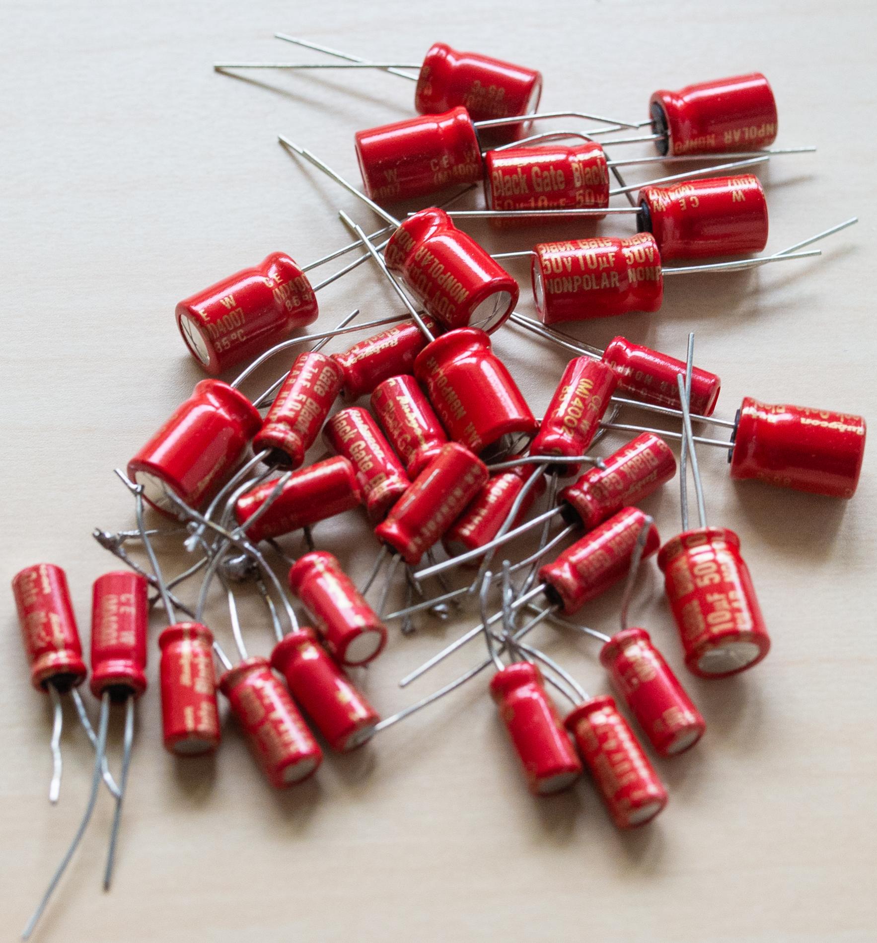

I did some more experiments today and I definitely like it better with BG NX 0.1uF cap in place. Without it the sound is a bit veiled, with it, more direct and detailed.
I also tried BG N 100/16 and BG N 47/50 caps: 100uF sounded a bit heavy weighted, with air and detail not that obvious. BG 47/50 sounded better and I had some hesitation which one to chose but in the end I stayed with original 10uF cap as the sound it produces is more "dramatic", with micro detail, air and presence pronounced very well; it's just so impressive right now.
Impedance on Vref is certainly important and someone still has to describe how it translates into perceived sound. What I described with my mods is simply the sound of a capacitor, which in my believe, has a certain sonic signature which affects the sound no matter where it is actually placed in a circuit.

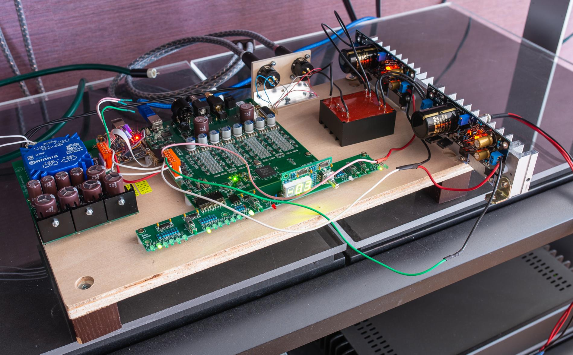

In other news i seem to have finally settled on a configuration which makes me happy. Or at the least finally does not make me crave the 1021.
Nothing fancy really.
1. PS board is used only for the +5v digital. The idea that those 78L/79L can power anything analogue or that a single transformer can be shared between analogue or digital is just absurd.
2. Shift registers are powered by 2 x Salas 1.3 and a smallish transformer. Gave up on the external PS with the 100,000uF and surprisingly the degradation was not so significant. For which - kudos to Salas:worship:
Power transformer will need an upgrade for deeper bass and solidity but even with a tiny 18VA the sound is very good. Current setting resistors are very audible and i use Caddock MP816 set for 200mA.
3. Output filter is removed
4. Output muting fets are removed. Surprisingly i cannot hear any pops these would have been masking, just improved low level resolution.
5. Not using an extra XMOS board anymore. The inbuilt XMOS solution is pretty good and currently matches the tonal balance slightly better. Besides i like the idea of a reduced number of disparate clocks in the chain.
And finally a question for Søren:
There must be an easy way to apply external power in place of the usb +5v. What is the best place to do this? L3?

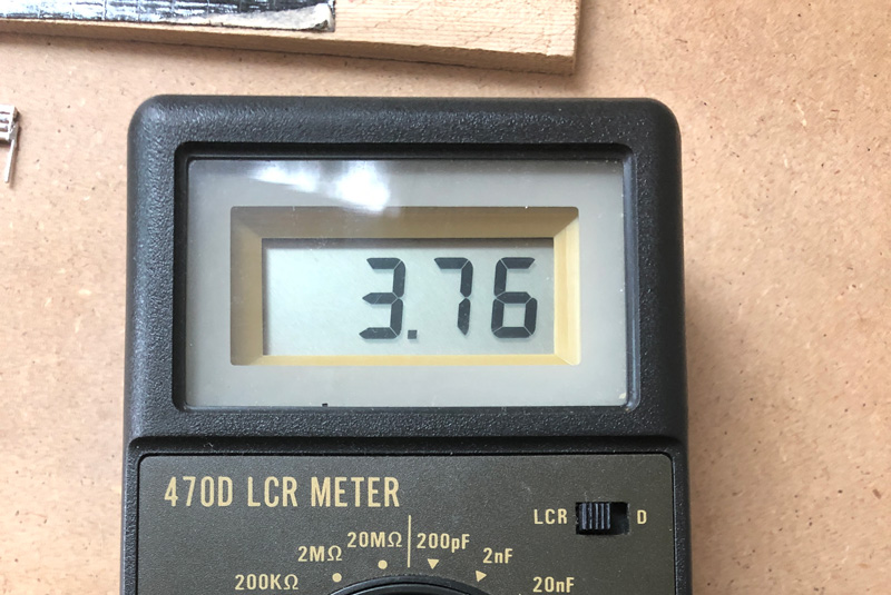

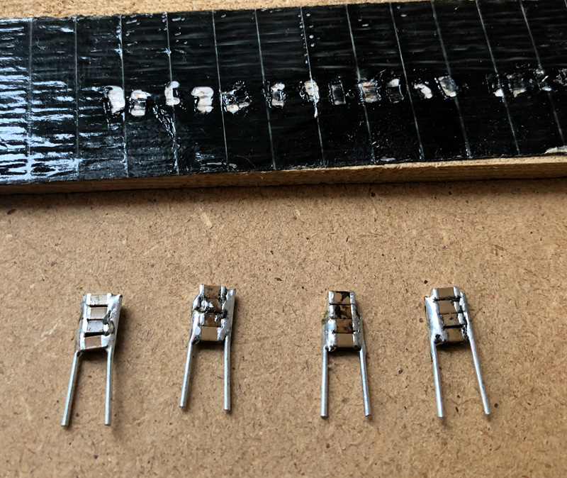

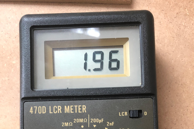

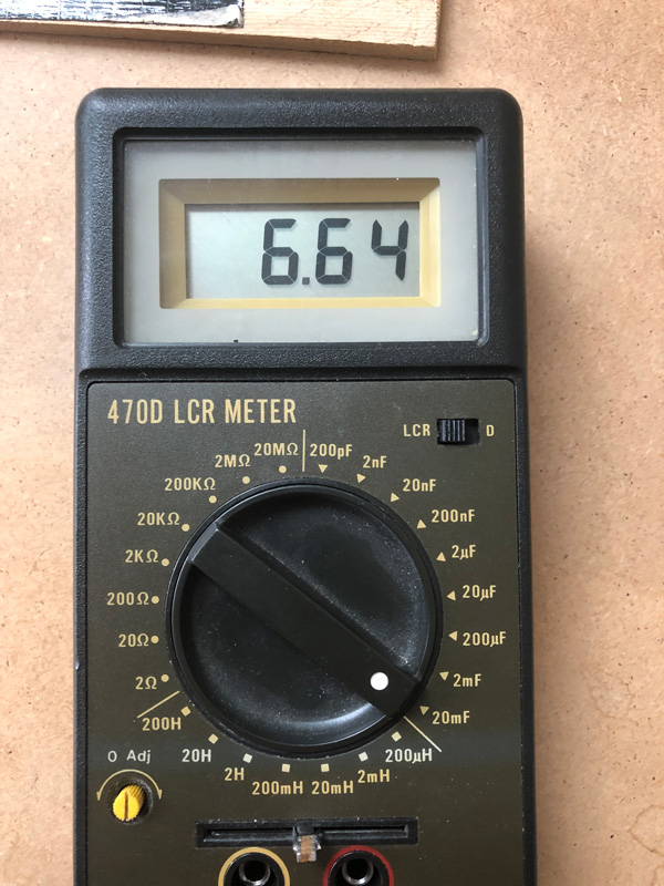

However, I will do a bit more and test again the effect of these caps. I made them into nice modules which can plug quickly into sockets and this way I can do more comparisons. What's interesting, the sets don't measure the same: out of four, two show 2uF combined capacitance, one shows 4uF and one is 6uF. And I didn't mixed them up, since right after desoldering I placed them in a proper order on a sticky tape. Could that be an issue with assembly providers? My board has a serial# 0010
