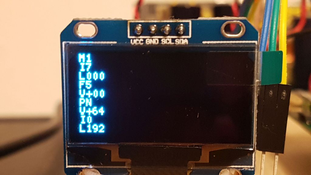

Ghost volume status messages
Søren,
What the heck these volume status messages (V+00, V+64) at DAM1941 init?

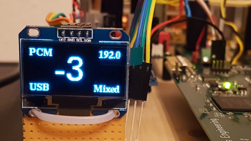

I built display and IR remote control for DAM1941 using Dimdim's ArDAM_Lite panel with Arduino Nano and 1.3" OLED.
Working perfectly, but managing these "false" init status messages reserve unnecessary storage space in the very "narrow" Arduino Nano.
It was necessary send volume ( for example -3) command to DAM to get "real" volume status message.

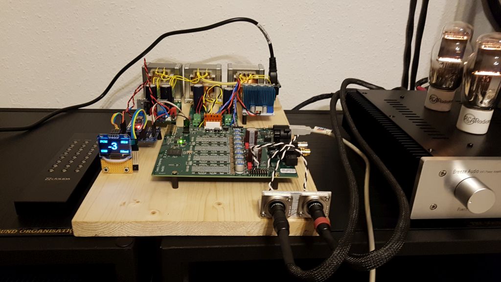

ArDAM Lite controlled DAM1941
If anybody want to use Dimdim's ArDAM Lite to control DAM1941, I wrote there about my system:
