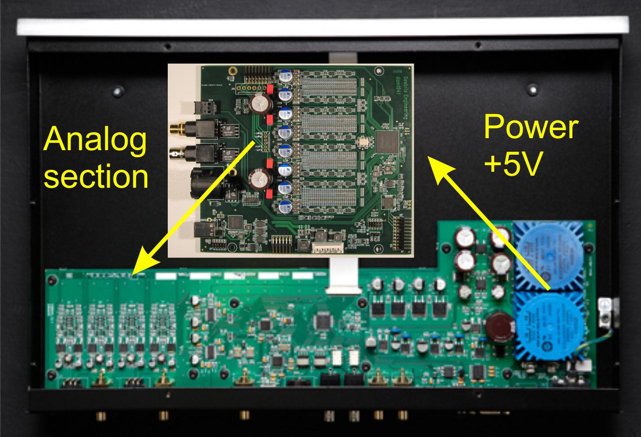

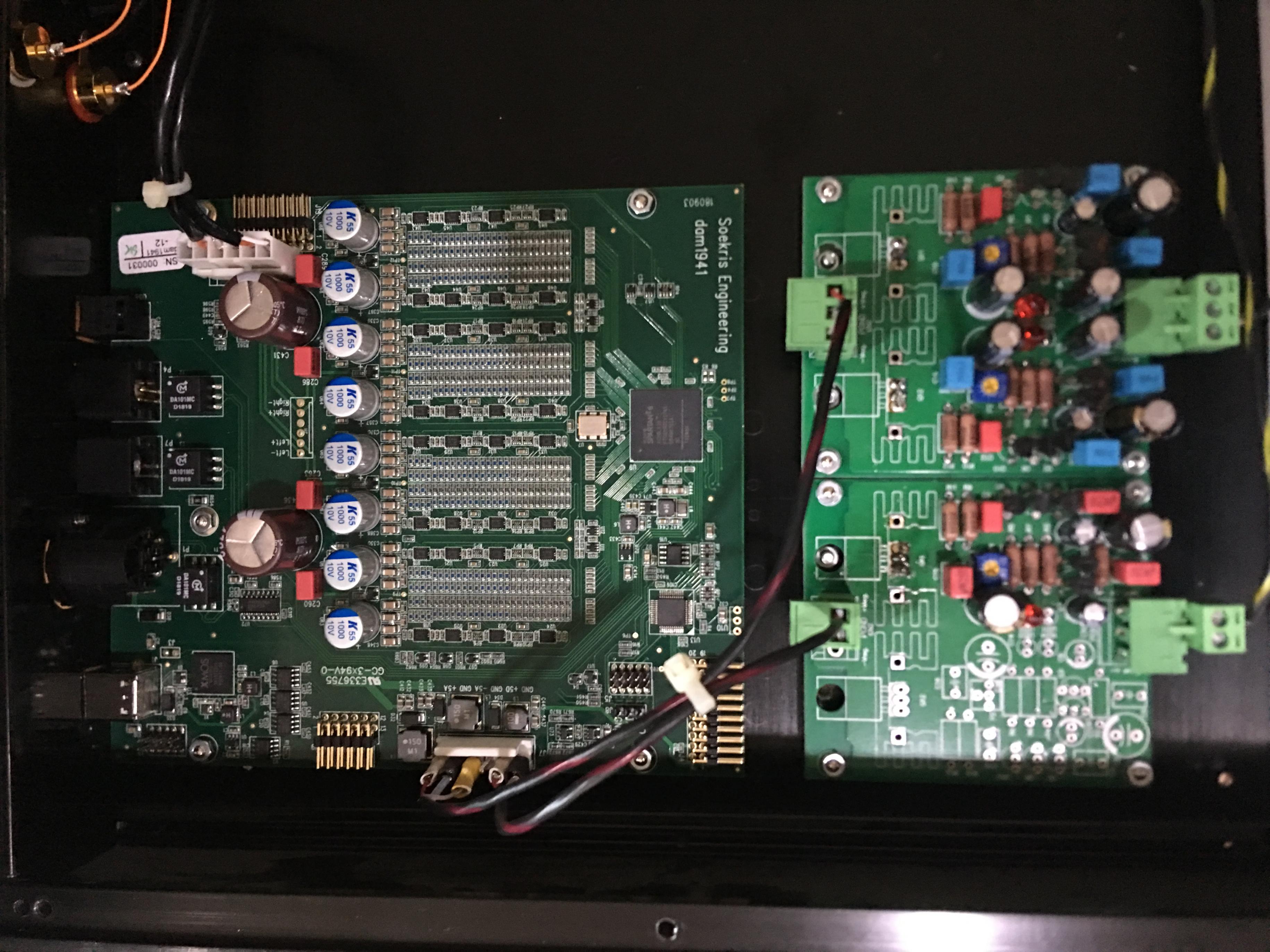

My crazy idea is to use very good analog stage and Power supply part of my Bryston BDA-1. Somehow, I plan to isolate a bit outdated digital part of Brystone and use it to power dan1941 board and also to use Bryston famous fully discrete output analog stage. There is aslo a lot of space to put dam1941 inside. Please take a look my scheme and photos... and tell me if this is crazzy idea and i better go to assembled dac, but obviously less fun there )
I am no an electronic engineer but can solder and like it.
Thank you.
Confirmed. It is a crazy idea 🙂
But no reason why it won't work.
I personally do not see much value in the PS, or the output stage, but the casing is certainly nice. The question is how many additional holes will be needed and how will this reflect upon the cosmetics.
You will need +-5v for the analogue supplies as well, which perhaps means an additional set of regulators.
The DAM does not necessarily need an active output stage. I would expect the Bryston stage to reduce the transparency without adding much value in the case of an active preamp and reasonably short cables. If you intend to go directly to a power amp or headphones and use the digital VC, then the output stage seems like a good idea.
And lastly: would i do it? No way.

Yes, I plan to use Brystone BHA-1 balanced connected as an amplifier after DAC. And i know this headphone amp can work well as preamp also. From what you point out, dam1941 in this setup can be used without any problem directly and no need of any additional bufer o analog out stage? is it correct? It will even do pathway more simple and clear. And if is true, then my ides will only benefit for PS section which is not that interesting. And I also forget about analog 5V source for dam1941. Seems what I though is not that sexy anymore (
The Bryston's +15V/-15V PSU almost unusable for 1941 DAC (+5V, +5V, -5V).
BTW 78xx, 79xx regulators are very mediocre ones compared to low noise, low impedance PSU devices (LT304x, shunt regulators, Jung superreg etc.).
1941 output voltage is enough high, no need amplification (and output impedance is enough low to drive anything).
I would (I'm in the implementation phase of my 1941 DAC) use only an isolating device, the high impedance 1:1 transformer (to minimising ICs in signal path) -Cinemag 15/15B, Jensen JT-11-P-1 or similar).

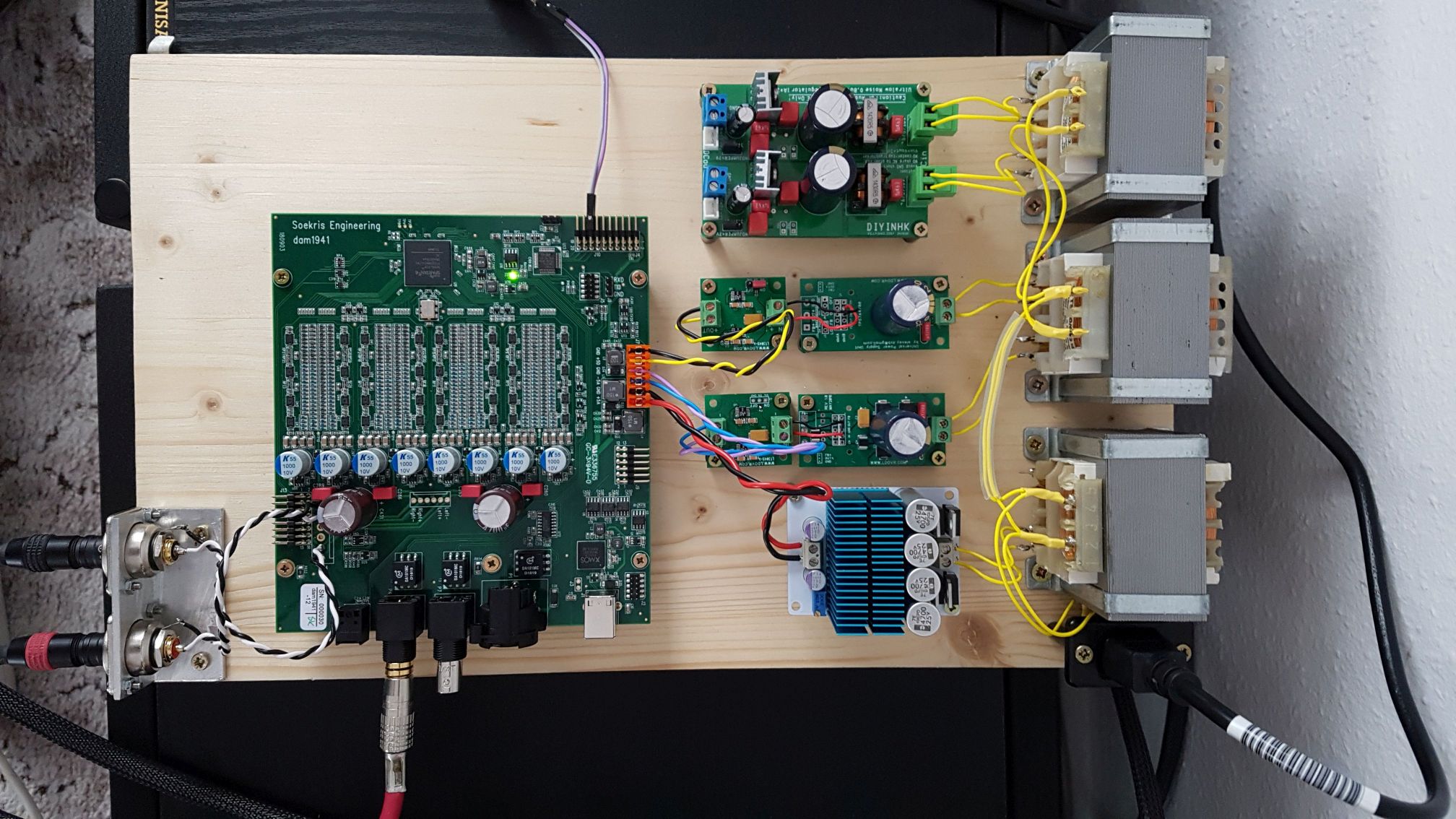

Hi Soren, my questions:
which input is active when I select I2S via the input button? Is this the second, not yet supported by the firmware I2S input on J9? What is about the first I2S input? Sorry,
I 'm a little bit confused with the I2S inputs...
For example, how can I connect a raspberry Pi via I2S to the DAM?
Best regards, Peter

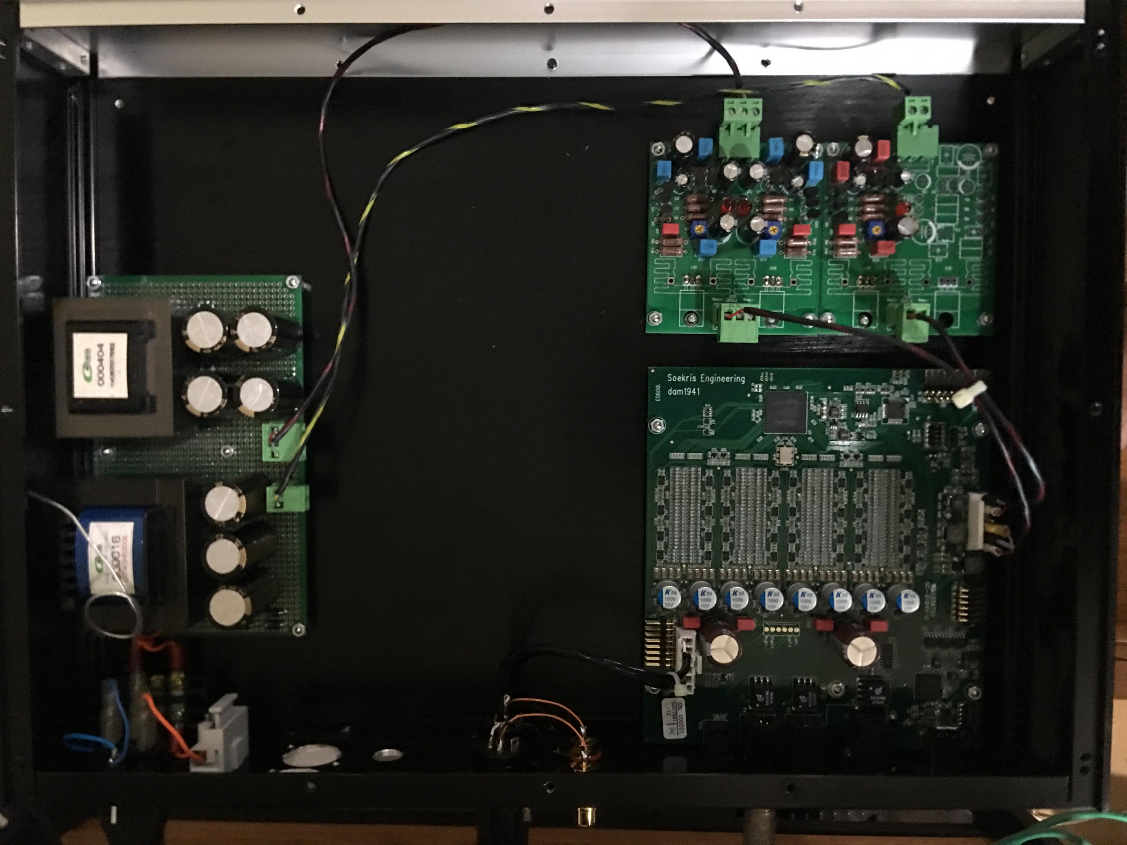

My dam1941 is up. I still don’t have a proper controller so rely on the default setting for source selection(Auto) and the AZ OLED from my 1021 for filter switch. Thinking abt using dimdim’s Ardam Lite for the control.
My 1941 sounds significantly better than my 1021 in every aspect. The integrated source input saves a lot of work and is a big plus for sound. I prefer discrete regulators and buffers (to be added later).

Thanks for sharing your opinion. What PSU are you using?

Yes, the board comes exactly as shown on the website. I added a connector for the direct output.
I use Borbely’s all-FET regulators. One for +5V and another for +/-5V bipolar supply.

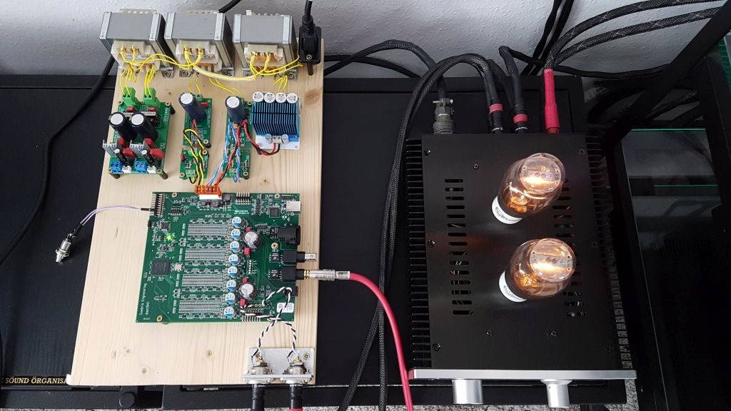

1941 on breaboard
1941 is running on breadboard.
Now I'm fighting with dam.ed "chinese" Apple remote, simultaneously with DimDim's ArDAM Lite (display and remote) programming.
