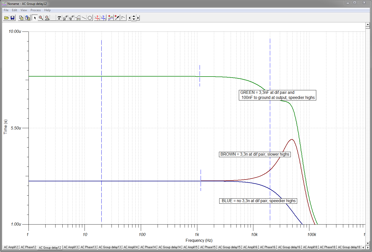

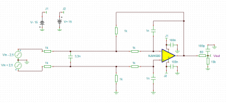

Understand you have the filter at single ended output of unit, and not at +/- pair from DAC.
Example with same cut off frequency:
Filter at single ended output to ground make changes frequency/phase with groupdelay in highs being speedier and is isolated from DAC output.
Filter at +/- pair from DAC output make changes frequency/phase with groupdelay in highs being slower, and probably dampening highs at DAC.
Huh? How does this differ from a filter anywhere in the signal path?
It differ:
Filter cap to ground gets highs comes before middle/lows (groupdelay) to our ears.
Filter cap between dif pair gets opposit groupdelay highs after middle/lows, or at least less speedy in highs.
At same if any HF noice at DAC output it gets some filter before next device, and last the dampening in highs.
It differ:
Filter cap between dif pair gets opposite groupdelay highs after middle/lows.
I don't think it works that way. Care to provide a source? Group delay depends on filter characteristics such as number of poles, where they're located (in frequency), the same for zeros. But, we have a single pole at about 30 kHz to get 1 dB, or so, down at 20 kHz. Where the filter cap is placed will not affect group delay. If it does, please show me where this is said to be so.
I am not good at that that stuff, only hobbyist.
Maybe something with the virtuel ground point in middle off cap, or some pole thing as you mention.

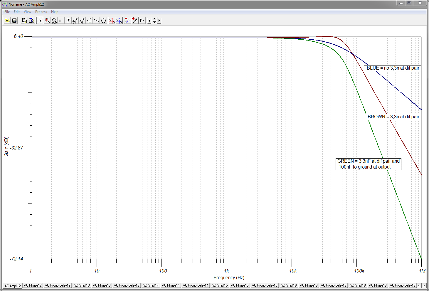

Here simulation circuit and plots, 1-circuit, 2-amplitude, 3-groupdelay.
Green and blue is with and without 3,3nF cap between dif, green is the 100pF at output changed to 100nF probably as you did.
Don't no if groupdelay changes in highs at uS is audioable, but there's a difference in plots.

I don't believe there is any difference. You can consider two caps to ground from each phase as two caps in series between the phases. In both cases the midpoint is at zero. The only difference is that in your case you need two caps of double the capacity for the same roll-off.
