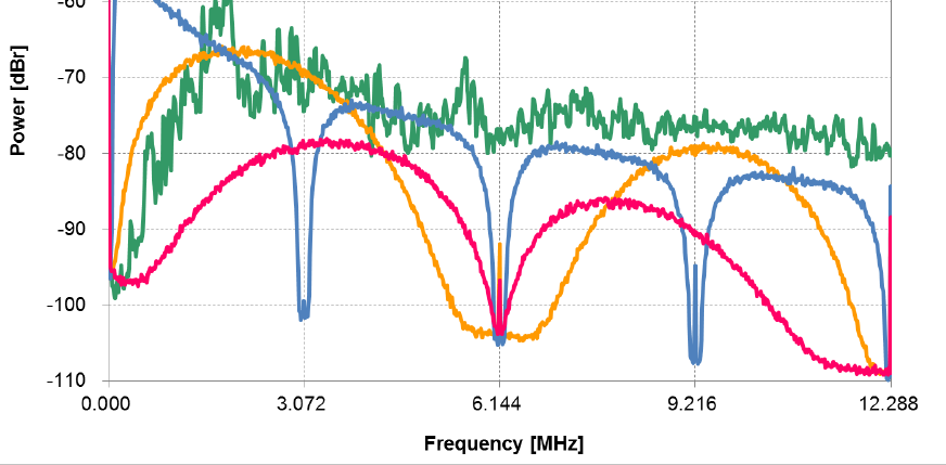

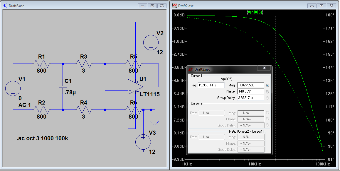

I was interested here because I'm dealing with the LP filter for DAC's right now. Below is a simulation of it in the ESS case (using really simplified mode;l for the ESS output) It really is nothing more than a single pole low pass filter set to a lower frequency that usual practice. (not too different from FM tuner practice). its a good idea to keep the HF stuff out of the opamp. The second plot shows what the opamp needs to contend with if there is no filter. Even with feedback caps etc the input differential is squeeling to keep up.
The second plot is the real HF noise from a number of different DAC chips playing a 1 KHz tone. This is real and if at full amplitude will fry many power amps. Fortunately most preamps don't have the bandwidth to pass this stuff. I won't pass on which chips but they are from the major vendors. Your favorite is there most likely.
I think the issue is the subjective response to the low pass filter. Floyd Toole did a lot of work on this and showed that listeners prefer the attenuated high frequencies over flat response. I am also coming to the feeling that the DSD 30-50 KHz (5 pole) low pass filter contributes more to the preference for DSD than the technology, especially since most modern DAC's use variations on DSD (Delta Sigma) for their conversion.
Which DAC corresponds to which graph ? (also the image is clipped)
This was shared with me as confidential so I don't want to reveal too much. I may make my own measurements if I can get my hands on some of these and I'll post them.
The simulation also shows that too much cap or too small resistors will produce oscillation. I did not look at the impact on noise. It may not be good.
I have also seen myself too, that higher capacity leads to HF oscillations increasing... It looks like an increasing of the HF noises, but it may well be just oscillations from the opamp... I did not insisted too much on these measurements so far. I think to repeated it later on.
