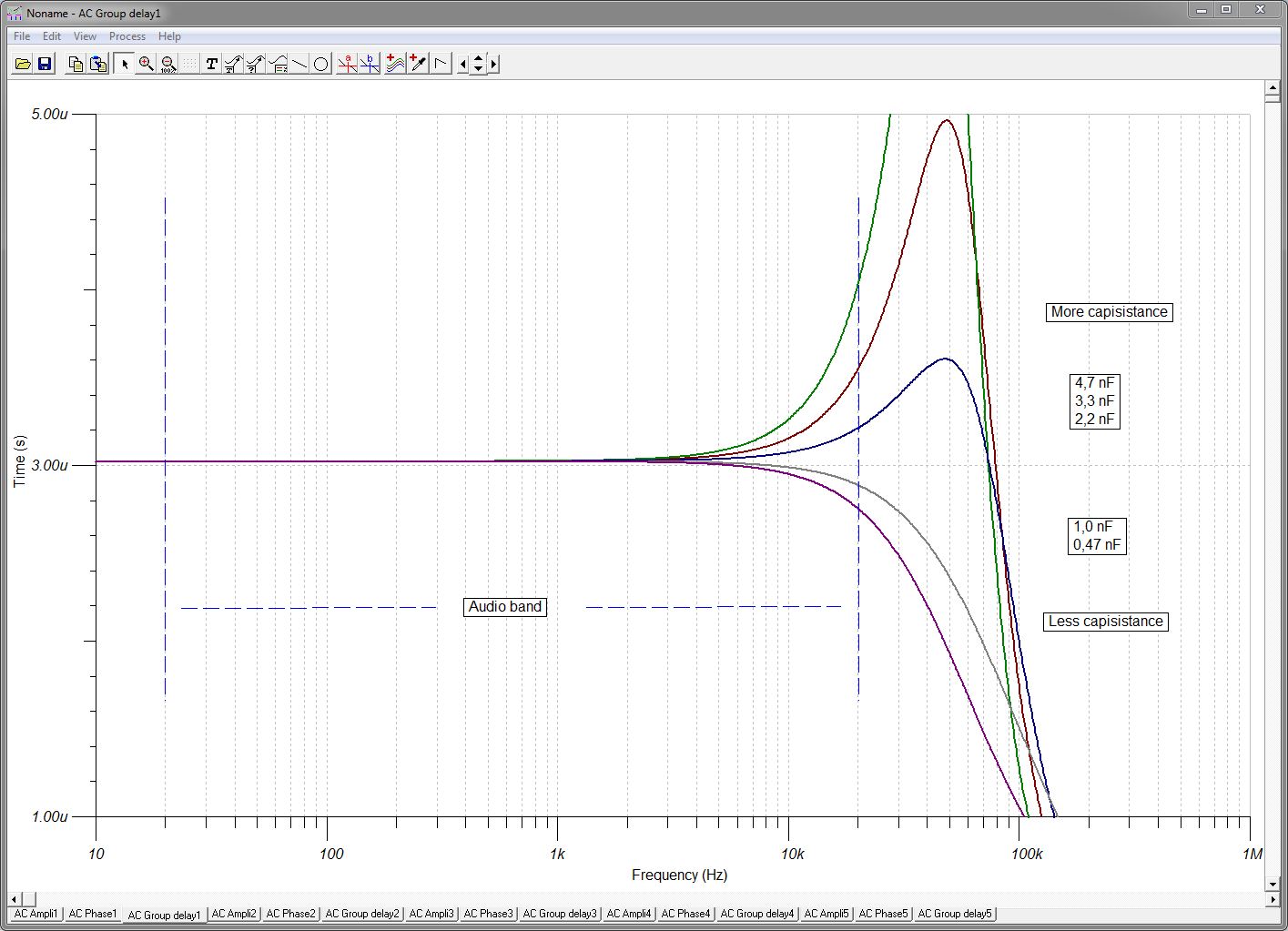

I have also intuitively supposed that it may happen something in this "phases" domain of the signal`s components (post 84), when using this filtering technique. What is happen with these harmonics, it seems to me as quite reasonable in Barbara`s theory. This cap over DAC outputs it may disturb (unbalance) the "perfection" or the functional level of the following I/V circuit, so that the more harmonics (of the audio signal) are to be outputted from the audio system. This it can make the brain (based on more informations) to appreciate better the location of the sound sources in sound space/scene.
I think it may be enough plausible so how the mechanism works in this case, to generate perceptual improvements, better defined , more open sound scene, better resolution in it, and so on. How it may also work the electrical mechanism in the present case, is to be further discussed... I can see already too, that Jan do not agree with this theory...
Now it looks to me that calling this as "filtering" technique it may not be quite appropriate. It will be better be called "unfiltering" or "signal disturbing" technique... to get a very positive result...
Why do you keep calling it a 'technique'? It's just a standard, simple 6dB oct low pass filter.
You call it a technique as if it's the best thing since sliced bread.
Go over to the non-filtered DAC religion, they are mordicus agains ANY filtering because it upsets the phase response which - in their ears - hurts the signal quality. Go figure.
And yes, ALL filters will also introduce a phase shift, the amplitude and phase response are locked. The steeper the filter, the larger the phase shift.

AC dampening effect in highs, less ringing and therefor more tight clear sound stage ? (AC dampening very audioable on speakerdrivers, and snoopers elsewhere are popular).
Groupdelay in highs ? (Highs get slowed and counteracts other chain devices tendency to present highs before lows).

I'm looking forward to it. Although I doubt it's audible, it could explain the difference you saw in the switching noise. Hypothesis: The capacitor prevents a sudden change in voltage due to bias currents during the time it's open circuited. Of course if you find that impedance doesn't change during switching the previous wouldn't be the case.Fomoco : Don't know. If all goes well I'll be able to measure that stuff soon.
I personally don't think it's audible, especially not being described as a more tight clear soundstage, but it's definitely going to affect frequency and phase response a little bit.AC dampening effect in highs, less ringing and therefor more tight clear sound stage ? (AC dampening very audioable on speakerdrivers, and snoopers elsewhere are popular).
Don't know, just inputs.
That's why I previously posted that this is a bad way to implement a filter. No one seemed to believe that it could cause stability problems. Although the resistors Joe added as the discussion went on probably mitigates this problem.For exactly the same reason the virtual ground at an inverting opamp input is also inductive - this seems to be less well known. Adding a capacitor in parallel risks creating a resonator. This could increase distortion by raising the amount of HF entering the opamp. The result could be misintepreted as increased 'detail' etc.

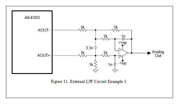

This is exactly the same considerations you have to look at for photodiode recevers. The photodiode delivers a current and the I/V conversion is done by a specialised opamp. The opamp is specially designed to have extremely low capacitance at the input, often just a few pF. So the last thing you need is adding capacitance there!
Jan
I was only thinking that placing that filter in that place, it may be called "technique", as this is not a very usual way or use a filter...
It is THE standard way to filter a balanced signal, it is done all the time. You may not be aware of it, and that happens to all of us once in a while, but normally you'd do at least some Google research before going off on a tangent. Helps saving your teeth 😉
jan
OK, I get it...
Though if you want to split hairs, the R against which the cap works would be the 2 x 3R3 in parallel with the 2 x 800 + 10 ohms. ohms, but 3R3 is close enough. 😉
Oh indeed yes, the drive Z is actually the equivalence of a resistor driven by Zero Z. So there has to be perceived there are two points where at the beginning and at the end, there has to be to Zero Z points, otherwise how are we to define the operation of the filter. It has to be 'ground' referenced at two places.
But think about it, and I am thinking this is also ESS's thinking, that an output Z ranging from 781.25 Ohm (single phase) to 195.31 Ohm (four phases) into a Virtual Earth (supposedly Zero Z), then even though the DAC looks rather low Z, the ratio is still theoretically infinite if the termination Z is Zero (and that is where the cap stop working).
(Not sure what the output Z of a Burr-Brown PCM1792-1798 is - I have only seen the rated current output and assuming infinite.)
So it is the termination impedance rather that send impedance that determines "current" mode, the ratio. But if the termination Z is not Zero, then what ratio is acceptable? I would say 10:1, but preferably a lot higher than that. My ratio is 118 with two phases ((781/2)/3.3).
So this gives "current" mode and yet also a place to put that cap.
