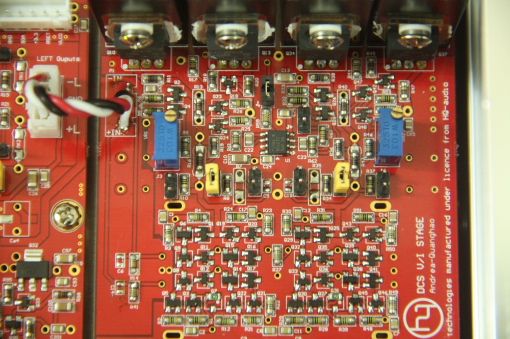

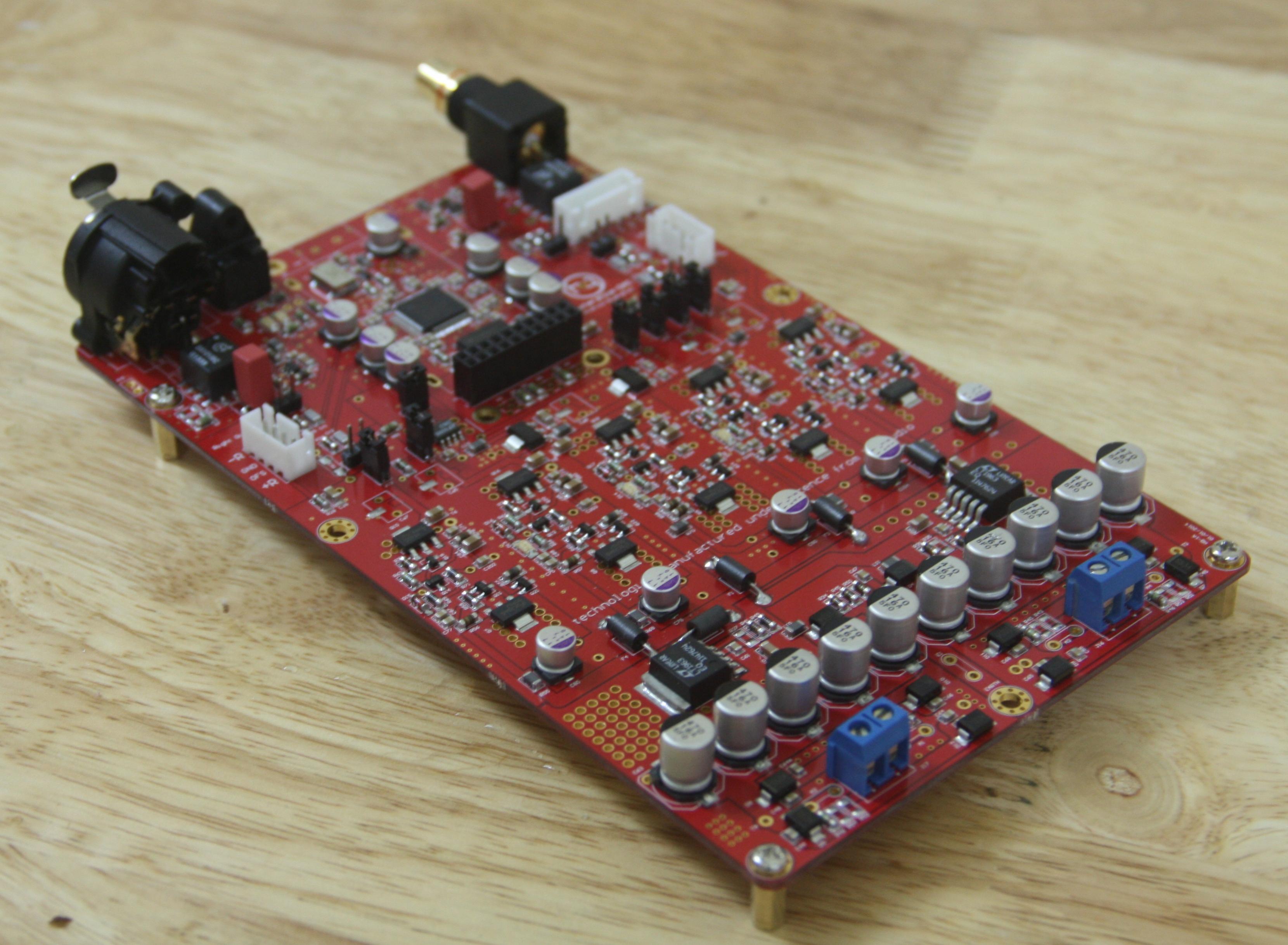

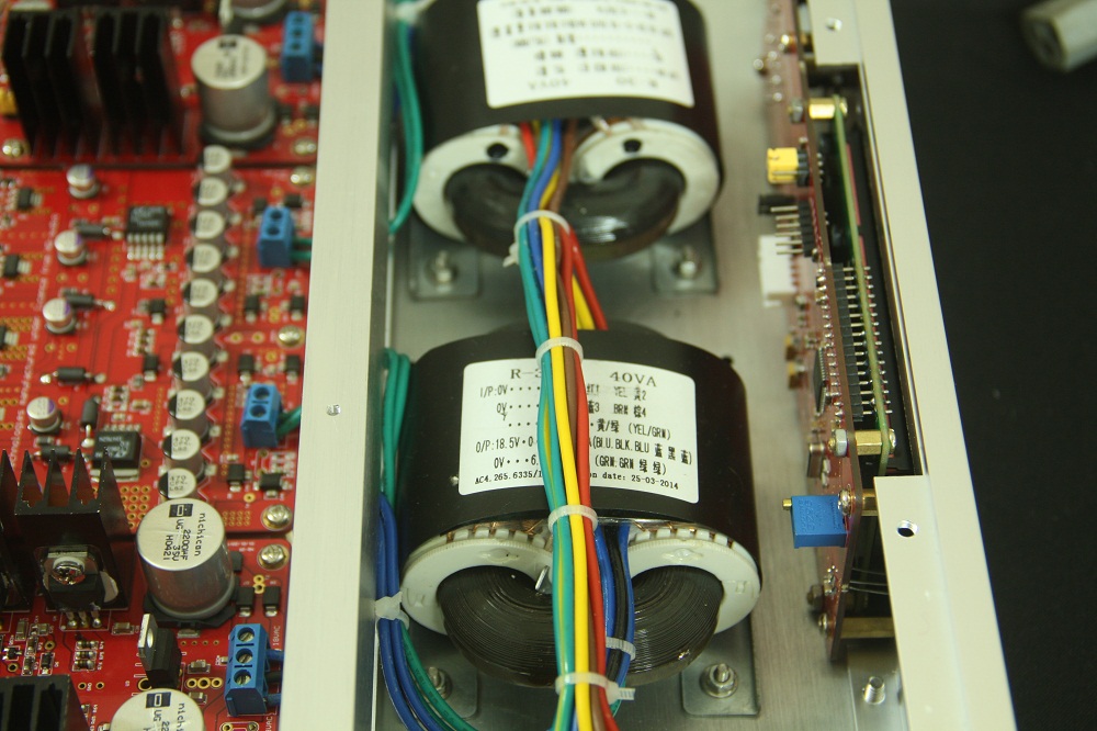

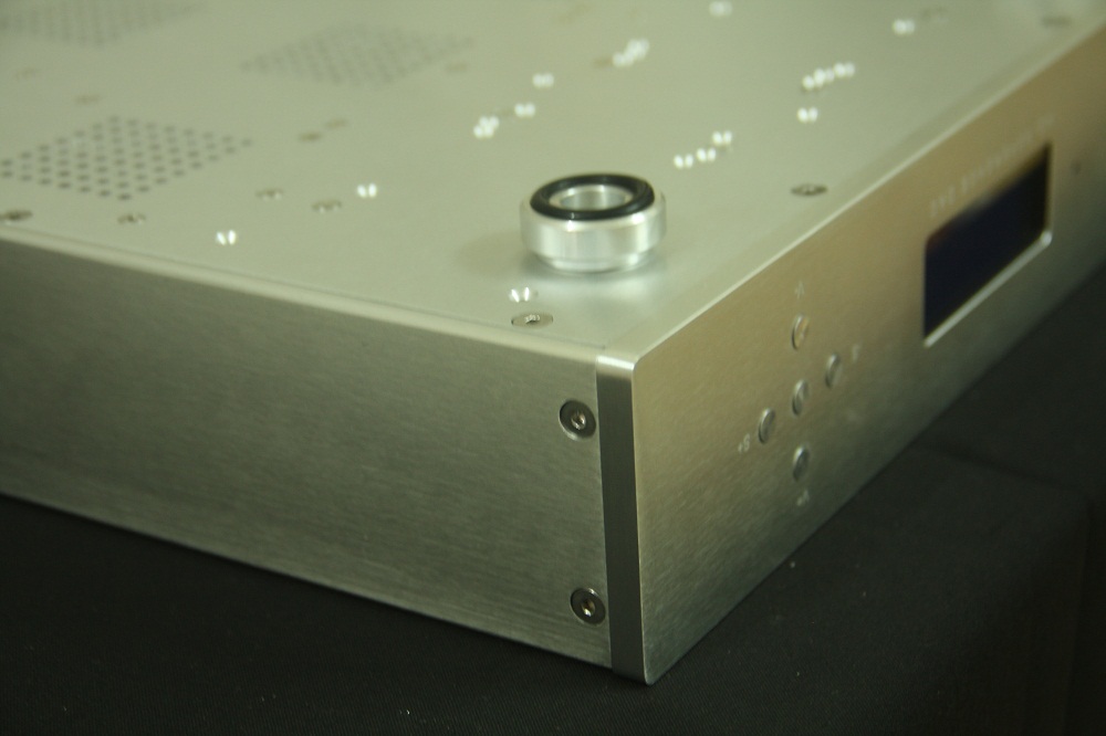

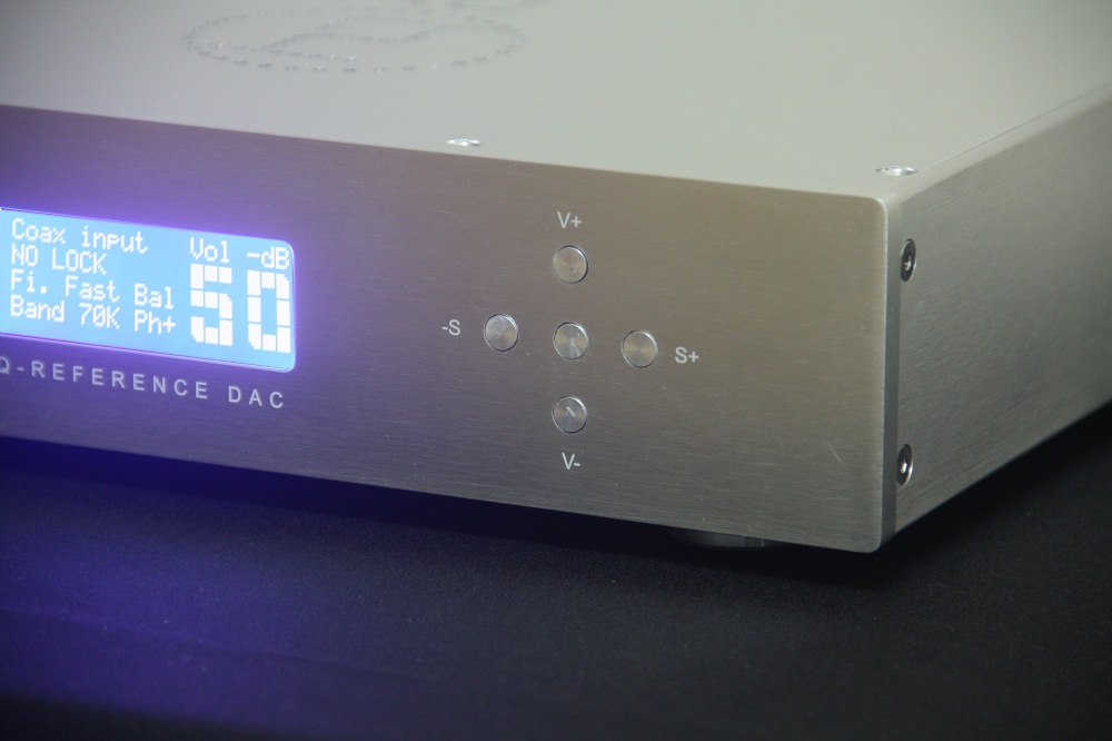

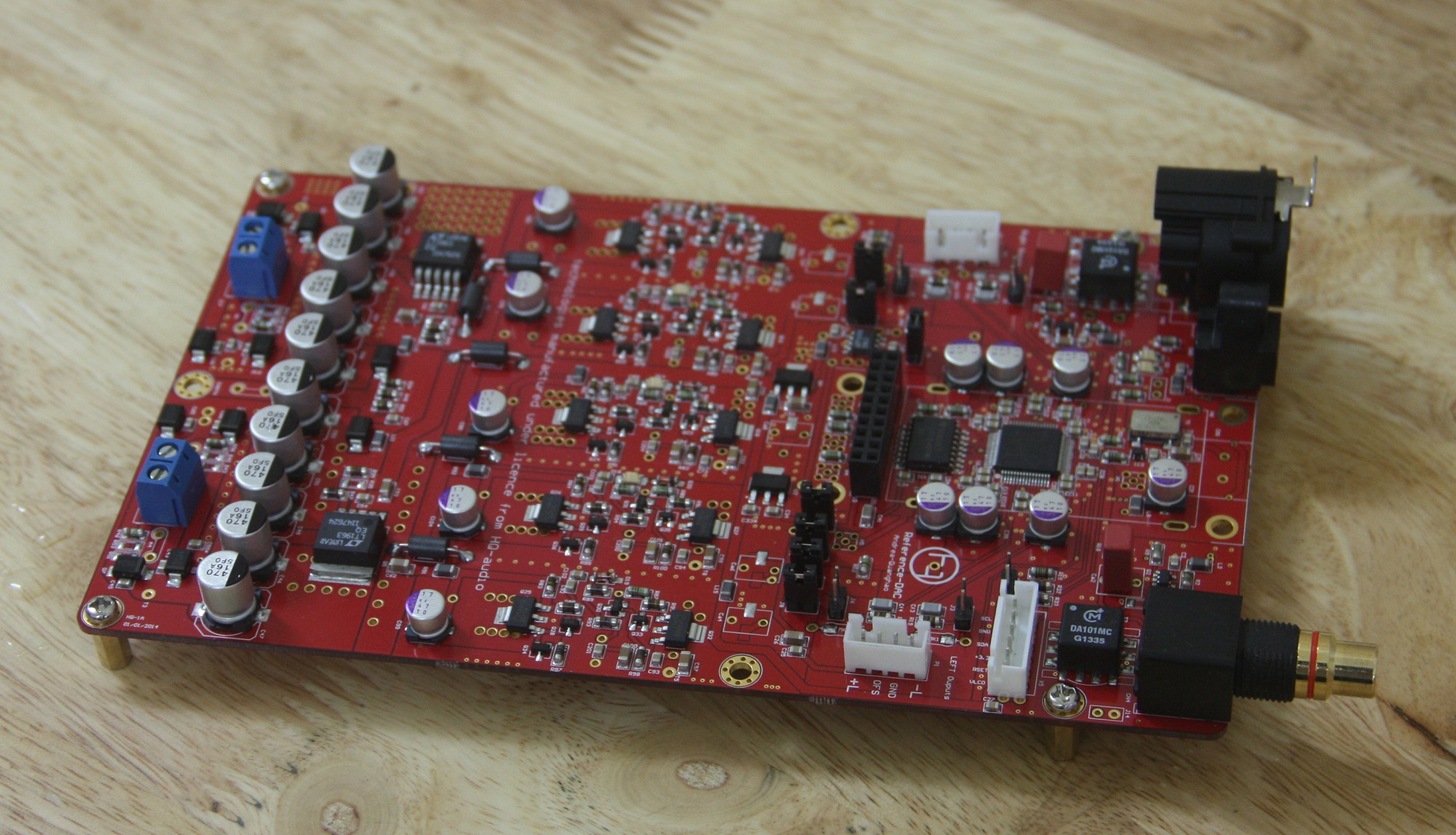

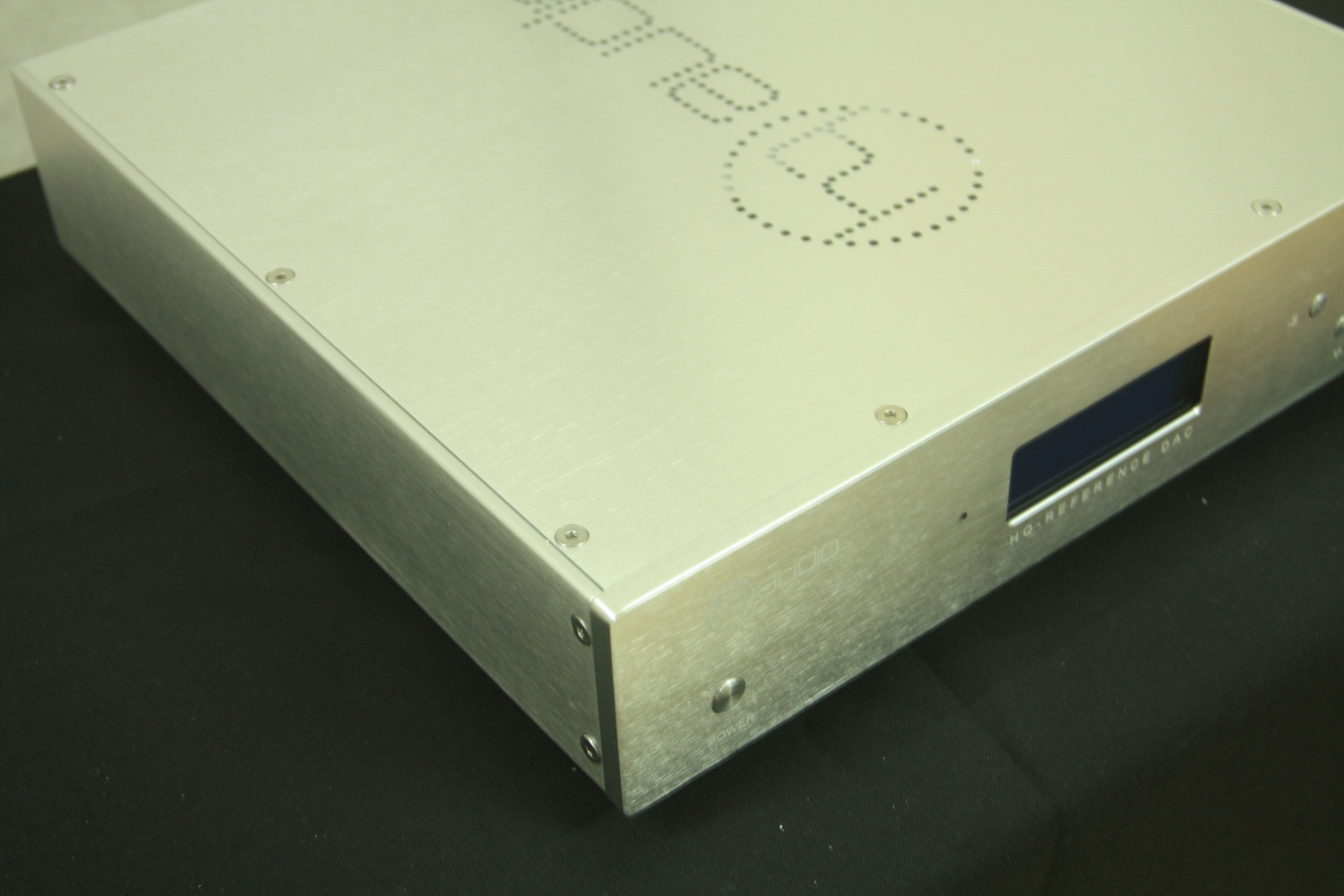

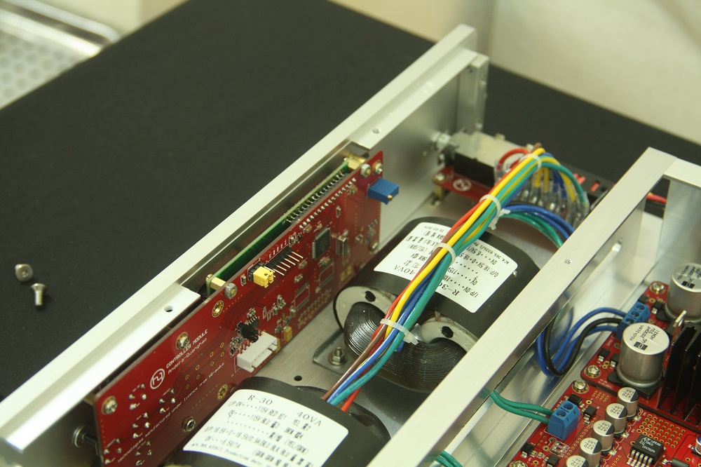

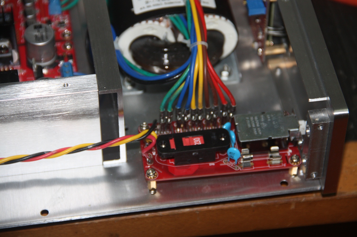

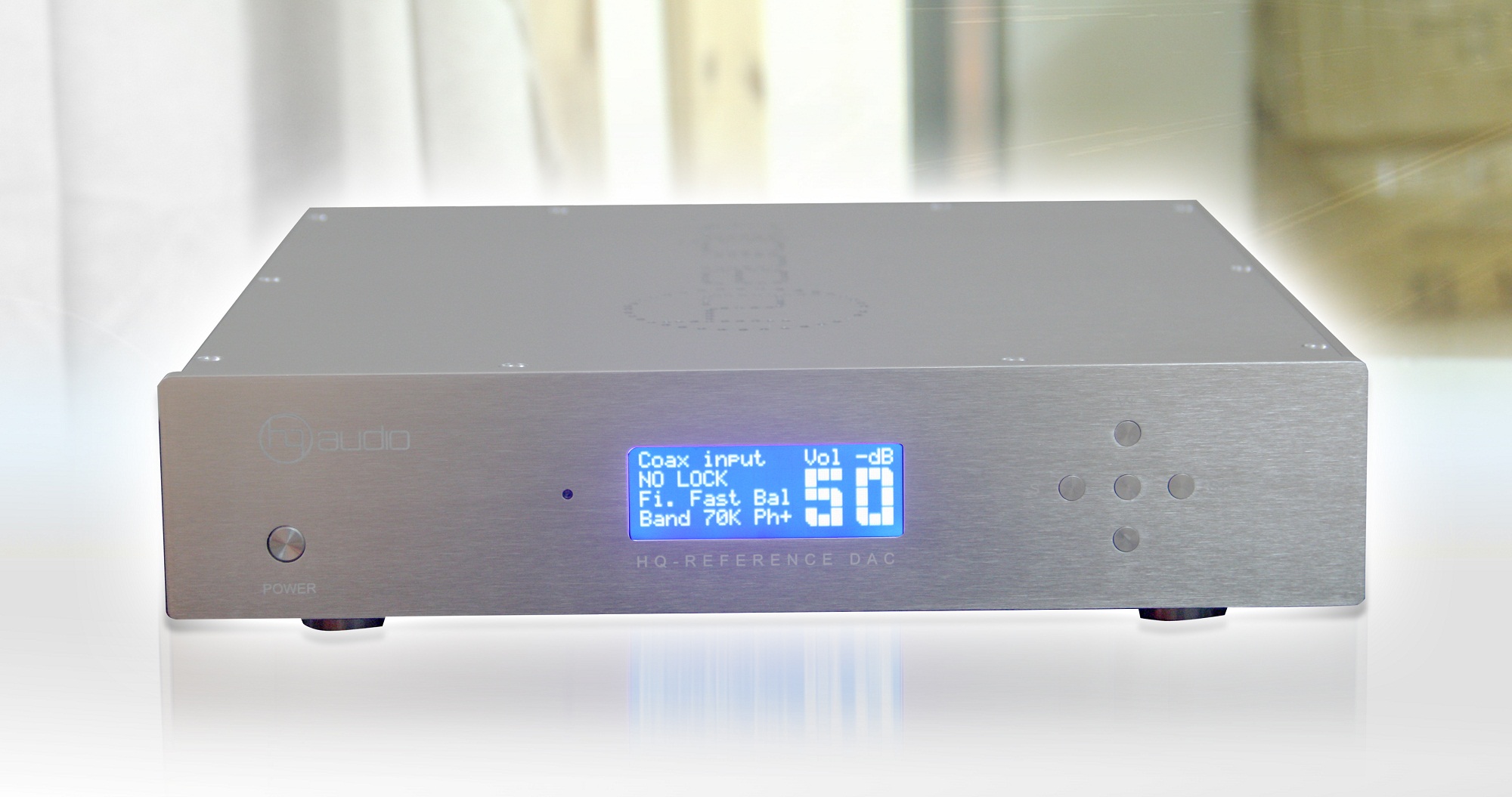

Here are the first pictures of the DAC 32 v2 invite you to view photos!
thank you
thank you

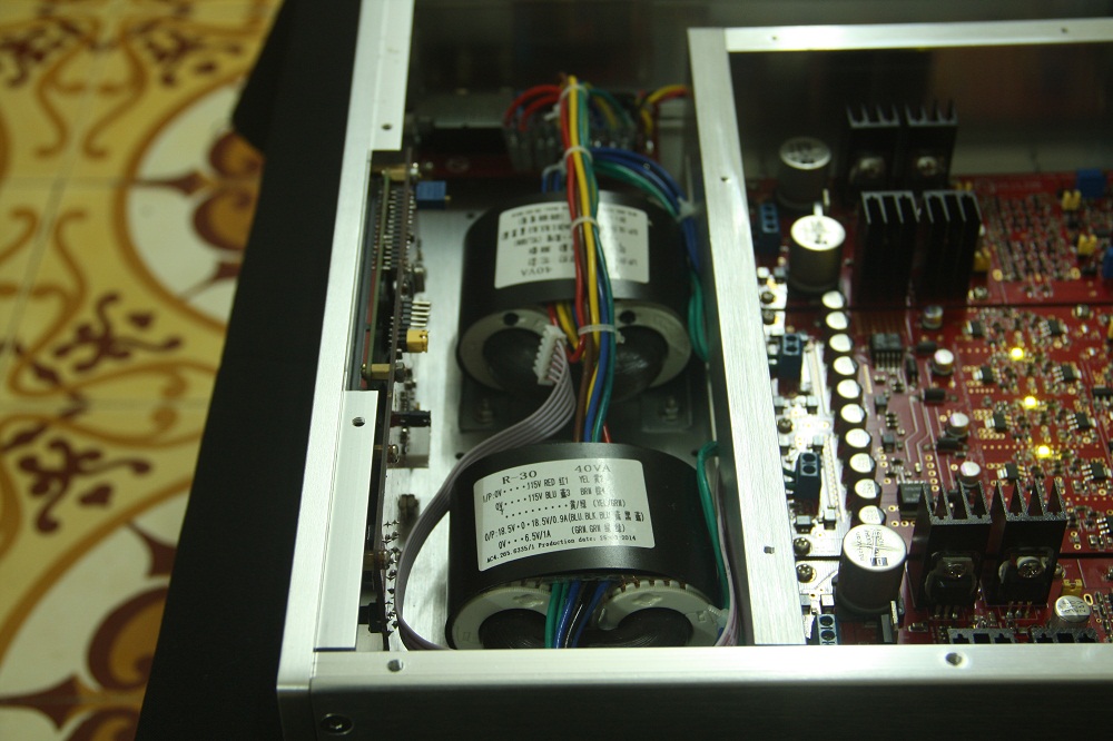

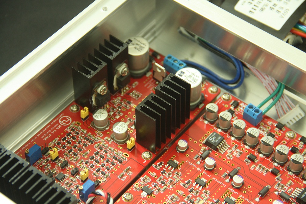

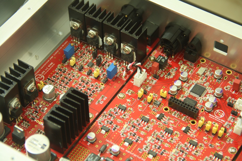

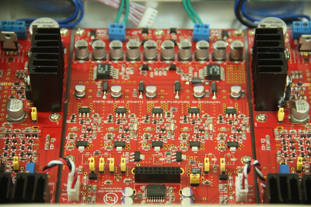

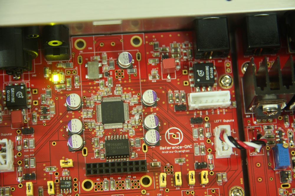

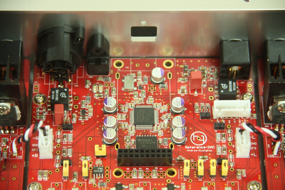

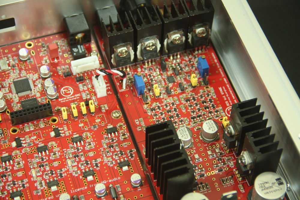

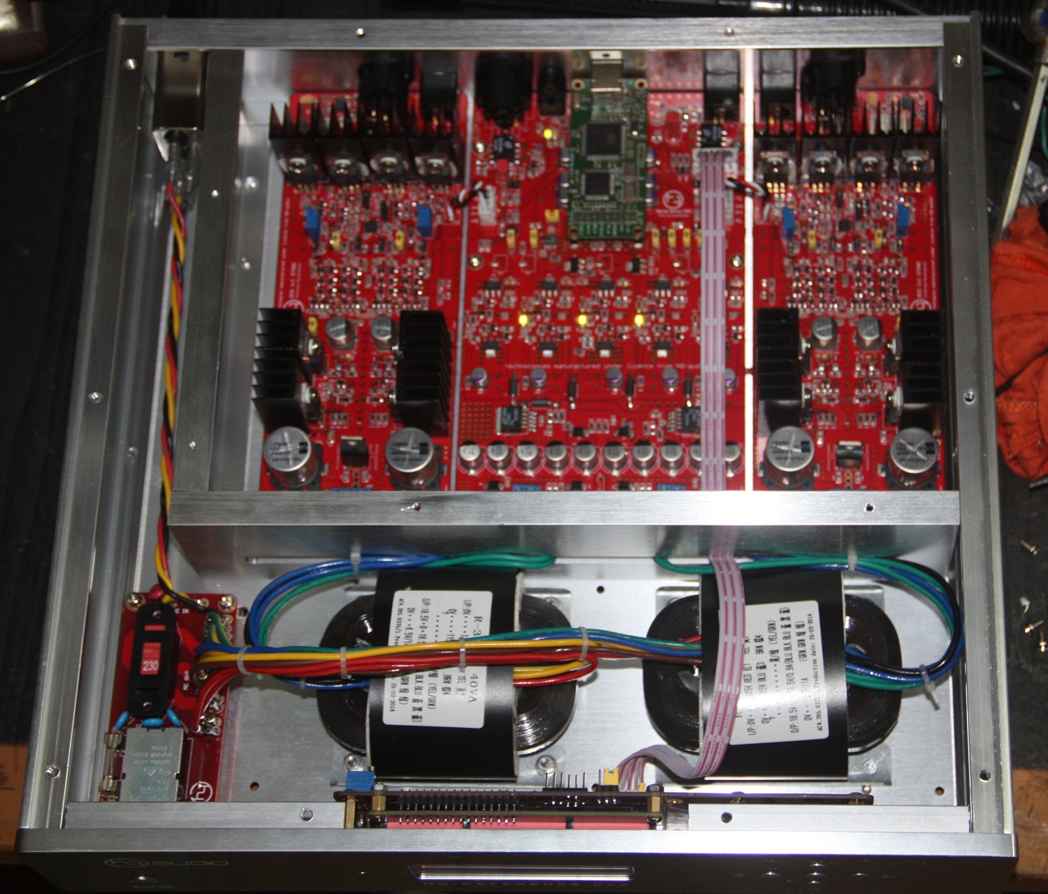

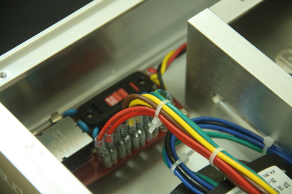

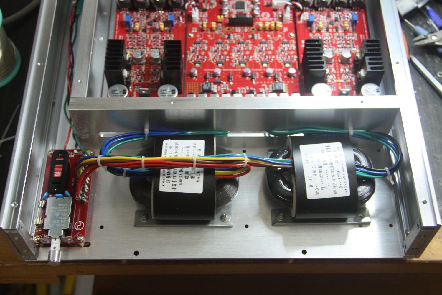

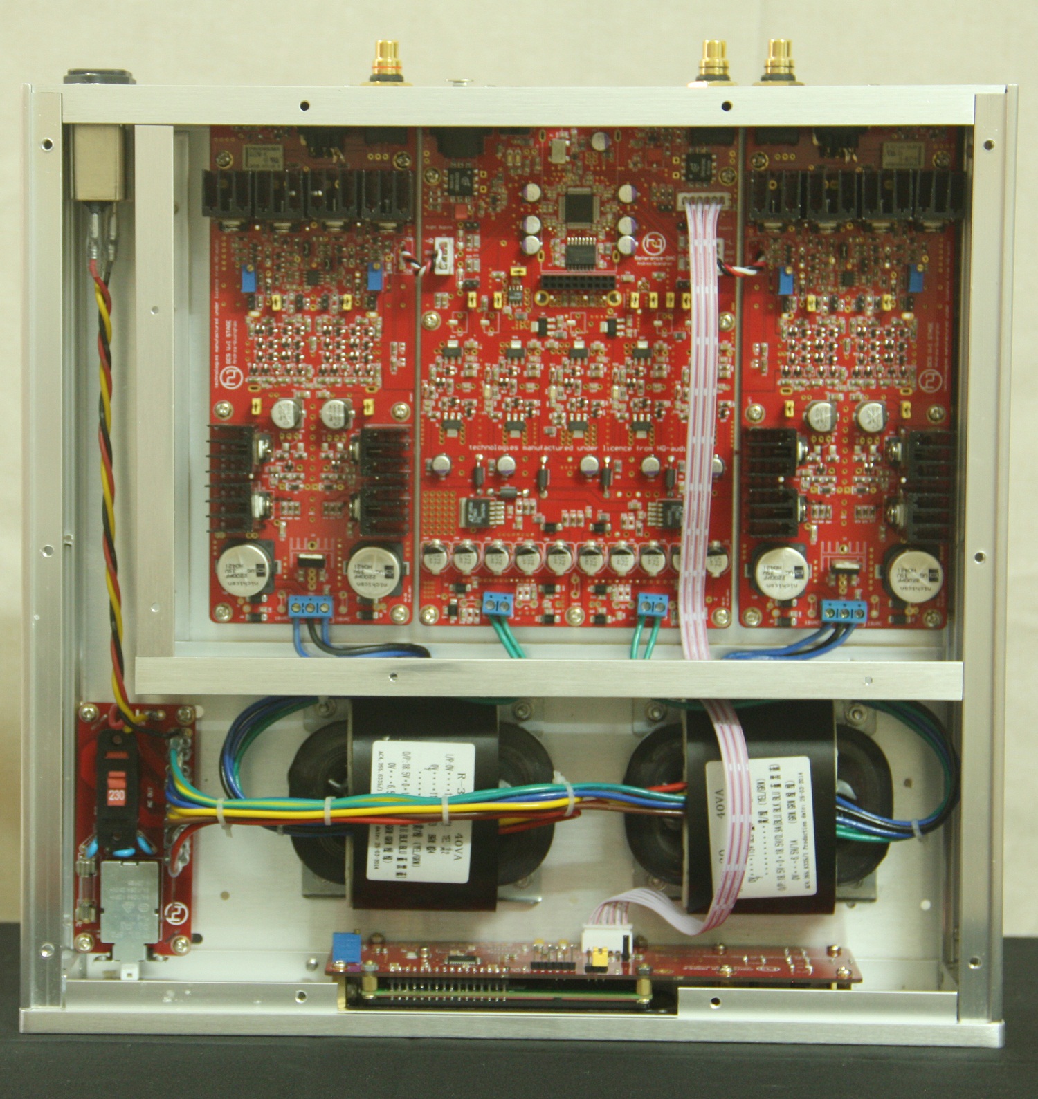

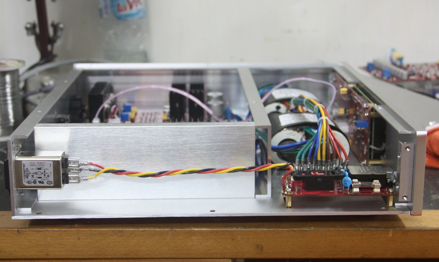

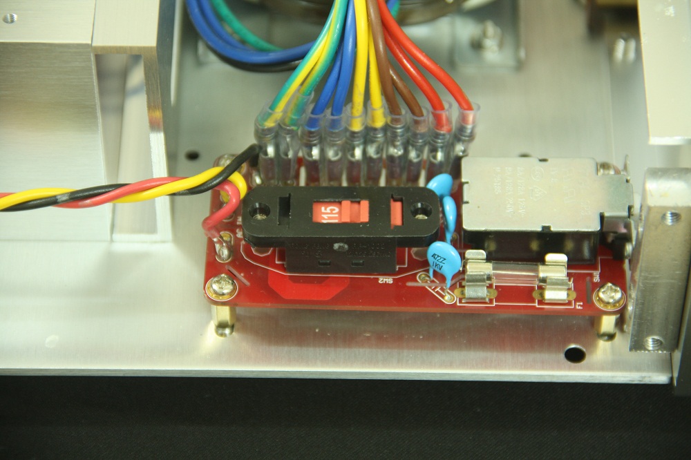

Here is an image of the internal components in the DAC 32 V2

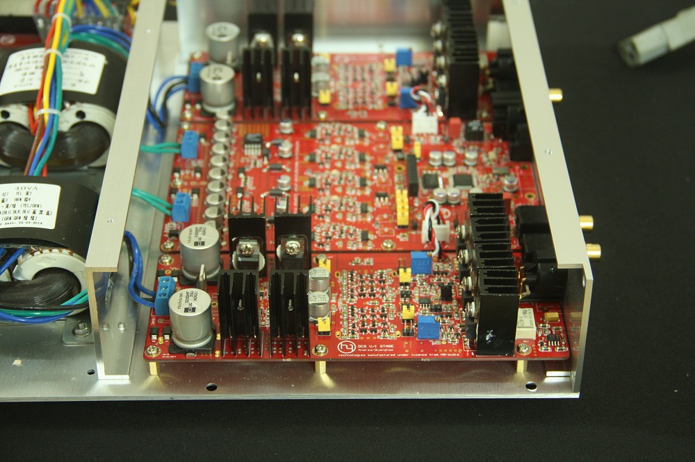

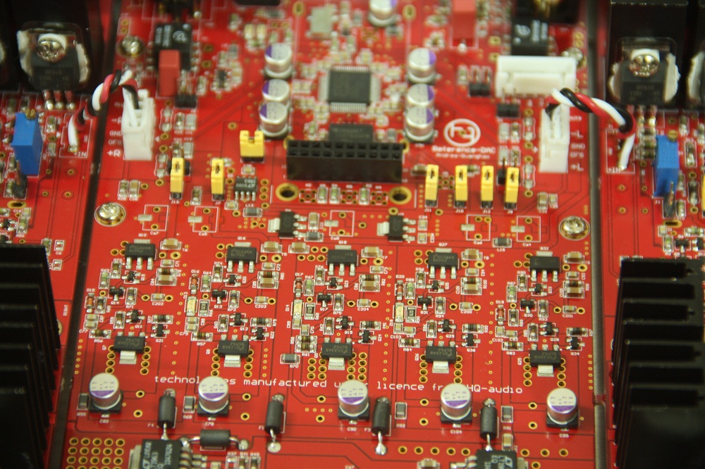

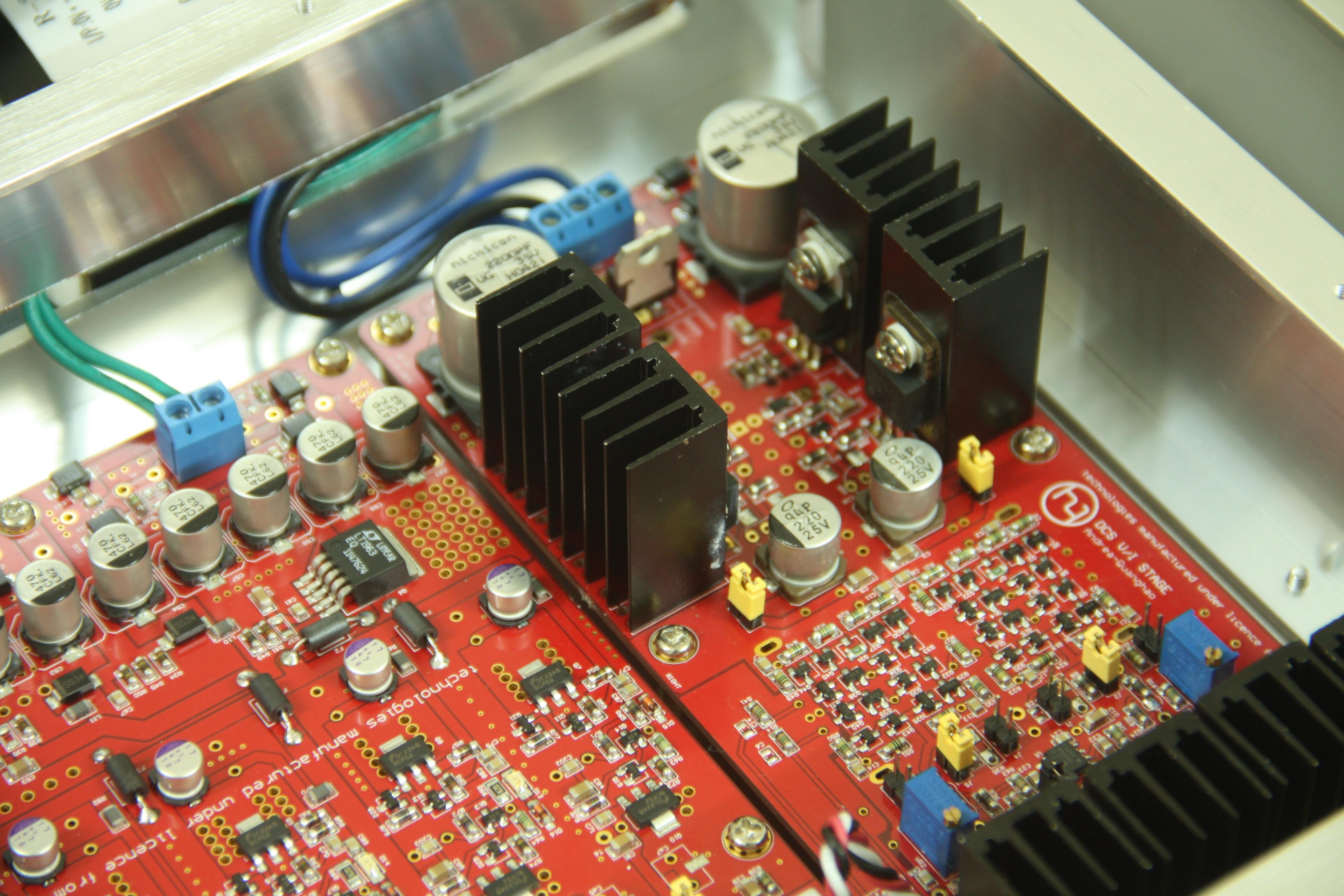

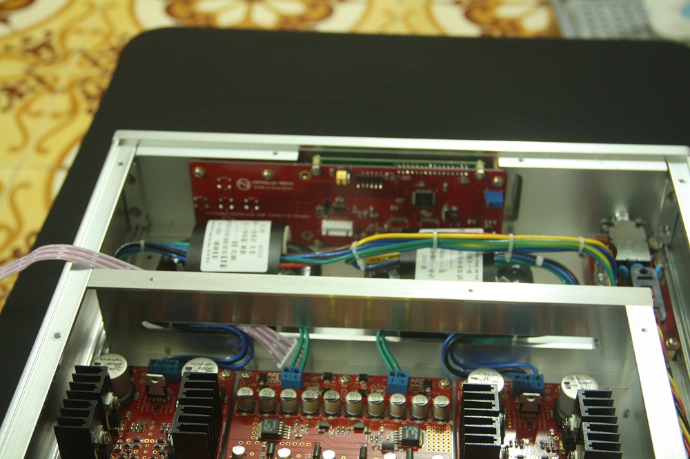

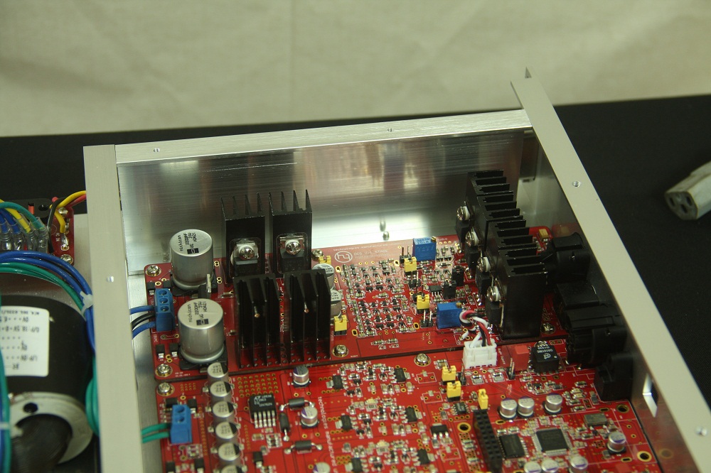

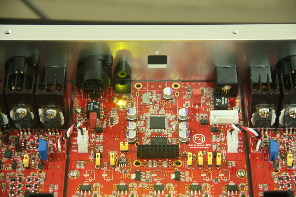

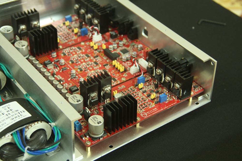

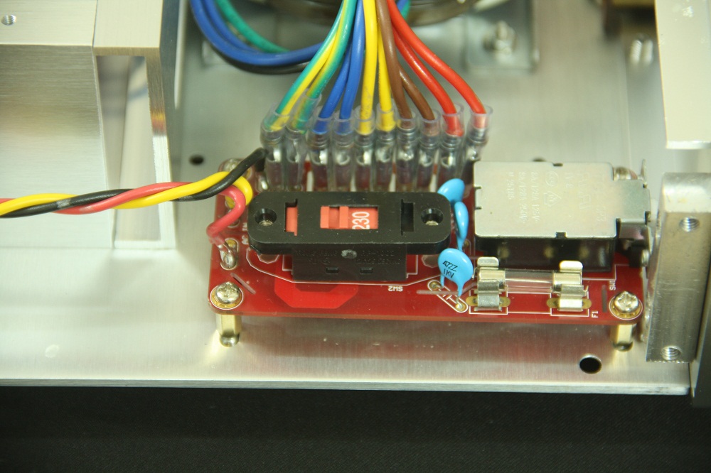

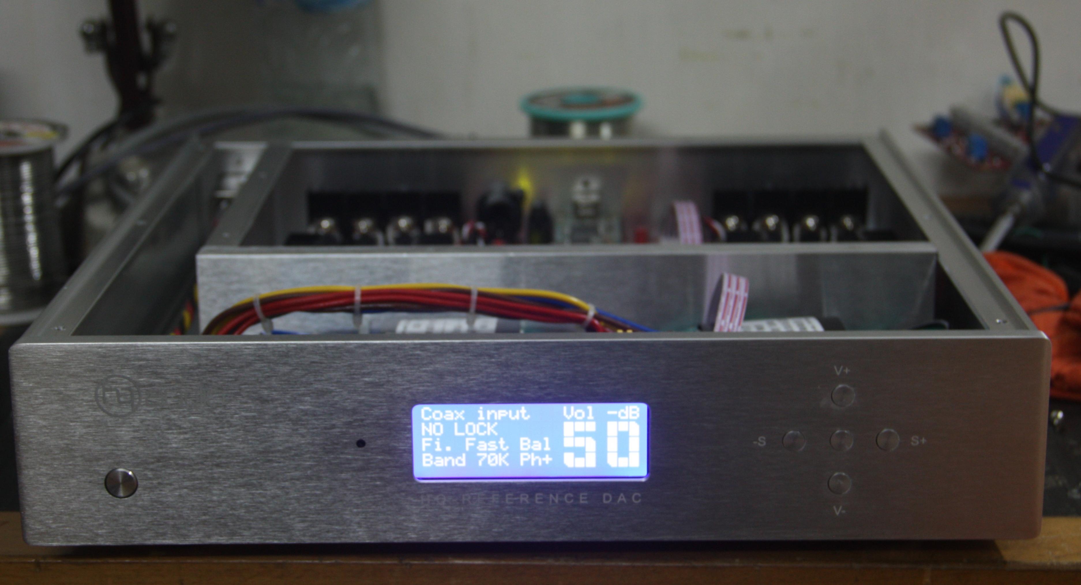

And more
Impressive, very nice work !Here are the first pictures of the DAC 32 v2 invite you to view photos!
thank you
Beautiful Job!!!!
Greetings Quanghao,
Absolutely stunning! 😀
I will be very proud to have this component in my system.
Thank you for your outstanding work on this project!
Kind regards,
Steve
Greetings Quanghao,
Kind regards,
Steve
