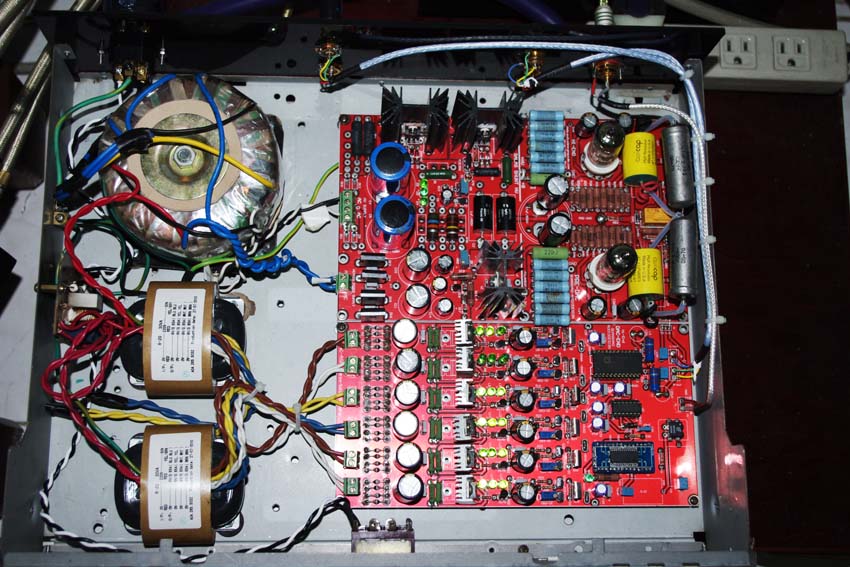

So the transformers that I need for a complete DAC & IV board would be:
DAC
R26-29 primary 115 X 2 : 0-9 X 3(0.7A); 9-0-9(0.7A) X 2
IV - Filament
R26-93 primary 115 X 2 : 0-9 (1A) X 2; 0-9 (2A) X 1
IV - SSHV
R80-36 primary (0-110) x 2 /SCN: scondary (260-230-0-230-260)(90mA), 2.5-0-2.5(3A), 3.15-0-3.15) X 2(3A) X 1
Are these correct? Thanks.

You need 2 Transformator R26-29 using the 2 x 3 x 9V/0,7A for DAC
The R80-36 you use 230V -0V or 260V - 0V por SSHV
and 2,5V -(0V) -2,5V with 3,5V -0v in serial =8,5V for filament
Klaus
Is there any assembly instructions or testing manual available? I'm not sure if there's any wire links or connections that I've missed out. I can read the circuit diagram but its very difficult to follow the trails on the PCB to make sure everything is correct.

My friend has a complete DAC-ASH
Just finished the build. Took me quite a lot time but the result is very satisfactory. So far my most favorite DAC. Much prefer it than my last Buffalo32s. Very smooth, lush mids, bass is deep as expected. Treble might depend on the tubes used. I'm currently using the Siemens E88CC gold-pins.
