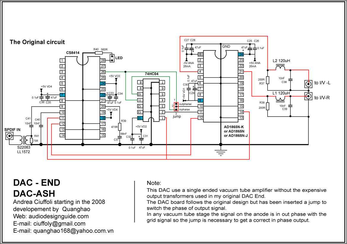

DAC-ASH (dac-end 2 up date)
This cricuit of DAC-ASH (DAC-end updat)
This circuit of DAC-ASH (DAC-end updat)

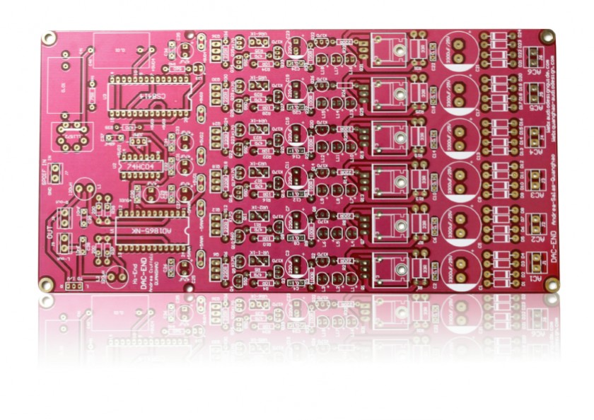

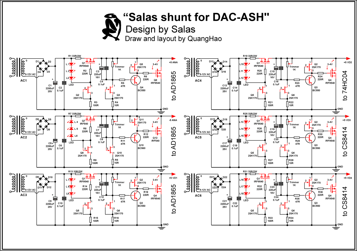

In this new PCB, I used six separate sources for each chip Salas AD1865, 74HC04, CS8414.
Please see diagram!
Forgive a beginner's question, would the DAC-ASH work without the I/V stage? Namely, would it possible to bulid using 1 PCB and "upgrade" later? or it has to be two boards simutaneously.
Yes! that is fine!

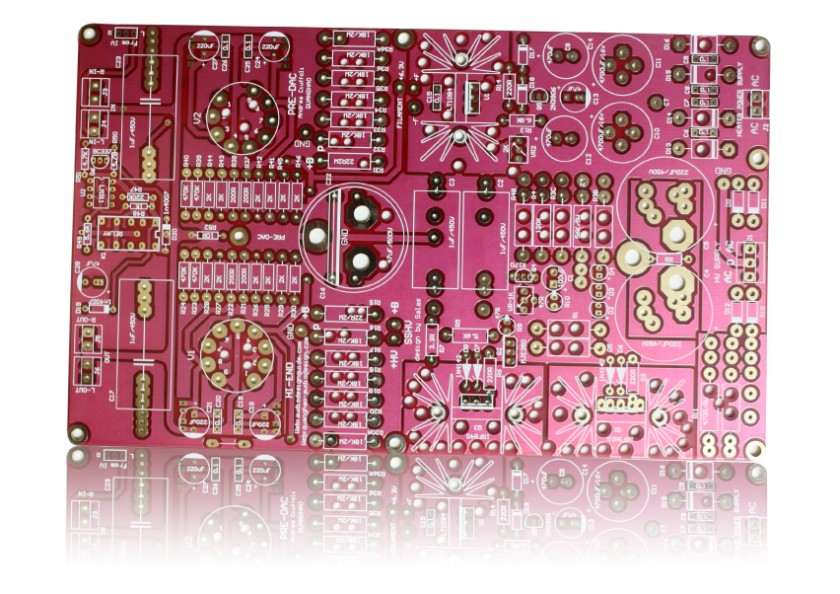

The IV stage i use parallel Composite-Triode, can use tube 6h6pi, 6h30pi, 6dj8
Yes, you can buy only the DAC and later put the I/V board or use other buffer board of your choise.

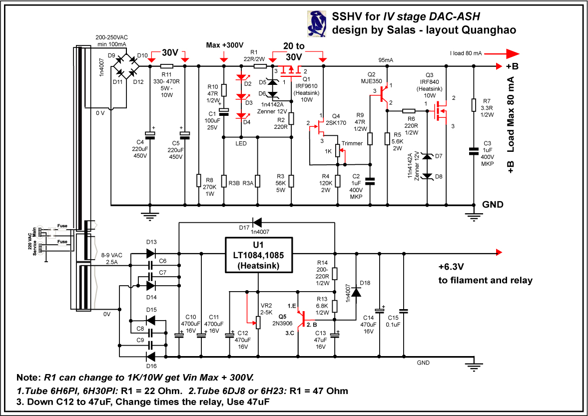

Quanghao, the circuit for SSHV posted above lists for D5 & D6 - 1N4142A but the BOM (on page 179 of the original thread) says 1n4172?
I suspect the part we want here is 1N4742 or 1N4742A a 1W 12V Zener Diode....
Is this correct and if it is could you please make the corrections to the circuit so others don't have a problem.
Thanks!
Hi! Im sorry
that is I m wrong, 1n4142 is correct!
1n4742 and 1n4742 is one, this is zenner diode 12V
My be not need this Diode, if you can not fine it , you can change Zenner diode from 6.8V to 15V, 1/2W.
SSHV many time not need this diode, but It is still very excellent!
