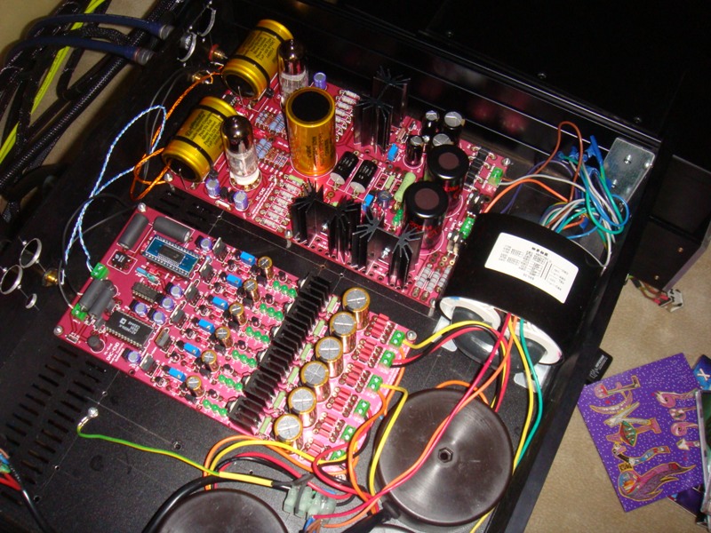

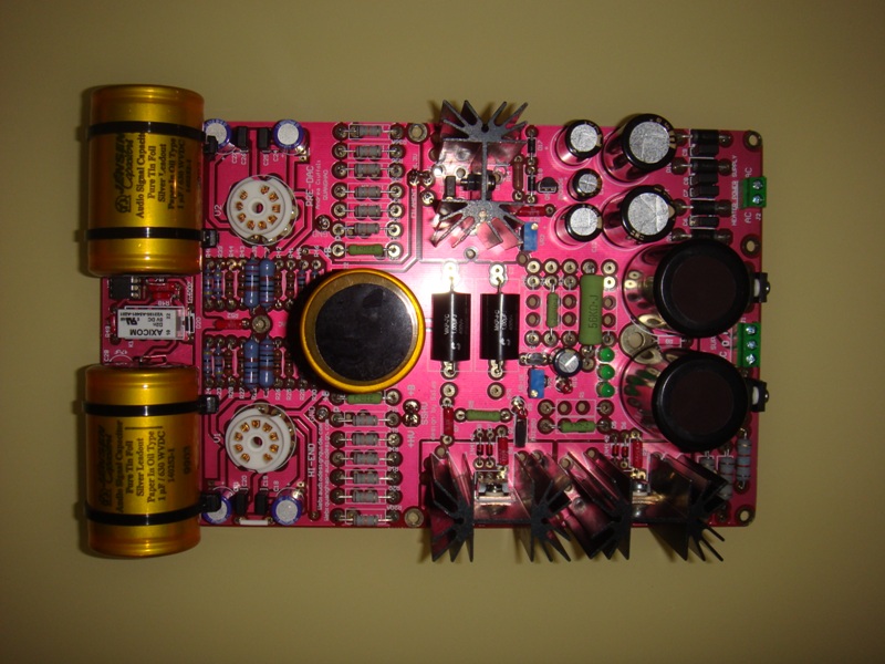

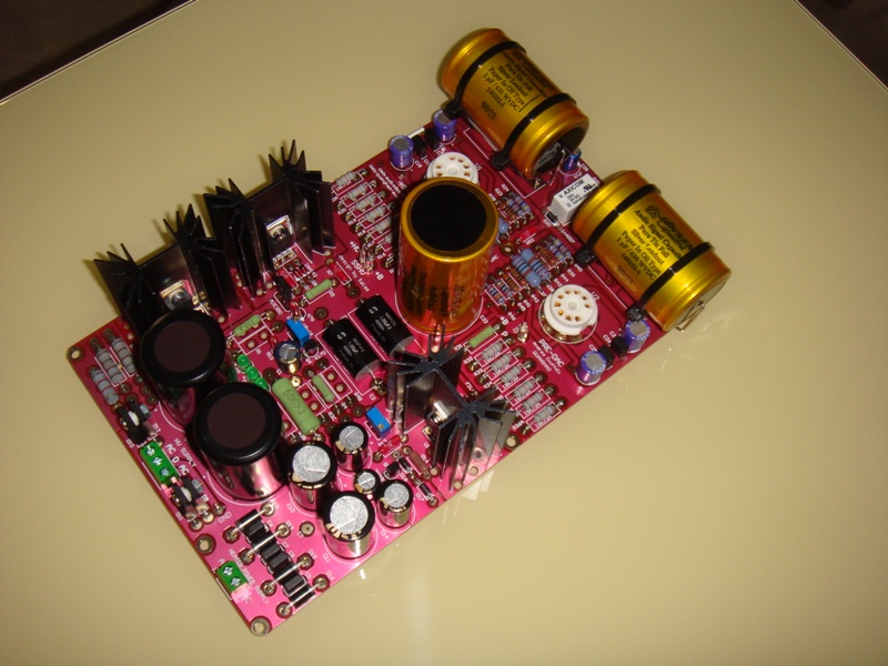

You see in this image
Pictures with my DAC END 2! No final case!
I used hi-end components...AD1865N-K, RA resistors, AudioNote/Shinkoh tantalum resistors(I/V), Kiwame power resistors, Black Gate, Jensen, Nichicon, Wima Black Box, OS-CON, Solen, russian teflon capacitors, MUR ultra fast rectifiers(12-25ns), Electro-Harmonix tubes 6H30Pi(pair)...and more! On DAC END2 PCB, across each MUR rectifiers I used 0,1uF/100V red Wima.

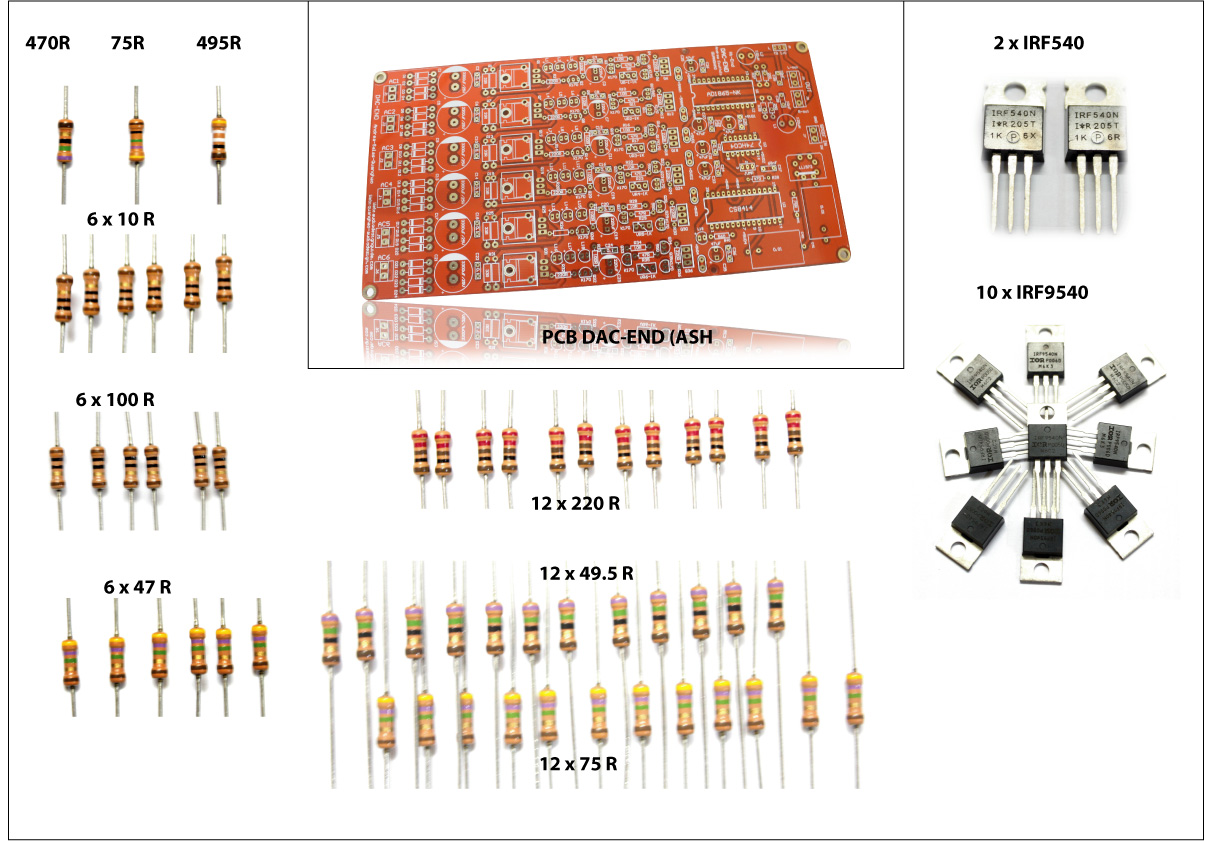

All resistor for the DAC
no 200R Cadoc
price: 10$ + 5$ shiping an free paypal!

Hi Hotzman,
What is the secondary voltage for the R-core Transformer and where did you buy it ?
Hi!
DIYCLUB
R80-36 !

Thanks QuangHao for your assist, yesterday I got DAC's resistors pack. It's save a lot of my time
Yes! 33R use
VISHAY / DALE RN65D SERIE : 75R// 49R
Hey, the RN65D power handling is 1/2 W, not 2W. Is this a typo in the BOM?
So it should be 33 ohm 1/2 W. Please verify. Thx!

Hi!
I wanted to excessive safety!
actually consume 66mA with a voltage difference 6-7V.
Resistors 33R, such capacity needs: 0066 x 0066 x 33R ~ ~ 0.144What (min)
than 1W had enough!
