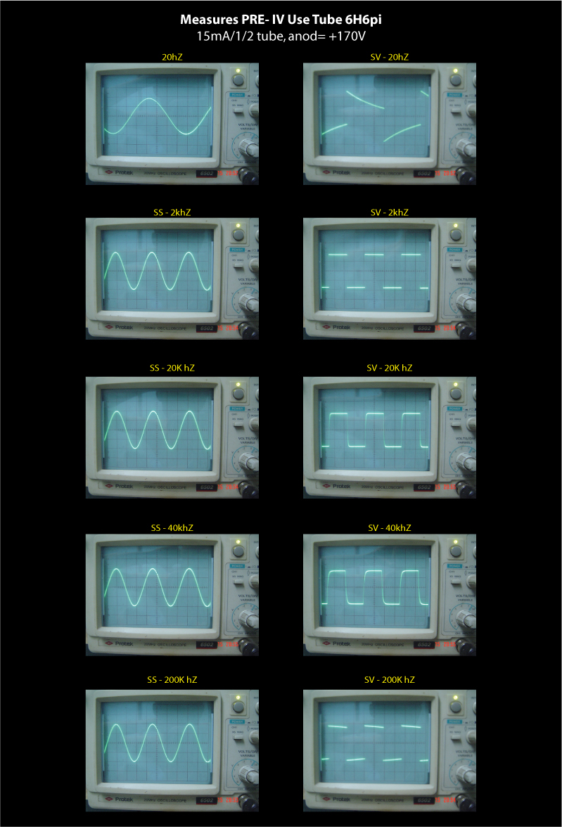

measured parameters of I / V stage DAC-ASH

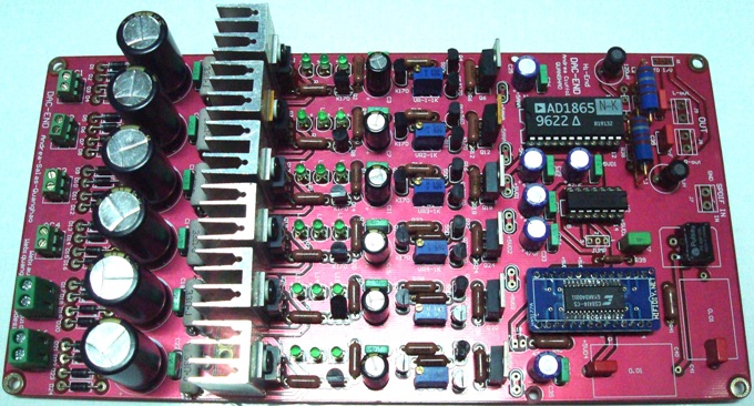

I got to the final! But something strange happens to 6.3V power supply!
AC voltage is 12-14V/ 3A! After about 15 seconds the relay flashing and DC voltage increases and decreases between 2,5V - 6,3V! I use R 80-36 R core transformer from DIYCLUB! Which may be the problem?
Thank you!

12-14V AC, it´s not a little bit to high? All the scheme says 6,3 -9V.
Klaus

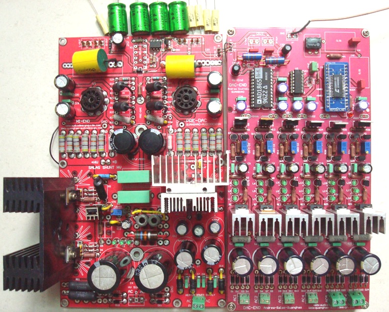

I started DAC! And....sounds damn good!!! I am amazed....
