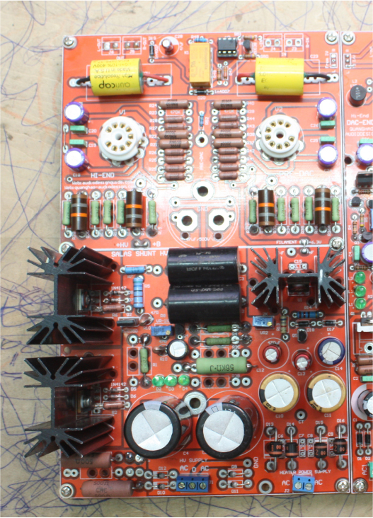

I have set R1 to 20R (33//47R) and Voltage at R22, 21,37,38 =4.1-4.2, and Voltage at anode 89-90V, B+=197, should this be ok, or need to drop R1 lower to increase B+ ?

No!
R1 set current for SSHV Supply =22 Ohm, Ia ( I total ~95-100 mA)
So Iv need total= 80mA, 1/2 Triode 6h30 need 18-20mA.( the sound is the most )
And Voltage at Anode =90-100V,
So voltage at R 22, 21,37,38 =3.8-4V , and R =200-220 Ohm, it is ok!
You see it???
Ok I got the correct anode voltage 90V now. So the current through each triode is 2x20mA ~40-50mA, power on 6 anode resistors //18K total=3k, is IxIxR abt 7.5W and per anode resitor 7.5/6 ~1.25W less than the 2W rating, but resistors are quite hot, is this ok ? Also the 22R 2W dropper resistors R15/R31 are also quite hot.
You use 20ma for 1/2 tube, that is fine for the sound!
3k x 0.04 x 0.04 = 4.8W, so 6 x 2w = 12W, that is ok, no problem!
if you do not feel you can add a resistor 18k again, and down + B to 195V
And always keep 40ma for one tube and Anode 90V.
Can you tell me the sound it?? thanks!

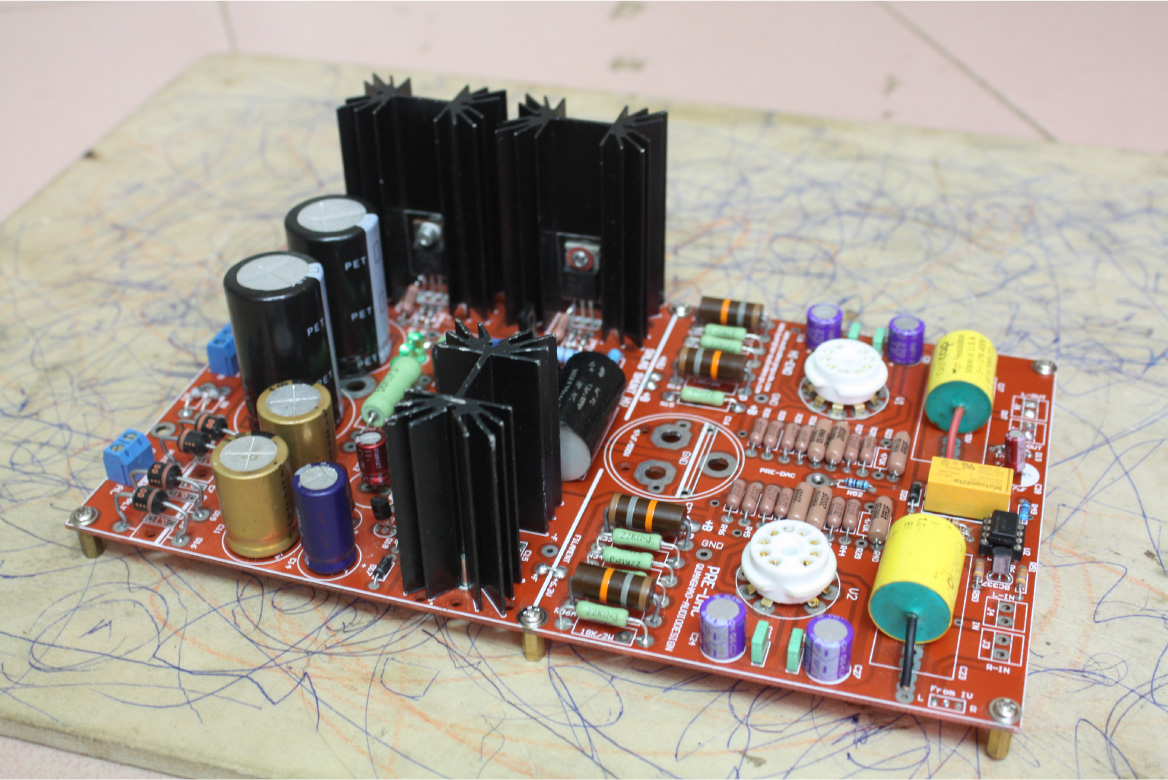

This image, you can see IV stage

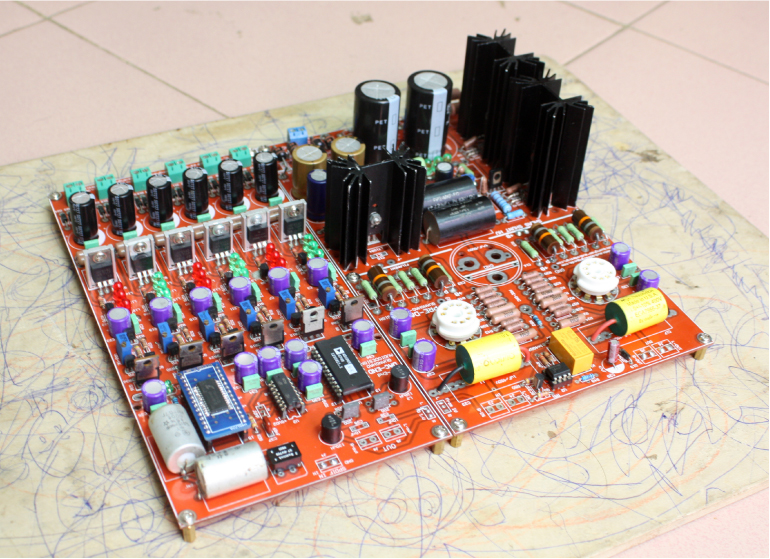

Hi All!
you can download schematic DAC and IV stage, Phono D3a, ...and the bom of them in this link:
http://quanghao.com/product.php?id_product=39
