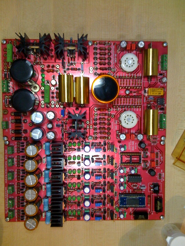

Hi Quanghao,
I am in the midst of building and testing the DAC board. of the 6 regulators, i can adjust the voltage to +5/-5 except for one where I can manage to get 3.85V no matter I turn the trim pot (1K).The led string is lit. The AC is 9v about 10.6 w/o load and dc at diode is 13.6. anu idea what could be wrong ? thanks

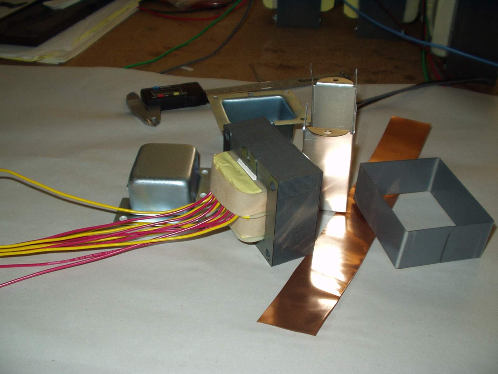

Hi everyone,
I have finally managed to put to rest all of the alligators that have been in my way over the last 4 weeks and can turn to something that interests you. Pharod's first transformer has been laminated and tested and will be corrosion proofed over the weekend. This is a process that takes 4 days to cure. Then the assortment of pieces you see in the picture below will be put to good use.
Having located all of the materials squirreled away 15 years ago, when the Mackie 3204 mixing console was finally removed from the market, I can now actually offer a finished product. The pieces you see below are a power transformer with the primary set for 120 volts AC, core flux density of 8 KG using M6 core material and no load to full load regulation of 2%. Safety agency approval, as a professional product, under CE 6500 is the build standard. This means no one shot thermal fuse, but full creepage and clearance and 3500 volts dielectric withstand primary to secondary and core.
The rectangular metal sheet is an M6 core suppression band, the strip of copper is mounted around the coil and up over the core suppression band and the whole thing fits into the end bells and channel frame shown. The secondary leads will be separated out, by winding, with pieces of shrink tube. This is the $90 transformer, and now you know why.
I have what I consider four firm orders for this transformer and we will wind the remaining three the middle of next week, with projected shipping two weeks after winding. We have a tiny sliver of time to do this in, so, if more of you than Klaus, Daniel and Quanghao want one, in anything like a reasonable amount of time, PM me this weekend. You must tell me what voltage and frequency your particular transformer needs to run under.

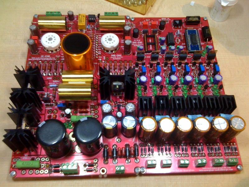

Just wanted to post the completed boards in case it helps others. I'll be upgrading a few caps but for now this is it!
So far these have been a very well designed boards!
Thanks Quanghao
