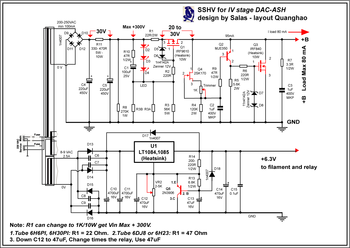

I've completed the DAC but my High Volt transformer is overloading and getting too hot. I can get 230V for B+ but R1 is too hot to touch and my rectifier diodes are blowing all the time.
Quanghao, do you have the circuit for DAC ASH and SSHV for I/V. Its different from Andrea's original circuit so I don't know what is wrong.
There is a load somewhere which is overheating my transformer.
You see all Circuit in the Page 1 please!
And circuit SSHV for IV
What is the R1=? 22R??
it is not hot!

I'm getting about 115Vdc across R11, that's why it was so host. Anyway the transformer died. One AC is 285Vac and the other is 2Vac. Its burnt I guess, have to get a new one.
I got the R80-36 230V transformer from diyclub.biz. Do I connect both the AC and 0v?
The diagram shows connect 1 AC and 0v.
AC = 230v?/ , DC~280v-290v.
R11= 470R, I total ~ 100mA, R 1= 20R
So V on R11= 470 x 0.1mA ~~47V
Why V one R11 or you= 115 V??
im sure there are problem with R1. you can check it please!
