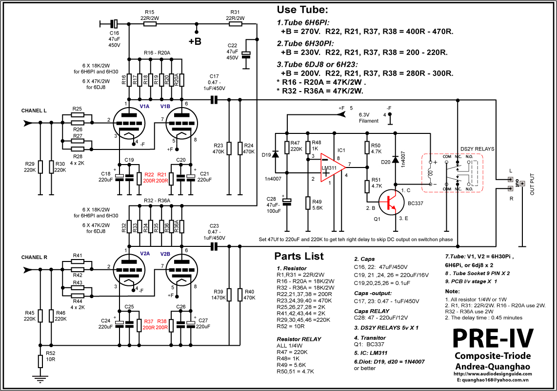

I'm changing from E182CC to 6n6p. With E182CC inside I press 15mA through each tube by using a CCS. How much juice should be sent through the 6n6p, or how much current does one tube suck through the anode resisors.

Hi, I know what you mean, but currently I'm using 2 peace of E182CC, each one fed with 15mA, just as Adamus and Andrea did. And btw with anode resistors in place they were sucking 15mA as well. This led me on that way and in my opinion the sound is very good. Btw, today in the evening I'll compare the one with CSS vs the same DAC without CCS. So we will see.
In a future application I want to try 6n6p (I'm reworking my second i/V board for that) just for fun. I want to know the sound of 6n6p. Since I don't want to setup this with anoderesistors first, I have no idea about the needed current. So please, if one measured, please let me know.

the 6n6p wants 20-25ma per side. Running traditional driver current of 5-10ma does not make them sound good. Think of both sides combined as a el84 and design as such.

Per side means one triode system wants to see 20 to 25 mA!?!
That is a lot juice, at about three times my E182CC setup currently sees. I have my shunt running at 80mA and after Salas I think 100mA would be max, that made 80mA max for the tubes. I'll test different current steps to find out best, but thanks for the number. Now I know that I have to raise my shunt current.

After the old Ohm the E182CC takes 15mA (180V (delta B+ - Plate V) = 12000*0.015 This can be measured as well.
And so the 6n6p would take 60mA after this, since the Anode resistor results in 3K Ohm.
HV shunt gives 80mA, so this shouldnd work. So there micht be a failure in my thinking. Please enlighten me.

1. E182CC it i good ad Anode: 90-125V , use parallel, Ad R k=330R
+B=260V, R a= 10K-11K, 13mA/one chanel, you can try do that!
2. Or use basic design by Andre and me in the DAC-end 2 use tube 5687 ~~E182CC. Fine Circuit in this link:

I strongly think there is a big misunderstanding 😕 So it seems I have to try to build my 6n6p stage right after your scheme with Anode resistors instead of CCS and see what will happen. Thanks for help anyway!
Btw, on Thursday we compared Anode resistors vs. CCS feeding the E182CC. The version with resistors had better trebles, the CCS had better bass. After that comparism I'd prefer resistors. But later that evening I found out there was a failure in the HV shunt of the CCS version. Due to thermal drift of the IRF840 the voltage rose too much, which further caused very low HV shunt current. The tubes were fed by 30mA and the shunt was running slightly below 40mA, although I used R1 = 22R. After Salas it should have at least 20mA headroom. Solution would have been to turn down the voltage or rise transformer voltage but we we were not able to solve the issue on that day. So I think we have to repeat the comparism.
