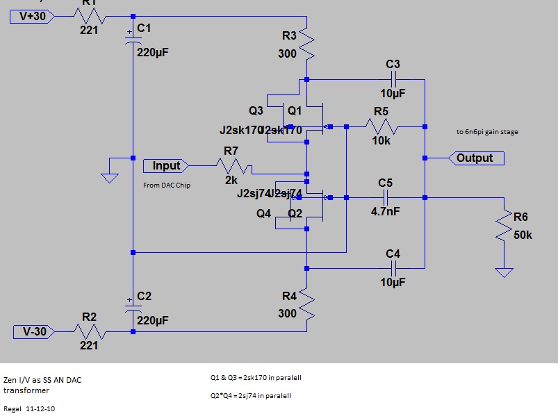

I have a crazy idea I've been working instead of expensive transformers. Basically its the Zen I/V converter tuned down for low gain and super low distortion, then the 6n6p gain stage follows it. I can post the spice simulation if anyone is interested.
Here it is with a +-1ma Dac input it gives 150mvp-p, then this is feed to your 6n6pi tube stage gain of ~18 to give 2vrms. The advantage is the input impedance is only 7 ohms, think of it as an $800 AN transformer, doing the same steup but with less distortion and of course the benefit of the lower impedance load on the DAC.Letting the tube take the brunt of the gain duties allows the I/V to be biased for negligible distortion as shown here. Only disadvantage is the interstage coupling caps. I'm not proficient with PCB cad so was planning on breadboarding when I get time..
The concept is using the Zen as an expensive AudioNote step-up transformer. I would power with shunt regulator and the JFet quad should be matched as close as possible. The output caps can be reduced to .1 uF.
