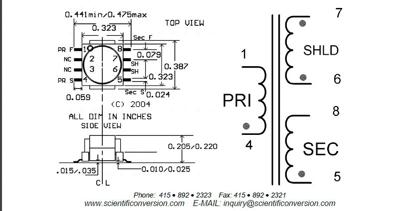

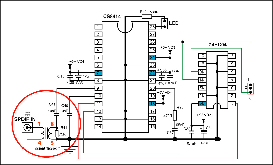

I'm also stuffing and soldering the board. A question on my SPDIF transformer. Here's the schematic.
1, 4 go to input. So 4 goes to + and 1 goes to - ?
5, 8 are the output so 5 to end of 75R that goes to coupling cap for receiver chip and 8 goes to opposite side of 75R?

Sorry I don't understand. 4 goes to the neg of the input? 4 & 5 have the dot which I always thought goes to the +.
So, again, with that in mind is my question correct? The 75R side going to the cap has 5 on it and the other side has 8 on it.
BTW, this is a SMD device from Scientific. It doesn't plug in.
From a transformer site: "The dots tell you that when current is flowing "in" to the dot on the primary side, that current is also flowing "in" to the dot on the secondary side as well, or if current is flowing "out" on one side it is flowing "out" on the other side as well."
The pinout of the PCB is reference to Lundahl LL1572.
I think when you use the SC transformer, you better reconfig the pinout, that means, pin 1 to the GND of the SPDIF IN and pin 4(with dot) to the IN of the SPDIF IN, also the pin 5 to the input of the 0.01uF(C41), and the pin 8 to the output of the 0.01uF(C40)!

Thanks for the reference. But why wouldn't 8 go to the INPUT of C40. I guess I am confused.
If you look at the schematic of the Dac end.... According to that one leg of the input transformer goes to ground rail (on one side of the 75R resistor) and the other to input of C41. So pin 5 goes to C41 & pin 8 goes to ground? Right?
hi! you can see in the image!
Or 1 to GND of Spdf. 4 to in
8 to GND, 5 to C41
