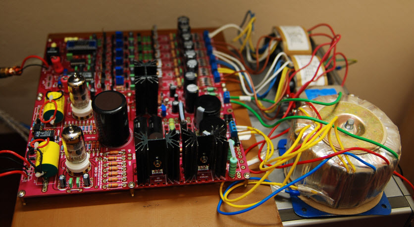

Post 34, 43 show one orientation.
Pots 88, 111, 127 show the opposite orientation.
Which is correct?

Sorry I'm bad with the orientation symbol of the trim/variable resistor. Is the arrow on the symbol point toward where the adjuster goes? Or away from where the adjuster goes?
I've put these in backwards in other projects before and had to unsolder them which as you know is a pain.
I am totally confused by your answer. I know what a trimmer does. Some boards have outline for where the screw should be oriented. Yours just has the schematic symbol. If I look under the board and see the voltage coming in I guess that is where the screw should be? Towards the front of the Salas shunt? Like 34/43 post?
When I did a test it appears to work better with the adjuster toward the input of the power supply.

Last question still is regarding the input SPDF transformer. Pin 8 is going to board ground. Shields need to go to board ground. Can I just tie them to pin 8? Or should they be tied together with a jumper wire going to a ground somewhere else?
Please se post #259!
Thanks!
Yes I see that. I chose 4/5 as input output. So now 8 goes to board ground where your drawing shows 5 to ground. My question is connections 6 & 7 which are the shields. Can they be tied to 8 all going to board ground or do they need a separate return by way of a jumper?
Jum 1 to 2!@
Completed the Dac-End 2 a couple weeks ago, using The tera-link X2. It is a significant upgrade to my system, still need to put it in an enclosure. I should have put it in a box first, before I hooked it up to my system.
Hi! do you like the sound??
Well compared to my old cd player the sound of the Dac-end 2 is a vast improvement. Way smoother, very natural, and there is a tremendous amount more detail with the Dac-end 2. It did take a little while for the sound to open up, but that is to be expected. (the tera-link x2 was new as well.)
Building the Dac-end 2 was a tough and challenging build for me, and I learned a lot doing it. Now that I am listening to it though, it was absolutely worth the effort. I am happy and satisfied with the project.
