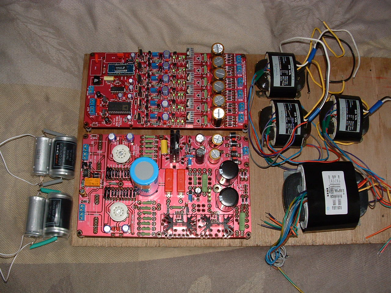

All most at the end !

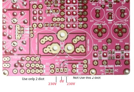

However i have a little experience of transformers .The r80/36 from diyclub i am not sure how to wire it in series .
I need 260v how do i wire 260v 23v 0 230v 260v ? all so.
I assume one set of 3.15 0 3.15 is not used .Do i join 2.5 to 3.15 and center to center ,with 3.15 wire and 2.5 wire not used.
I would be very greatful if anyone has same transformer could help please .
thank you regards john

Please see it for Centre tap! Use 260-230-0-230-260
And remove Cap one Centre board Iv stage, it is no need
Quanghao i understand but remove d9 and d11 correct or not ?.
What about heater wiring ? am i correct
yes!
The filament you can se the under PCb and make the sample SSHV!
It is easy for you??
