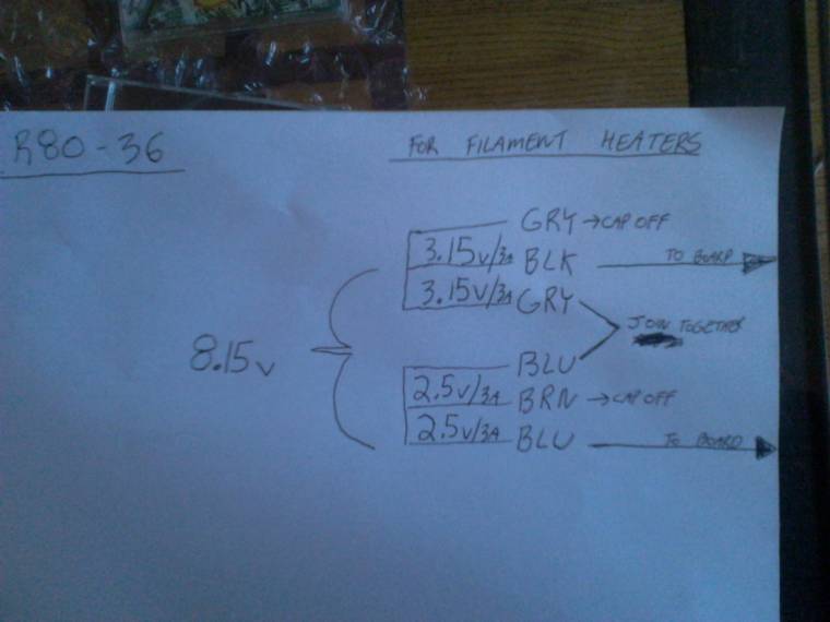

Well i wired the 260v supply only 2 green and 1 orange and my transformer got hotter and hotter giving off fumes ! result head hurts .Not sure what going wrong as for the heater wires i am confused which colours ,can someone confirm please

Just use one green (260v) and the orange(0v) for 260v. Do not use use two greens. Keep in mind the orange will be part of your ac voltage, so do not hook it to the ground (0) on the board, put it to the terminal marked AC. So a re-cap, one green to terminal marked AC, and the orange to the other terminal marked AC.
I would put a fuse on your primary side of your transformer for testing and for use, it will blow if you are shorting something out.

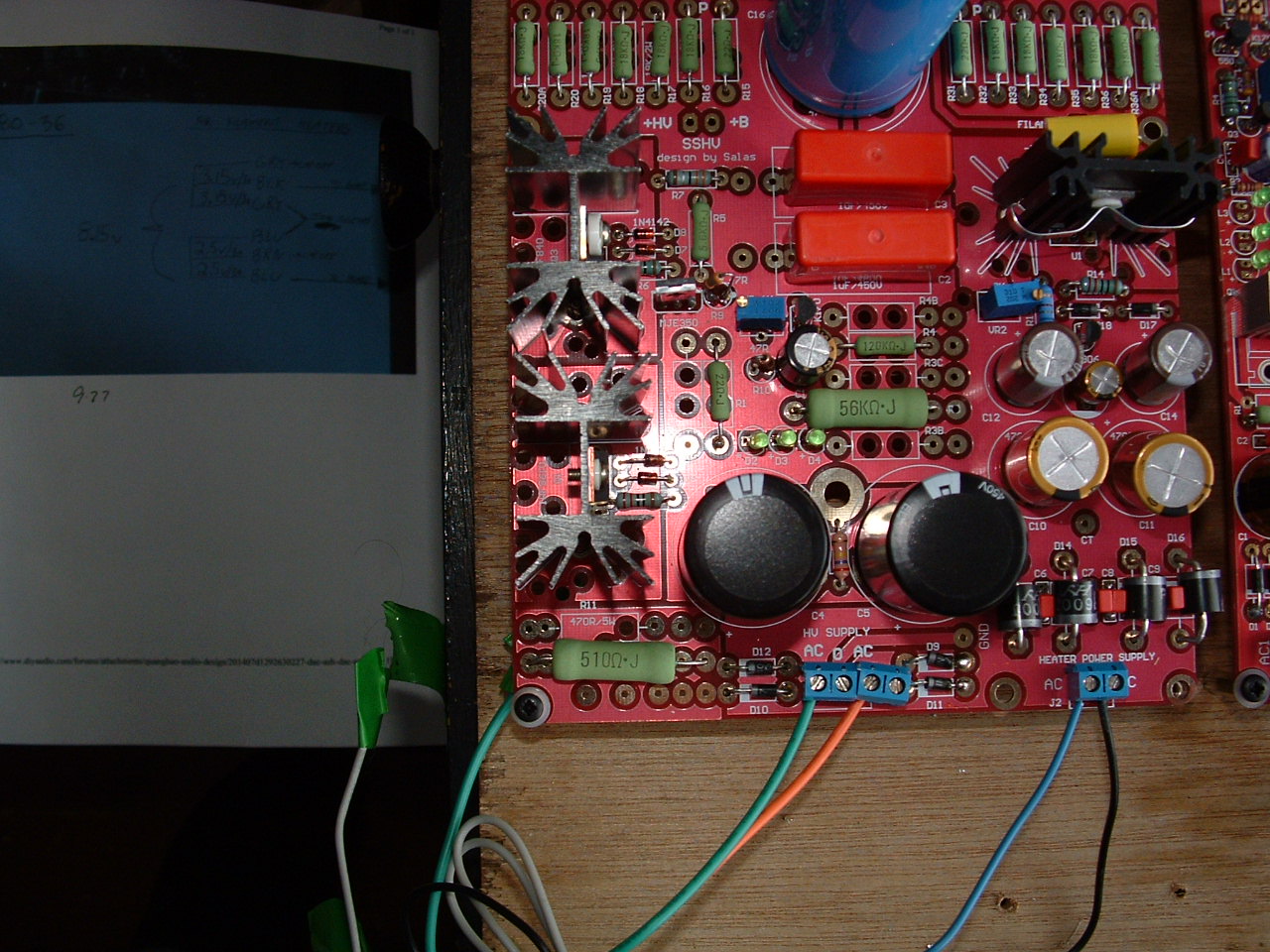

After power up i get now +300v at sshv,i wish there was some basic instructions .

K, here is a pic that may help you. This is how I wired my R80-36 for the heaters.(8.15v) Our mains are 120v here and this being a 115v/230v winding I end up with a voltage higher than what the numbers say on the tranny. (There is also the option of getting 8.8v as well)
Keep in Mind you have 2 gray wires and 2 blue wires to choose from. you have to switch them around until you get the right voltage. When you are using the wrong ones you will notice your voltage is less than it should be, it will subtract. You will sort it out. Test the voltages first with a DMM before connecting them to the board of course.
Are you using Resistors as a test load for the SSHV board before you put the tubes in? You should test the filament heater circuit and the HV circuit seperatley before you stick the tubes in. Let us know if you have not done so, and do not power up the board yet.

Yes i worked that out the other day but could not get enough volts no matter what combo i used
Ooops the tubes where in when i ajusted sshv to 300+ tubes are out now
Ok your pic was great i get 9.77volts
Ok pic shows all wires connected and tubes out ,i have not powered up or checked either sshv or heater ok

Let us do the heater circuit seperately from the HV circuit. So un-hook the HV supply from the board and cap off the wires for now.
If you have soldered a wire to connect the point marked +F to +6.3 undo it. (This jumper connects power from the heater power supply part of the circuit to the actual tube heaters and the relay) First you want to subsitute a load for the filament heaters, to check the circuit is working properly and adjust the voltage with the trim pot to 6.3v. When you have both the heating functioning and the HV circuit functioning you will connect +F to +6.3, and put the tubes in.
I am using the 6h30pi tubes. I connected 3, 1R2/10W resistors in series for a total of 3.6 ohms. Connect one end of the resistors to +F and the other to the point marked GND, on the tube side of the R32 resistor. This will substitute a load for testing. power it up and adjust the voltage to 6.3v. Be careful your load resistors may get hot, and be careful your LT1084 and heatsink may overheat. ( you mentioned your supply voltage was over 9v, check it again with the load, because it may be to high, the LT1084 will get very hot). Power it down and let it cool if things get hot between tests if you have to.
