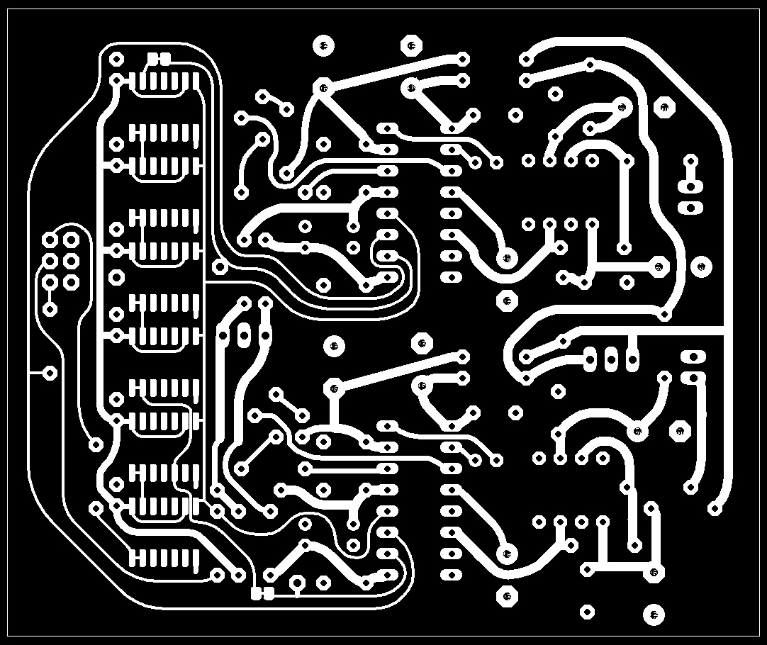

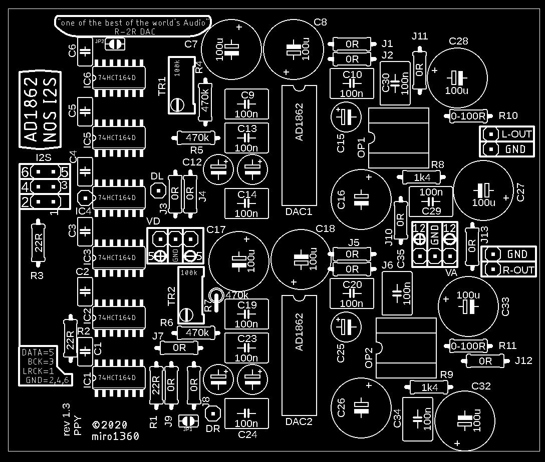

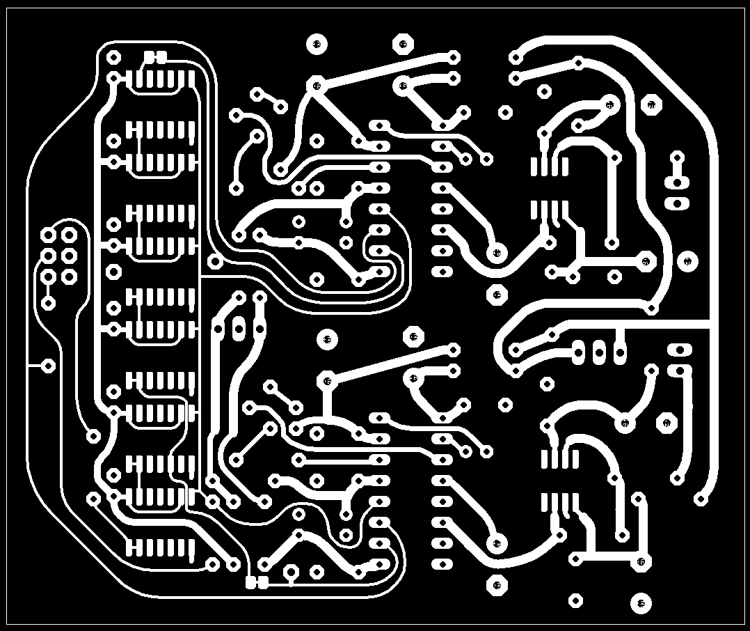

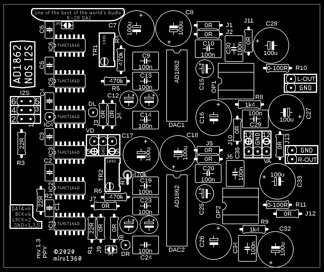

I looked at it. To get a real benefit from smd opamp on the pcb will mean no signal traces underneath this opamp ... and this is not real together with DIL package. It is either one or the another. So we could have one more version with smd opamp alone 😀

If you did offer an alternative board with SMD opamp, I would have it fabricated. I’ve tried enough opamps with your original layout to feel comfortable with a direct soldered SOIC8 opamp.

Yes, very good, you can order boards))
perhaps there will be no mistake

Check it three times before ordering 😀

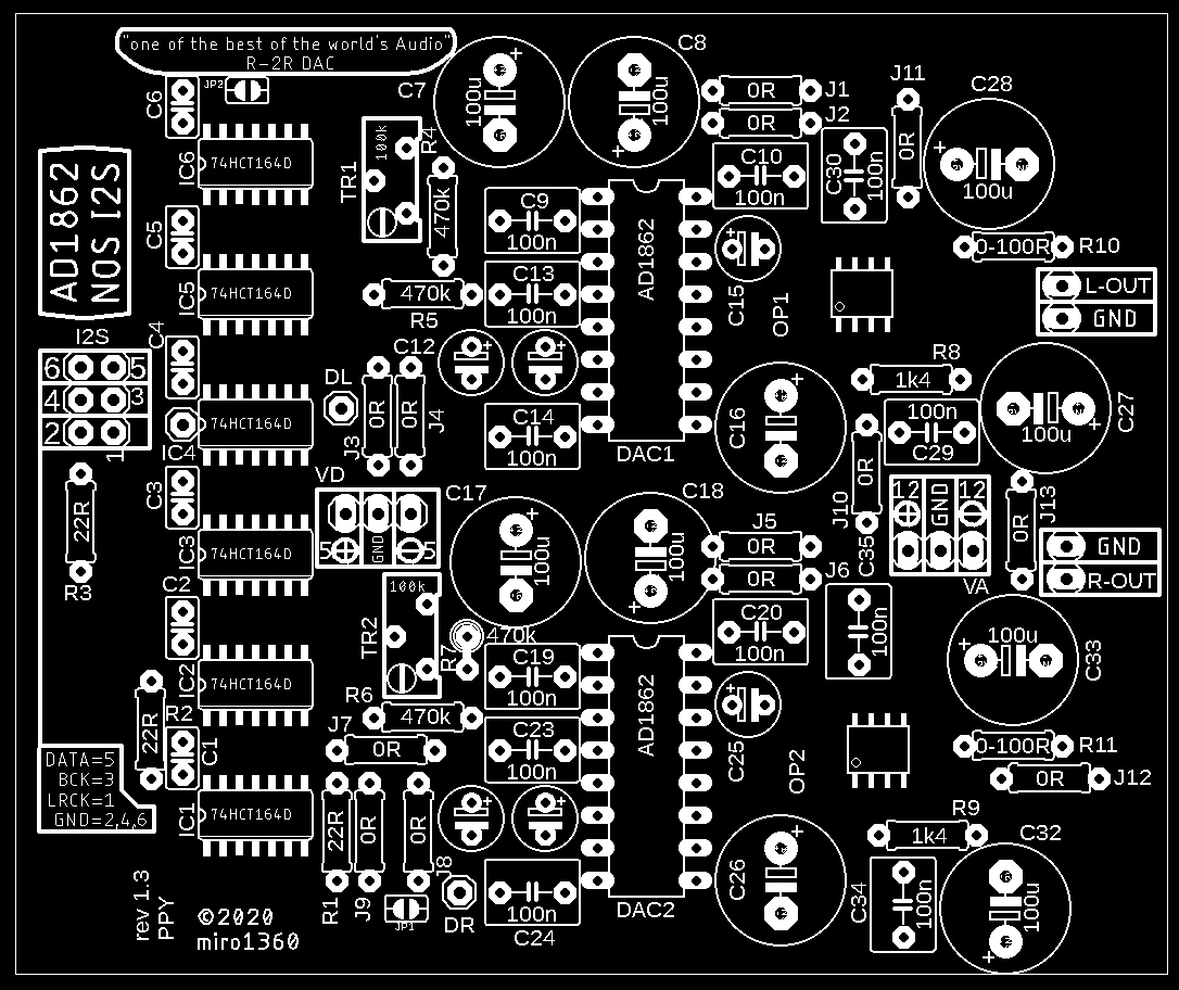

The only thing in the table is that the PIN designations in the plate are not changed, it can mislead people).
GND is now 531 pins and 642 is data-bck-lrck
Opamp legs 2,3,4,6 and 7 all seem to be going to their proper destinations.
Gerbers are downloaded and ready to go in my next pcb order 😀
Thank you Miro!!

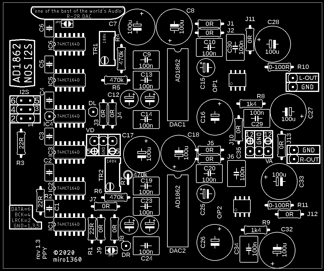

Ps: I also noticed a labeling error for the I2S inputs.
GND is now 1,3,5
LRCK = 2
BCK = 4
DATA = 6
Good eyes Traktorist3d 😉

You are right guys, here is the label correction 🙂
opamp DIL08: diyAudio_AD1862_DAC_v1.3_pad_PPY3_2021-01-14.zip
opamp SO08: diyAudio_AD1862_DAC_v1.3_pad_PPY3_SO08_2021-01-14.zip

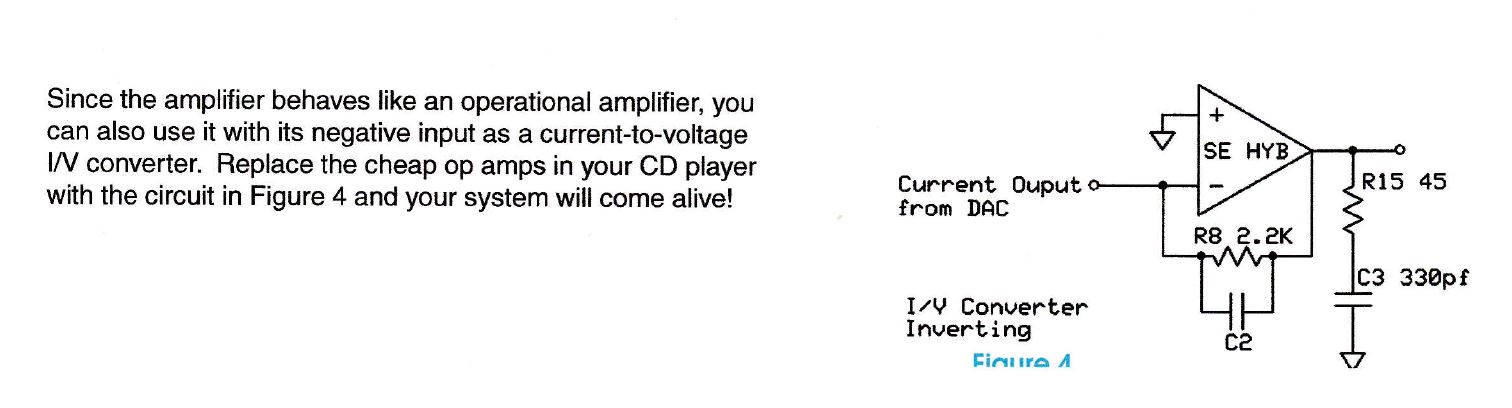

I've used this Borbely circuit before with great results. Its a very versatile circuit and I'll be configuring it like the attached diagram. There is a difficulty with this circuit though, the mosfets are a long time out of production and getting genuine parts is a bit of a challenge - fingers crossed that the ones I managed to obtain are genuine.
Of course, there are other options for I/V stages that could be used, I would quite like to try some of bisesik's transformers;
